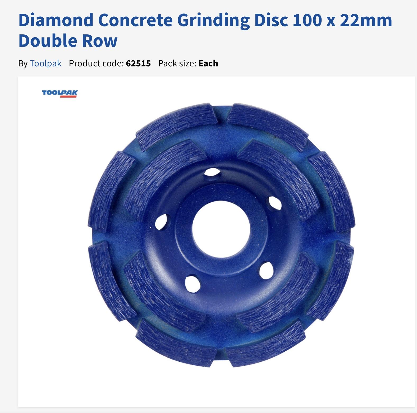

Cpd Posted March 1, 2021 Posted March 1, 2021 (edited) Not sure if you can get a grinder in there but if so something like this might do the job. you can get them in various sizes. Edited March 1, 2021 by Cpd 4

joe90 Posted March 2, 2021 Posted March 2, 2021 Those concrete grinding discs work very well (but loads of dust?).
jack Posted March 2, 2021 Posted March 2, 2021 19 minutes ago, joe90 said: Those concrete grinding discs work very well (but loads of dust?). Agreed. I've used both the diamond disc and cup types with a small grinder with great success on concrete (which is much harder than brick). I also shaped some brick slips to go over and around some flashings - the diamond disc went through them like butter. As you say, lots of dust, but a mask and eye protection should be used when doing this sort of thing anyway. @epsilonGreedy, unless there's an access issue, I'd have thought this would be a lot faster and likely leave a cleaner finish than using a multi-tool, although admittedly I've never used a multi-tool for this specific purpose. 1
epsilonGreedy Posted March 3, 2021 Author Posted March 3, 2021 21 hours ago, jack said: Agreed. I've used both the diamond disc and cup types with a small grinder with great success on concrete (which is much harder than brick). I also shaped some brick slips to go over and around some flashings - the diamond disc went through them like butter. Just logging my noddy experiences here to benefit others later... After a 24 hour delay searching for the grinder disk release pin spanner I ventured out to experiment with the 4" 1/2 240v angle grinder. The two disks supplied with the grinder were useless, the 6mm thick abrasive disk was slow work. The thin cutting disk went through one brick but half way through the second I realized the disk had lost 1/2" in diameter. I am heading out to my nearest Screwfix to buy a proper masonry segmented cutting disk, this Erbauer https://www.screwfix.com/p/erbauer-masonry-stone-segmented-diamond-cutting-blade-115-x-22-2mm/4896v at £6 is nearly 3 times cheaper than https://www.screwfix.com/p/marcrist-multi-material-diamond-segmented-blade-115-x-22-2mm/15915 Think I need some thick leather gloves as well.
jack Posted March 3, 2021 Posted March 3, 2021 4 minutes ago, epsilonGreedy said: I am heading out to my nearest Screwfix to buy a proper masonry segmented cutting disk, this Erbauer https://www.screwfix.com/p/erbauer-masonry-stone-segmented-diamond-cutting-blade-115-x-22-2mm/4896v at £6 is nearly 3 times cheaper than https://www.screwfix.com/p/marcrist-multi-material-diamond-segmented-blade-115-x-22-2mm/15915 Think I need some thick leather gloves as well. Yes, you need diamond blades. Ordinary grinding discs aren't suitable (might even be dangerous - I don't know). The ones you've posted look fine. Report back how you find them.
