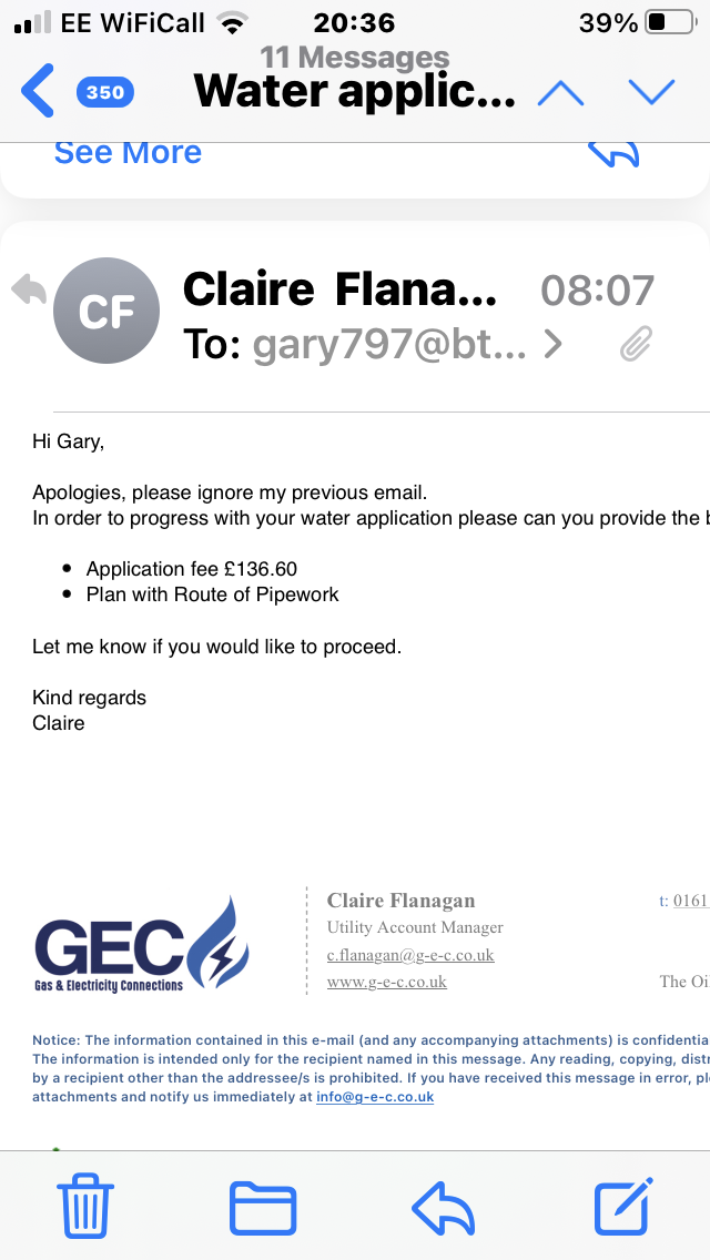

nod Posted March 1, 2021 Posted March 1, 2021 I received this today I can’t imagine paying a fee for a quote
Thorfun Posted March 1, 2021 Posted March 1, 2021 I had to pay £80 for my water application with Southern Water but I believe this also covers the survey. UKPN surveyed for free and didn't charge for a quote. Openreach charged a huge amount for a survey and then 6 months later said that they don't deal with what I want any more and told me to speak to the New Sites team. no offer of a refund for the survey or anything. ?.
