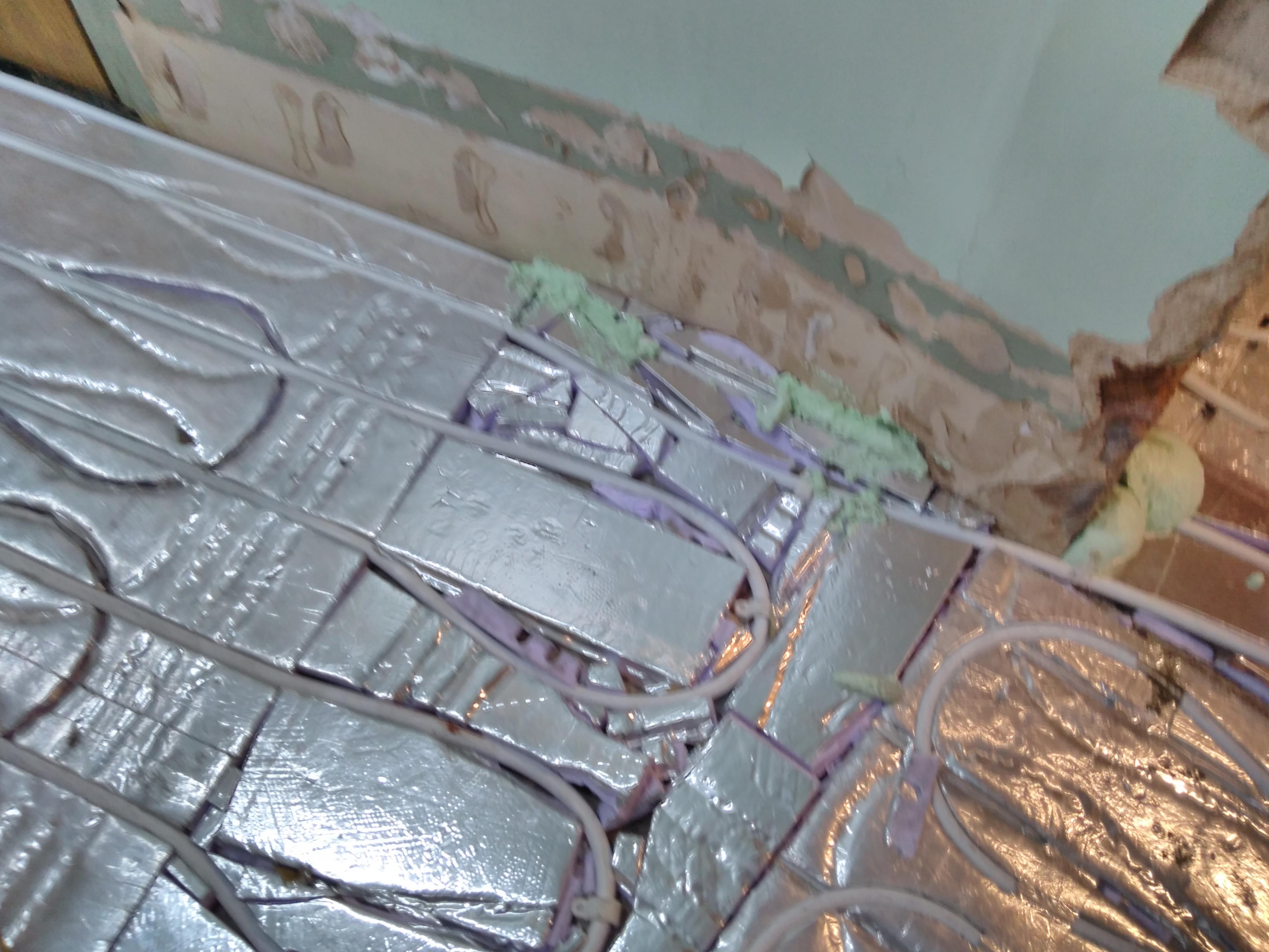

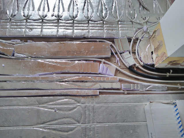

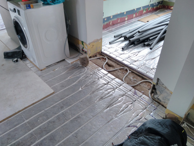

Hi,
We have just had a new underfloor heating system installed and would like some feedback on the quality of work.
We have a retrofit installation with insulation panels that has traces in it. Soon there should be a latex screed going down but the company doing the screed has said they cannot do anything until the insulation boards have been stuck down and the edges sealed so the boards don't float up.
When the board were put down no adhesive was used, is this normal?
Also the boards were not cut to the shape of the rooms and gaps were left. On the advise of the screed company the plumbers were asked to come back and fill them in as a huge amount of screed would be needed to fill them.
The guys came back and filled in the gaps with boards they cut in to random piece and put in but again did not fix down.
Finally they used some expanding foam around the edges but the board lifted due to not being stuck down.
Anyway I have included some pictures to let you see for yourselves.
Thanks

It’s not good, so cancel the screed until this is resolved.
how thick is the insulation?
is there any up the sides of the walls on the external walls.
have you looked at the manufacturer instructions for the system that’s installed? That will give you specific info to discuss with the ‘plumbers’
Ouch. That’s shocking.
The suppliers are usually able to do a route map when supplying with sections / pipe ways / crossovers all avoided etc so this should have been relatively neat and organised.
The boards absolutely must be bonded down, don’t even DREAM of pouring screed over that, it’ll be a train wreck.
Pipes will have to come up, boards up, and redo I’m afraid ?. There is no quick fix here.

Thank you all for your replies.
We had though it would be a case of redoing the job and it is a great help to have it confirmed.
@TonyT the board are about 25mm some are against the wall with no perimeter tape/insulation.
@NickfromwalesI am pretty sure they had a route map with them when they started the job.
I have had a good read up on what is involved and prepared to have a discussion with the plumbers as to what has to be done now.

What a waste of materials if it has to come up.  They normally start with a perimeter upstand of insulation that slows heat transfer to the walls and allows expansion in the screed.
I can see why it will be difficult to liquid screed.  Could they use a solid overlay like ScreedBoard 20?  It can be tiled and is a dry application that you could even DIY.
Taking a step back, has there been any heat loss calculations for the system design?
It looks like all the pipes are being laid on uninsulated bare floor, with a tiny slither of insulation squashed in around them.  I assume this is because of limited height to ceilings, and lack of desire to dig out the floor to reduce depths and do the job properly.
The result is going to be 50% of your heating bill going into the ground under your house rather than heating the house itself. Unless that's what you really want, you really should think about abandoning this and using something fit for purpose like a wall hung radiator.
(IMHO retrofits designed like this should be illegal under building regs)
