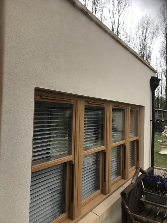

nod Posted February 14, 2021 Share Posted February 14, 2021 Pet hate I can’t see the point in making a house airtight and having Dozens of these things all over the house I pointed this out to BC While he agreed he did say that I must include them We hate the look of them and they are not airtight when closed We visited a friend who has almost finished his third self build The last one being 20 years ago While this one hasn’t been signed off yet He hasn’t any trickle vent for the above reasons Or MVRH Has anyone else omitted trickle vents? Link to comment Share on other sites More sharing options...

nod Posted February 14, 2021 Author Share Posted February 14, 2021 (edited) 16 minutes ago, ProDave said: No trickle vents, air tight house and MVHR. do you have something against mvhr? Your friend might have issues with no trickle vents and no mvhr, BC might not sign that off. My pet gripe is my three roof windows all have trickle vents that are never opened because of the ridiculous situation you have to pay a LOT MORE to get a roof window without a trickle vent. I object to paying more for them to NOT fit something. Nothing against MVR Just thought it my might be a way around trickle vents Thought I’d just get in first Perhaps I should have stated Bo other means of ventilation I think the question is Was my original BC incorrect in stating we must have trickle vent to ALL windows to comply with Building Regs Where in sat at the moment I’m looking at 16 trickle vents Excessive Edited February 14, 2021 by nod Link to comment Share on other sites More sharing options...

nod Posted February 14, 2021 Author Share Posted February 14, 2021 18 minutes ago, SimonD said: You don't need trickle vents, that's just the default assumption. I don't have trickle vents as there's no way I'm putting them in expensive 3g windows especially when some vents would sit 3.6 meters above floor level. You can simply install natural background wall vents and/or alternatively passive stack. It's all in the building regs. I got my acoustic cntrollable ones directly from Rytons - https://www.vents.co.uk/pdf/BROCH_Rytons_Background_Ventilators.pdf And yes, I'm not into MVHR as after my research I decided against it. We were in a similar position Spent 20k (supply only) on sash windows and spoiled them with trickle vents We also researched MVR and decided against it My wife is pretty set against it for the next one So isn’t looking likely for that one either Thanks for your reply 1 Link to comment Share on other sites More sharing options...
