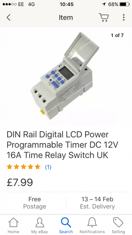

PeterW Posted February 8, 2017 Share Posted February 8, 2017 1 hour ago, JSHarris said: I've used mine in CU housings that aren't being used as CUs, because they are often the cheapest way of getting a DIN rail wiring box. No comment as to where I got my idea from ..!! Keeping the main switch to isolate the power to all the timers etc but the whole of the heat system including pumps etc uses around 900w when it's all switched on. That's protected by a 10a RCBO. The only one that is not part of that is the immersion circuit which is SSD operated so isolated and fitted in another box. Link to comment Share on other sites More sharing options...
Jeremy Harris Posted February 8, 2017 Share Posted February 8, 2017 I've just counted up and I have four CU housing that aren't used as CUs! There's the heating/cooling controls one you've probably seen, plus another in the water treatment building that has the borehole pump and filter controls, timer etc, plus two IP68 CUs that I converted into home made EVSEs (Electric Vehicle Supply Equipment). The two EVSEs have the DIY electronics that does all the control signalling between the car and the charge point, plus houses the DP contactor that isolates the charge lead if the car commands it or if the car charge plug latch is operated (makes sure the lead to the car is never live unless it's latched into the car and the car has sent the "power on" signal to the EVSE). Link to comment Share on other sites More sharing options...
Steptoe Posted February 9, 2017 Share Posted February 9, 2017 As an aside, If you have a CU being used as a CU, ie, main switch and MCB or RCBO feeding circuits, then you can't just fit a generic time clock or contactor in it, you are not allowed to mix and match. in real life, is it a problem,? Not that I can see of, Legally,? It's a massive NO. It's to do with a manufacturer only certifies their cu for use with their products, so in reality, unless it's been certified for use with anyone elses product then you are not permitted to fit it, it could be an insurance get out clause. And will be picked up on any future EICR by a competent person, In other words, if you fit a Hager CU you have to fit a Hager time clock/contactor, same with most other manufacturers. 2 Link to comment Share on other sites More sharing options...

Barney12 Posted February 9, 2017 Share Posted February 9, 2017 16 hours ago, joe90 said: Cool, does this not mean that if you want to override the timings you have to go to the CU ? I installed electric UFH fir a customer that had a programmer with everyday settings but an override button that allowed an instant 1hour "on now" facility which is what I fancy. I can't remember the make. I've been pondering this point (in the middle of the night hence the time of this post). I think my solution would be to locate the timers for the UFH and towel rads in a separate enclosue upstairs. In our case in the wardrobe back wall in the dressing room. This means local control is more accessible and also has the minor benefit of reducing cable runs. For our sparkies........ I assume some form of DIN rail enclosure fed by an RCD from the main CU is an acceptable solution under the regs? Would the remote DIN rail enclosure need local isolation (DP switch)? Link to comment Share on other sites More sharing options...
PeterW Posted February 9, 2017 Share Posted February 9, 2017 7 hours ago, Steptoe said: As an aside, If you have a CU being used as a CU, ie, main switch and MCB or RCBO feeding circuits, then you can't just fit a generic time clock or contactor in it, you are not allowed to mix and match. in real life, is it a problem,? Not that I can see of, Legally,? It's a massive NO. It's to do with a manufacturer only certifies their cu for use with their products, so in reality, unless it's been certified for use with anyone elses product then you are not permitted to fit it, it could be an insurance get out clause. And will be picked up on any future EICR by a competent person, In other words, if you fit a Hager CU you have to fit a Hager time clock/contactor, same with most other manufacturers. So what if I have a MEM CU that's not being used as a CU, just to house 4 time switches and a couple of relays and a contactor ..?? It has no MCB or RCBO in it, just control gear ..?? I'm also assuming it doesn't have to be metal clad either ..?, Link to comment Share on other sites More sharing options...
Nickfromwales Posted February 9, 2017 Share Posted February 9, 2017 After the CU it simply becomes 'fixed equipment'. Ideally it should have local DP isolation ( 20a DP switch to the side ) for disconnection. Edit : Maybe an din mounted 80a isolator would tick that box? 1 Link to comment Share on other sites More sharing options...
Jeremy Harris Posted February 9, 2017 Share Posted February 9, 2017 2 minutes ago, PeterW said: So what if I have a MEM CU that's not being used as a CU, just to house 4 time switches and a couple of relays and a contactor ..?? It has no MCB or RCBO in it, just control gear ..?? I'm also assuming it doesn't have to be metal clad either ..?, First off, CUs do not need to be metal to meet Amendment 3, the new regs just say that they have to be made of fire resistant material. The manufacturers have decided to switch back to metal because it's the easy way out, so everyone is using metal CUs to meet the Amendment 3 requirement, but there are reinforced composites that meet the fire resistance requirements too, so I wouldn't be surprised to see compliant "plastic" boxes available before long. If a CU box is not being used as a CU, and just has a protected feed coming into it with the box just housing control gear, then that is fine, as far as I can see. I double checked this (admittedly under the last issue of BS7671, not the current one) when I did something similar and there was no problem at all doing this. Not only did our electrician sign it off, but the building inspector also had a good look at it, as he was interested in what I'd done. The problem only arises if you include primary circuit protection in the same box and rail as other control gear. Link to comment Share on other sites More sharing options...
ProDave Posted February 9, 2017 Share Posted February 9, 2017 The new Amd 3 rules also cover "switchgear" enclosures. I am sure your box with timers would be classed as such. But of course you installed them before 1st December 2015 didn't you? Re UFH upstairs. fit a dummy thermostat on the wall, have your completion certificate done in summer, and nobody will ever know there is no upstairs UFH 1 Link to comment Share on other sites More sharing options...
Jeremy Harris Posted February 9, 2017 Share Posted February 9, 2017 (edited) 23 minutes ago, ProDave said: The new Amd 3 rules also cover "switchgear" enclosures. I am sure your box with timers would be classed as such. But of course you installed them before 1st December 2015 didn't you? Re UFH upstairs. fit a dummy thermostat on the wall, have your completion certificate done in summer, and nobody will ever know there is no upstairs UFH Thanks Dave, I only have a copy of Amend. 2 here, so wasn't sure. In my case the installation certificate was all signed off in 2014, well before there was a hint of the "fire resistant box" requirements. The funny thing is that CUs were very commonly made of metal years ago, in fact the one in our old house is, so we're just reverting back, really. I can fully understand why the fire resistant materials reg has been made, too. With CUs now full of RCDs, MCBs and/or RCBOs, plus the higher peak electrical demands imposed by a lot of modern kit, there has to be a greater potential for over-heating than there was. I poked my thermal camera at our all RCBO CU and it's definitely warmer than the surroundings by a couple of degrees. Not enough to be noticeable, but enough to show on a thermal image. There were no faults anywhere, I checked out of concern when I found out it was slightly warmer than the wall behind it, it's just the very even heat build up from all the RCBOs, as they do seem to consume a tiny bit of power all the time. I did the same exercise on our old metal wired fuse CU and it's at ambient temperature, not even half a deg warmer than its surroundings. Edited February 9, 2017 by JSHarris Link to comment Share on other sites More sharing options...
Steptoe Posted February 9, 2017 Share Posted February 9, 2017 5 hours ago, PeterW said: So what if I have a MEM CU that's not being used as a CU, just to house 4 time switches and a couple of relays and a contactor ..?? It has no MCB or RCBO in it, just control gear ..?? I'm also assuming it doesn't have to be metal clad either ..?, If it only houses control gear then its no longer a CU, As @Nickfromwales points out, its now merely a din rail enclosure, You wouldn't necessarily need direct isolation , but would need to label it up as having 2 sources of energy, ie, the control signal, and the power supply, so requires isolation at 2 points, or at the main switch. Whichever is applicable, If you want to use one switch to only isolate the enclosure it would require enough poles to isolate the control cables and the supply cables. Link to comment Share on other sites More sharing options...
