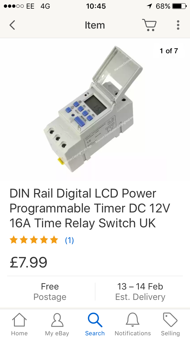

Barney12 Posted February 8, 2017 Share Posted February 8, 2017 1 hour ago, PeterW said: So I've got an 18 way consumer unit that will have in it all of the time switches and thermostats for : - eUFH / TRail bathroom - eUFH / TRail ensuite - Immersion timer - wUFH pump timer - wUFH temp controller Means that on the wall outside the bathroom there is just an isolator for the towel rail and a simple thermostat for the floor. Towel rail elements are 300w PTC so self regulating, floors are either 200w or 500w so total load is 1.3kw in total. @PeterW Do you have any details of the CU mounted time switches and thermostats you intend to use. I hate too much wall clutter Link to comment Share on other sites More sharing options...
PeterW Posted February 8, 2017 Share Posted February 8, 2017 21 minutes ago, Barney12 said: @PeterW Do you have any details of the CU mounted time switches and thermostats you intend to use. I hate too much wall clutter Using these generic ones from ebay 1 Link to comment Share on other sites More sharing options...
Jeremy Harris Posted February 8, 2017 Share Posted February 8, 2017 I have a couple of those ebay ones, one controlling my car charge point and one as part of the water filtration system. They work well, and fit neatly into a standard CU. Good value too, but I've no idea how reliable they may be in the longer term, as ours have only been in for around a year. Seem to keep time well enough though. 1 Link to comment Share on other sites More sharing options...
PeterW Posted February 8, 2017 Share Posted February 8, 2017 I figure if I'm only switching 1-2a they will last longer ..! Link to comment Share on other sites More sharing options...
Jeremy Harris Posted February 8, 2017 Share Posted February 8, 2017 (edited) 12 minutes ago, PeterW said: I figure if I'm only switching 1-2a they will last longer ..! Mine only switch a few mA, but one can carry around 15A for a few hours, the car charging point one. It's usually switching high current that does the contacts in, and in my case the actual switching in both cases is done by a DP contactor, rated at 40A. In the case of car charge point, even then the contactor doesn't switch much current, as the car controls the switching internally, based on the J1772 signalling protocol. The only time the contactor would operate under load would be if there was a fault. I bought a couple of spare timers, anyway, as I reckoned that at that price is wasn't going to break the bank to hold spares! Edited February 8, 2017 by JSHarris Link to comment Share on other sites More sharing options...
