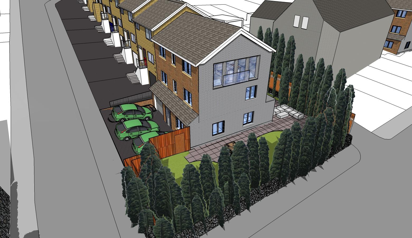

ICF_needing_brick_cladding Posted February 6, 2021 Share Posted February 6, 2021 Hi Folks, hope you're all well. I've recently received full planning permission to build a new three storey end of terrace house in the side garden of my existing house in Leeds. There's a decent amount of space so the new house will be about 50% larger (about 200m2) than the existing 3/4 bedroom house. It will be just 6 metres from a 40mph road though. I'm thinking of using ICF because it's a MMC and it's quite airtight etc but mainly because it's good with external noise. Obviously I'll need half decent windows too (please sing out if anyone has fitted windows in a house near a fairly busy with good acoustic results). My main concern with ICF is the expense and warranty fuss of brick slips (the front and rear elevations must be clad in brick to match the existing houses - totally understand that but sadly they are the ugliest bricks man has ever conceived and I'll likely have to spend a fortune making the new house look ugly too). Can anyone recommend an ICF system that works particularly well with brick slips and and particular brands of brick slips. I contacted the LABC warranty folks. At first glance, they don't think the Elastolith acrylic brick slips that I'd seen will be acceptable and generally favour a brick slip system with a cavity behind it - not good news as that'll increase the wall thickness and fuss. Anyway, any advice would be much appreciated. I love the idea of building the house in ICF but the cladding issues are really putting me off and I may have to revert to brick and block. Also wondering whether to go for brick and block on the ground floor and metal web joists on first and second floors to make fitting the MVHR easier. Any other suggestions? In a related issue, also unsure whether to go for underfloor heating on the ground floor only or all three floors. Currently trying to tweak the design with some fairly minor non-material amendments. I'm still going (thanks if you've made it this far) - I also have to have a phase 2 physical Coal Mining Risk Assessment and a physical Contaminated Land Survey (about £6k/granite worktops). It's in a high risk area for coal mining (as apparently 15% of the UK is) and there were three small Victorian terraced houses on the plot previously that were demolished to make way for the new, ugly, 1975 terrace here today. Any advice on that front would also be appreciated. Many thanks, Pete 20004 A-23B Site Plan As Proposed 17-Dec.pdf 20004 A-25B Elevations As Proposed Sheet 1 of 2 16-Dec.pdf 20004 A-24B Plans As Proposed 16-Dec.pdf Link to comment Share on other sites More sharing options...
ProDave Posted February 6, 2021 Share Posted February 6, 2021 Hi and welcome. My only suggestion is why do you want to join it to the other houses? Given the plot you have I would now be re submitting planning to make the new house detached from the rest of the row. Even if that makes your new build slightly smaller. 1 Link to comment Share on other sites More sharing options...
FM2015 Posted February 6, 2021 Share Posted February 6, 2021 Some will probably shoot me down on this but I'd say most EPS ICFs will work with products from https://www.matclad.co.uk/product-category/brick-slips/ They are not ugly! And can make slips from your choice of bricks. Not sure what that costs though. Link to comment Share on other sites More sharing options...
PeterW Posted February 6, 2021 Share Posted February 6, 2021 Cut slips come in at around 50p each plus the cost of the bricks and they sometimes don’t get two from each so they can get quite expensive. Plenty of manufacturers out there but when you add the cost of backing systems or grid system and adhesive and grout / pointing they can be quite an expensive solution. Link to comment Share on other sites More sharing options...
ICF_needing_brick_cladding Posted February 7, 2021 Author Share Posted February 7, 2021 Thanks everyone for your replies. The planners steered me towards another end of terrace - the pre-app was for a detached house. Also, if it was detached it'd need to be stone clad given the other houses at right angles to the terrace. Link to comment Share on other sites More sharing options...

Ferdinand Posted February 8, 2021 Share Posted February 8, 2021 I would also carefully consider that garden wall as an acoustic barrier. There is a lot that can be achieved looking eg at systems used for barriers between estates and dual carriageways, plus you have a little elevation to play with. Link to comment Share on other sites More sharing options...

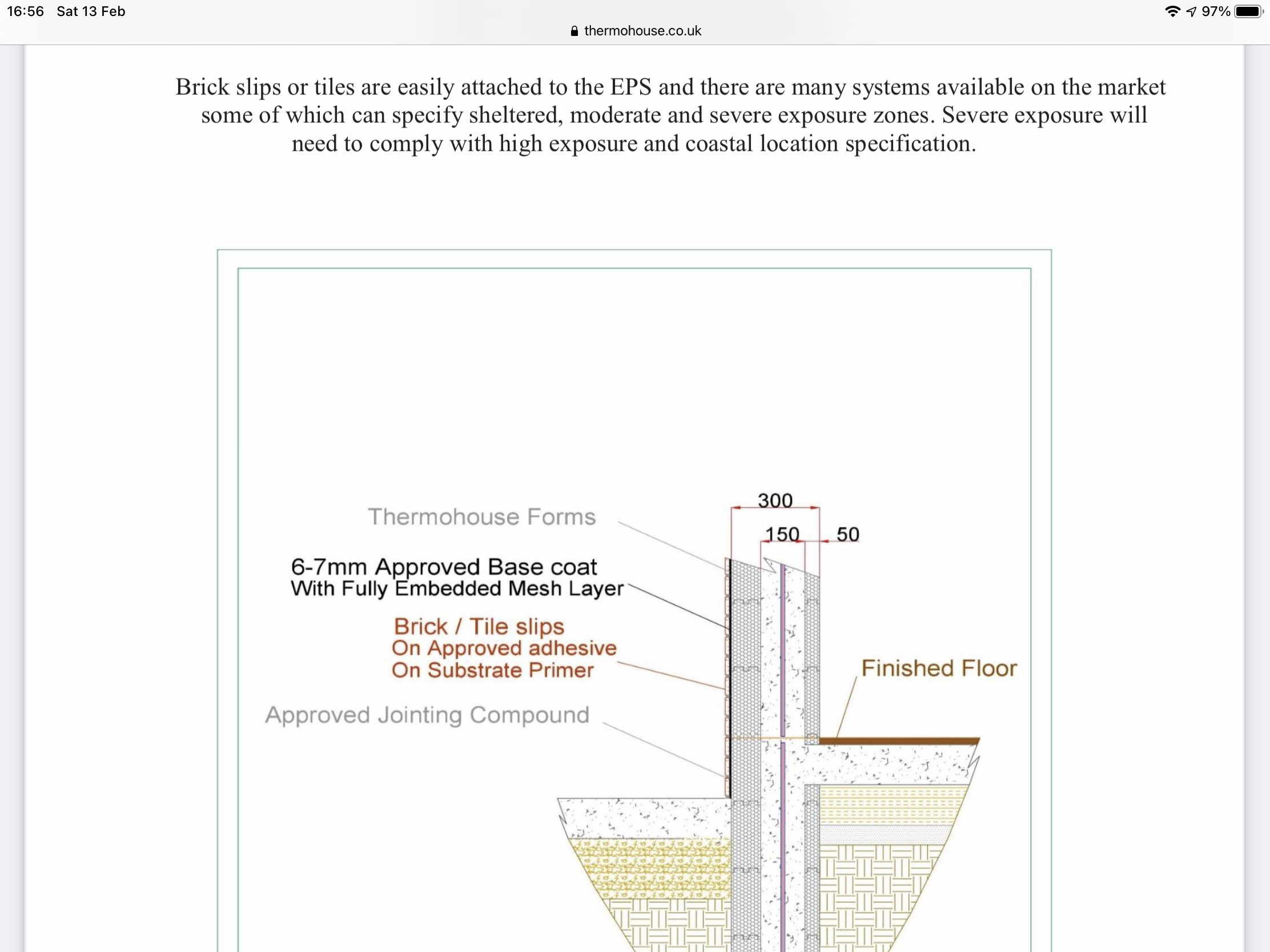

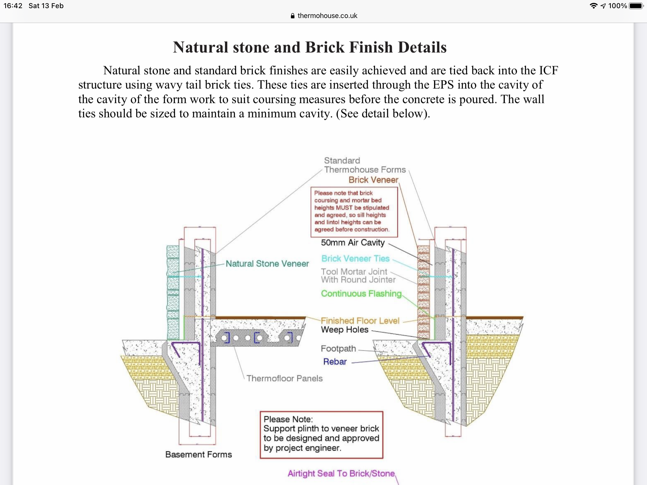

Nick Laslett Posted February 13, 2021 Share Posted February 13, 2021 (edited) What is the issue with standard bricks and ICF? I’m only familiar with the system I’m using, there are no cladding restrictions from what I can see. Thermohouse manual 2018 page 68 https://thermohouse.co.uk/wp-content/uploads/2018/07/Technical-Manual-2018.pdf I looked at the LABC Certificate and there is nothing there about cladding restrictions. LABC EWW178 Thermohouse https://thermohouse.co.uk/technical-spec/ Drawing detail for Standard brick and Stone cladding Edited February 13, 2021 by Nick Laslett Link to comment Share on other sites More sharing options...
Nick Laslett Posted February 13, 2021 Share Posted February 13, 2021 I’ve done no research on brick slips, but next page of technical manual doesn’t list any restrictions. Most ICF apartment blocks seem to be brick slips, more economical than standard bricks? Link to comment Share on other sites More sharing options...

ICF_needing_brick_cladding Posted February 14, 2021 Author Share Posted February 14, 2021 On 13/02/2021 at 16:58, Nick Laslett said: I’ve done no research on brick slips, but next page of technical manual doesn’t list any restrictions. Most ICF apartment blocks seem to be brick slips, more economical than standard bricks? Thanks for your reply Nick. Real bricks would add a fair bit of thickness to the house and as the gable with of the house is only 7.5m it's something I'd like to avoid. I do think that could be cheaper than brick slips though, as bonkers as it sounds. Cheers Link to comment Share on other sites More sharing options...

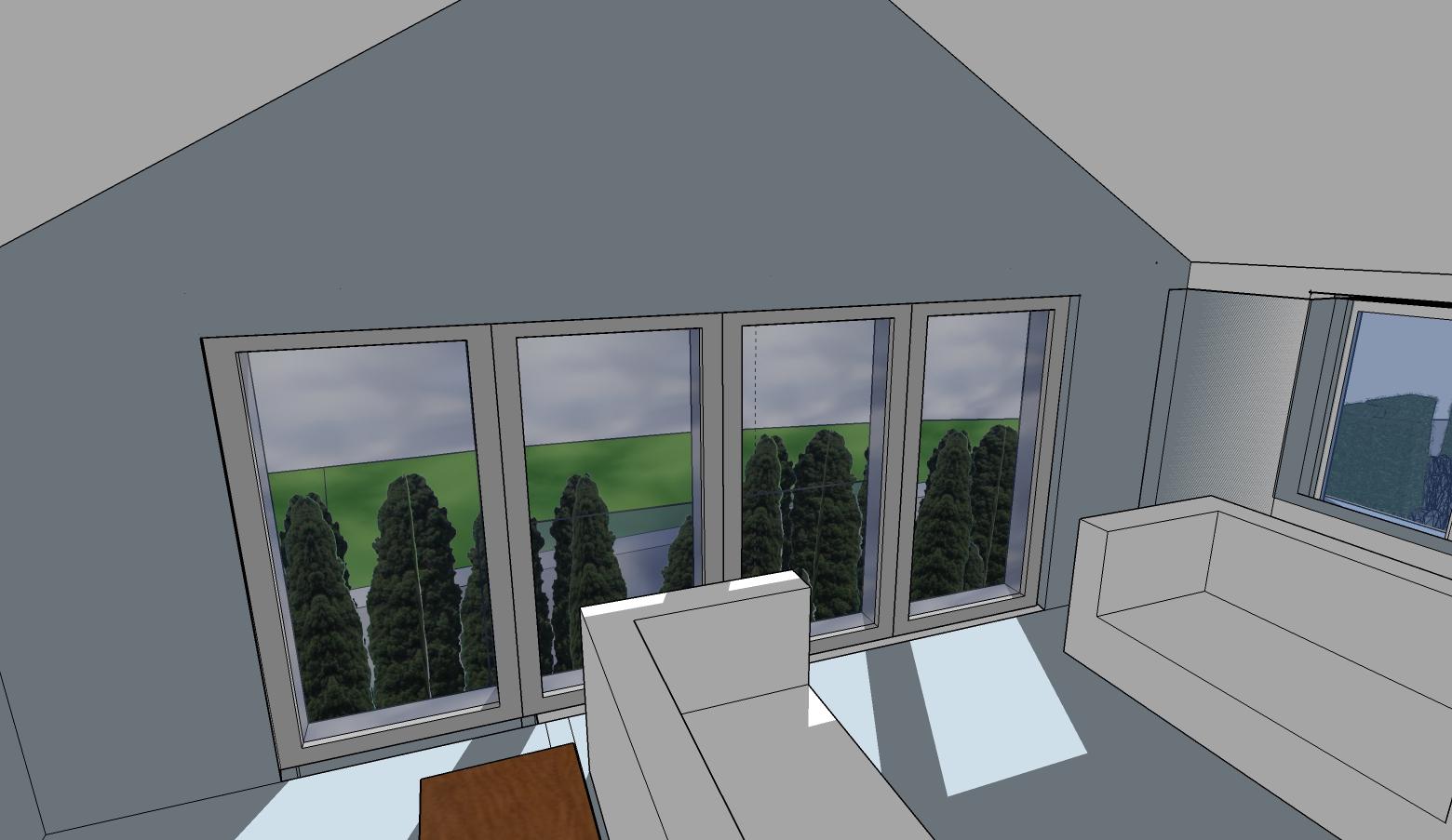

Iceverge Posted February 14, 2021 Share Posted February 14, 2021 1 hour ago, ICF_needing_brick_cladding said: Thanks for your reply @Bitpipe. I didn't realise there were modeling tools for such things - I'll investigate. Overheating wise, I'm thinking of having the top floor landing full height and having a velux to let the hot air escape. Same in the top floor lounge. I'd also hope the MVHR could help to cool the house in summer but not sure how effective this would be. No slab strategy yet. Was thinking beam and block due to the slope. Thanks again MVHR won't heat or cool your house as the air transfer is too low. Regarding overheating there's a simple formula somewhere relating to glazing vs floor area. I'll try to find it. Stack ventilation via your velux will work but you're better off not having the issue in the first place. Don't discount cavity walls. With 150mm full fill dritherm 32 or EPS beads you could achieve the same U value as your ICF. Less issues with finding specialist materials and experienced trades. Link to comment Share on other sites More sharing options...
Bitpipe Posted February 15, 2021 Share Posted February 15, 2021 11 hours ago, Iceverge said: MVHR won't heat or cool your house as the air transfer is too low. Regarding overheating there's a simple formula somewhere relating to glazing vs floor area. I'll try to find it. Stack ventilation via your velux will work but you're better off not having the issue in the first place. You will need do a SAP analysis by default but a PHPP analysis is a few hundred pounds if you're interested in approaching that standard. SAP will give you some indication and PHPP will give you a more accurate model. There is also a 'home grown' heat loss model floating around this forum that can help you estimate the space heating requirement. If your footprint / glazing area is now fixed (i.e. you have planning) then you only need to the hard work of defining the house once and then you can play with different wall and window U values. +1 to the MVHR - its needed to effectively ventilate an airtight structure without incurring heat loss but it's not effective at significantly heating or cooling. Consider making provision for a split air con (if you have PV, this effectively runs for free in summer). We have stack ventilation (Velux Integra in atrium) - works well to cool house in the evening during summer and then you can lock in the cool air for the following day. Keep in mind that in an airtight house, the stack needs a way for the air to get in at ground level so consider designing in an openable window that can provide this without creating a security issue. We didn't really consider it at design / build time but have found that opening a GF slider a few inches and locking shut is effective. Best would have been to have an openable window in our basement. Link to comment Share on other sites More sharing options...
