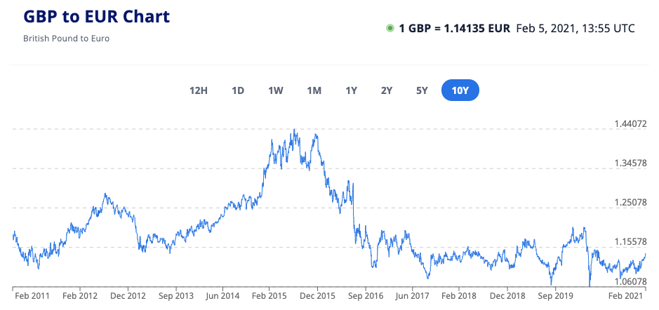

Bitpipe Posted February 5, 2021 Posted February 5, 2021 More anecdotal than evidential but a fair chunk of our build (frame, basement elements, bathroom fittings, internal doors, velux windows, stairs, furniture) was euro priced. We built from summer 2015 to summer 2016 so benefited from the 1.4 exchange rate pretty much to the end before it dropped post referendum. Looking at the historical exchange it looks like we were lucky in that respect. I've had a few trades back over the last years and their day rate has not changed appreciably.
