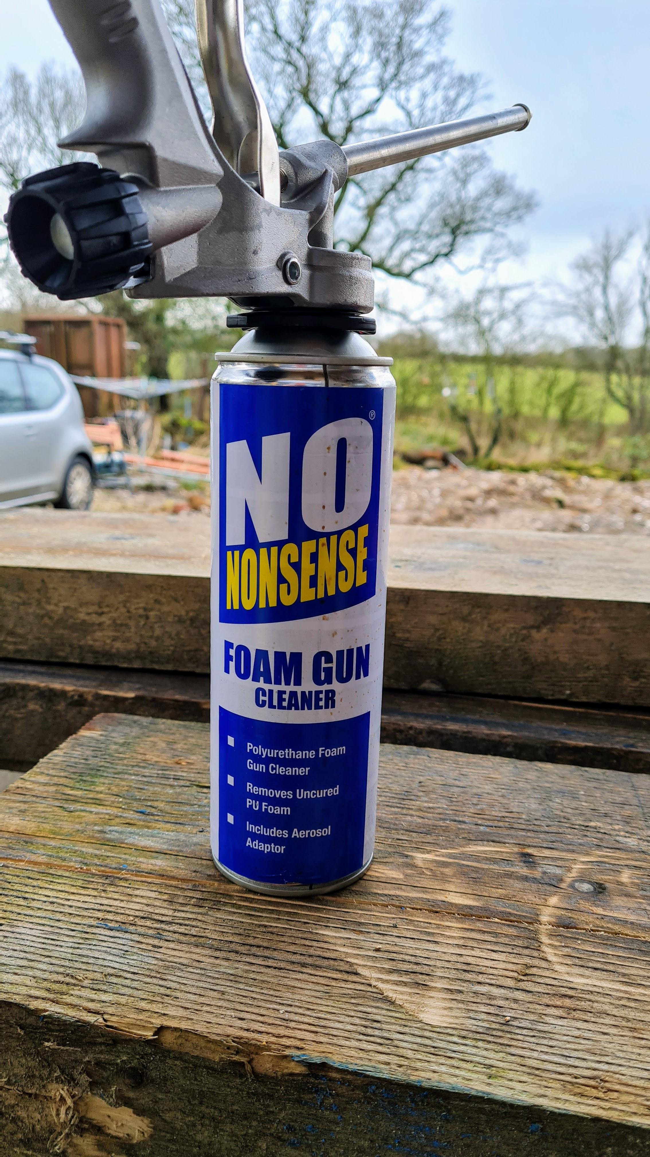

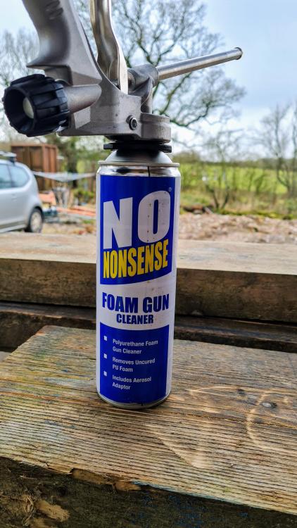

ToughButterCup Posted February 2, 2021 Posted February 2, 2021 Nonsense I say. Here's why. Checking carefully for cross threading, I screw a new tin of foam gun cleaner on a new gun. Close the valve tight. And put the assembly in the metal box. It has a tight-fitting lid. Two days later I open the lid. Had I been smoking I would have self-immolated on the spot. Almost all of the content had leeched out. An hour later, my clothes still reek of the volatile gas. I'm slightly cross. And grateful to have learned the lesson. No matter how much care is taken the union between gun and canister is not gas tight.

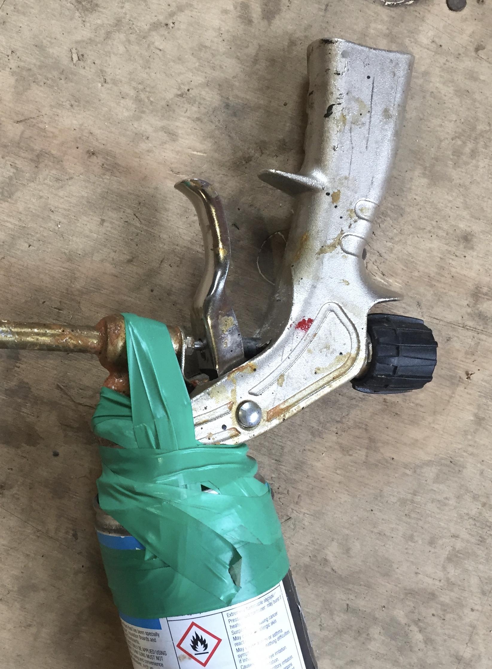

Cpd Posted February 2, 2021 Posted February 2, 2021 I only ever put the foam cleaner canister on when changing foam canisters just for a quick flush through before putting on a new canister so luckily not had this problem, my biggest grumble is with the manufacture of some brands of foam canister where the joint between the foam canister and the bit of plastic on top of the canister with the male thread on is shite and if you bump the gun then it separates and you end up with a right bloody mess.....
markc Posted February 2, 2021 Posted February 2, 2021 10 minutes ago, Cpd said: I only ever put the foam cleaner canister on when changing foam canisters just for a quick flush through before putting on a new canister so luckily not had this problem, my biggest grumble is with the manufacture of some brands of foam canister where the joint between the foam canister and the bit of plastic on top of the canister with the male thread on is shite and if you bump the gun then it separates and you end up with a right bloody mess..... Yup! and its bloody hard to get it out of your hair.

Onoff Posted February 2, 2021 Posted February 2, 2021 36 minutes ago, markc said: some brands of foam canister where the joint between the foam canister and the bit of plastic on top of the canister Had that with a Everbulid can of foam from Toolstation. Picked the gun up by the handle and the can snapped off. Hence I don't use that foam anymore! 1

PeterW Posted February 2, 2021 Posted February 2, 2021 1 hour ago, ToughButterCup said: Almost all of the content had leeched out. An hour later, my clothes still reek of the volatile gas. I'm slightly cross. And grateful to have learned the lesson. No matter how much care is taken the union between gun and canister is not gas tight. The canisters are, the valves are not as gas tight on the guns themselves and due to the volatility of the liquid and the gas, it will leach past the valve head if the pin is not perfectly clean.

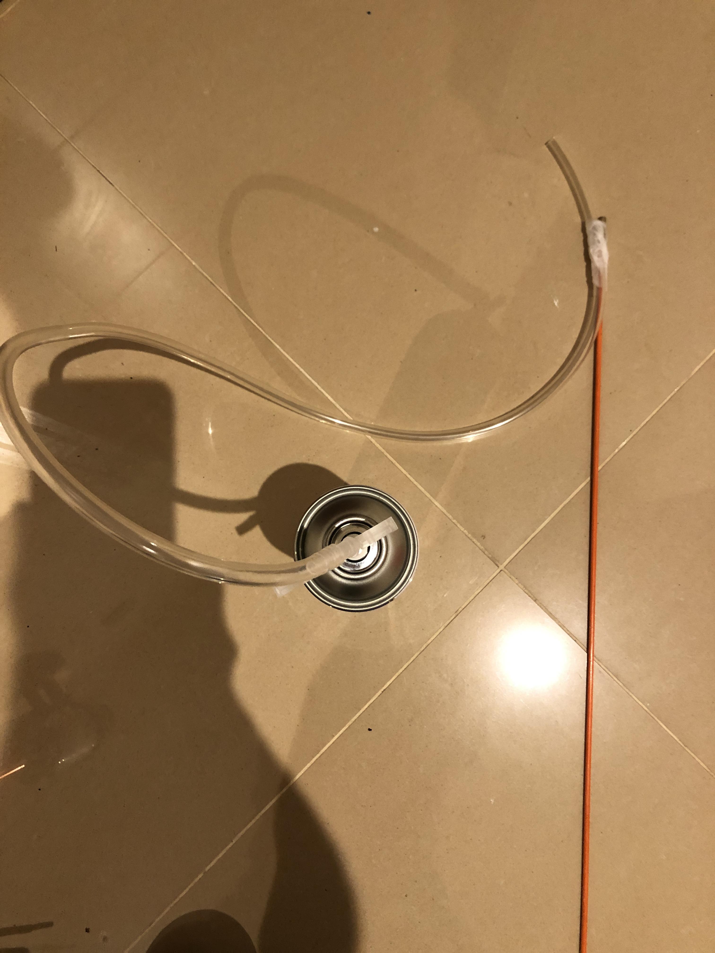

AliG Posted February 2, 2021 Posted February 2, 2021 (edited) I have been using quite a bit of this myself recently. Having had a couple of guns cleaned out and then seize up my conclusion, supported by reading up on the internet, is that you are better to leave the foam cannister attached and close the gun so that it is airtight. Also unless you are using a lot of the foam it might just be easier to use single use cans and not bother with the faff of cleaning guns. I also find the combination of gun plus 750ml can is often very hard to get into the spaces where I want to use foam. i had to knock this up to get foam into hard to reach spots. Edited February 2, 2021 by AliG

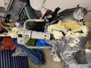

MrSniff Posted February 2, 2021 Posted February 2, 2021 Sometimes the foam can seal ain’t great either... almost new can, fortunately a bag at hand to keep it for later.
