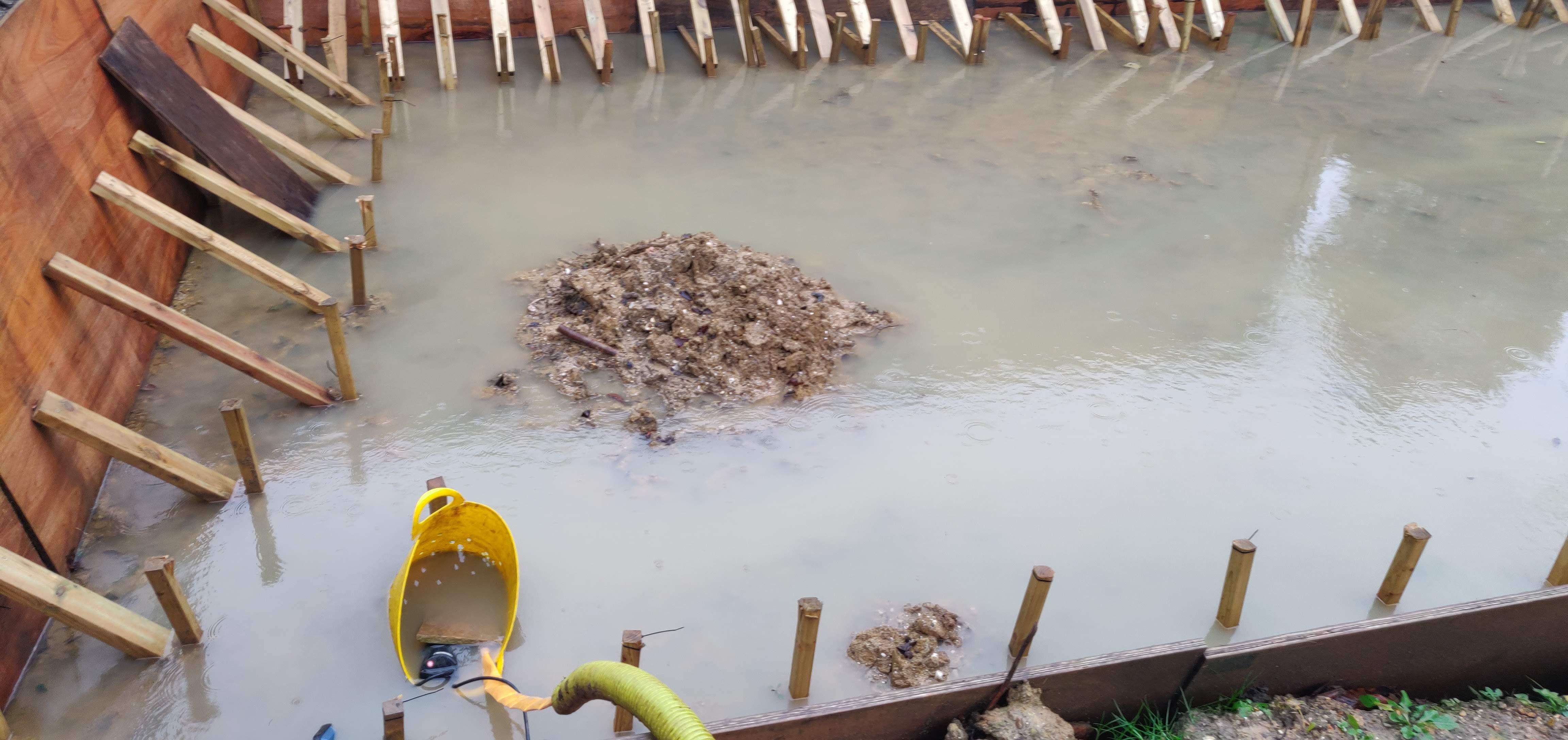

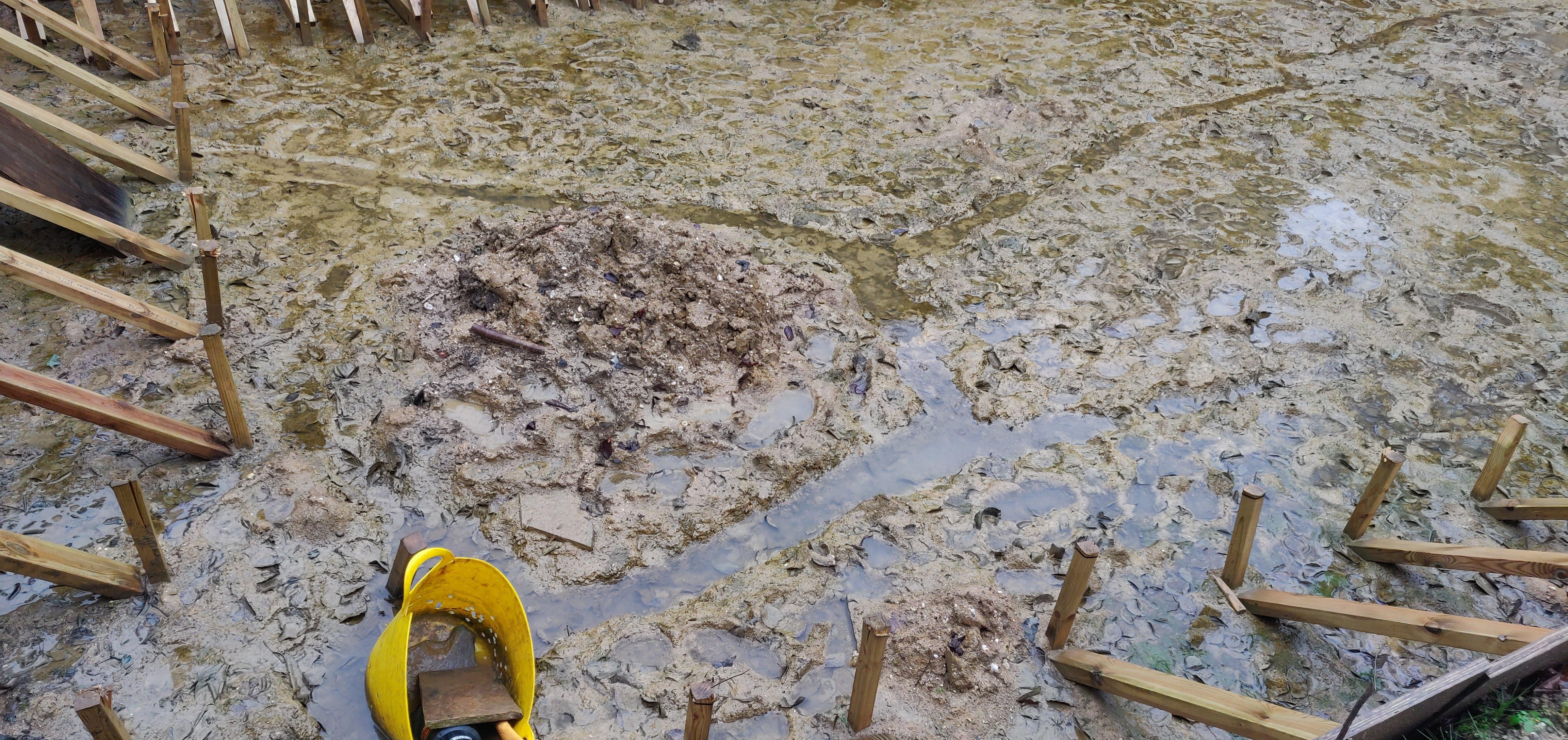

I am planning a single storey building which will sit on foundations around 1m below ground. I completed the excavation last summer and boarded up to start again this spring.
After a days rain the hole can contain 5-6 inches of water suggesting that alot of water is flowing in from my garden and neighbouring gardens.
Most of the research I have done on line suggests the use of a water permeable material for my back fill along with a french drain at the base of the foundation. Wouldnt this mean the garden water would then drain into the backfill around the building wall and foundations? That would be alot of water passing the wall and alot of pumping out.
It would seem more common sense to prevent the water getting around the below ground walls and foundations in the first place.
I have come across foam concrete which I thought may be able to serve the purpose of backfill and keeping the water away from the building.
Any clarification would be appreciated
Andy

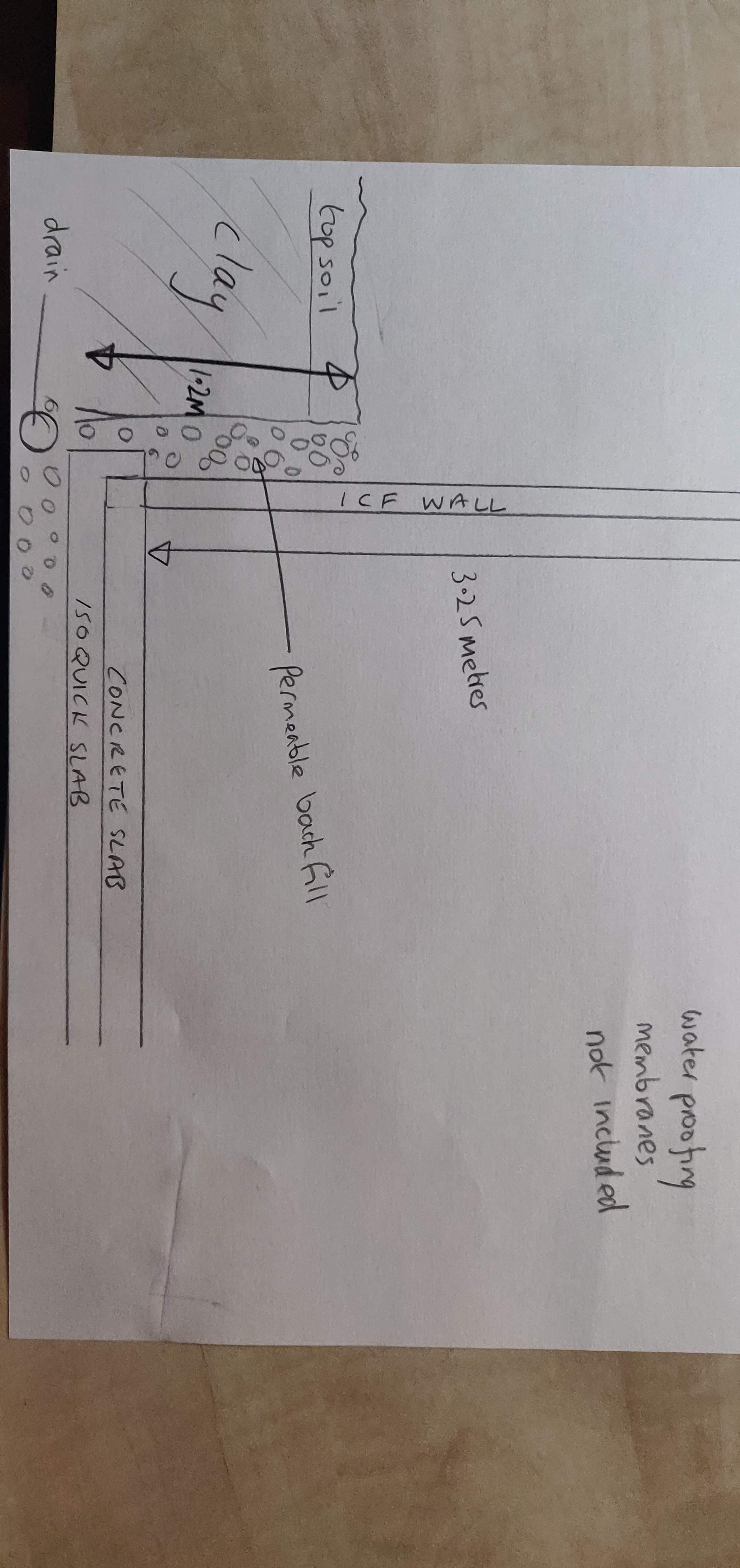

I’m not understanding what you have done, you need to explain with a rough scale drawing showing a section and the heights you have.
Not really sure why you are a metre into the ground.
Is this just a simple garden room, office garage, workshop, a few more details needed including usage so we can gauge insulation levels and position and build method for the walls.

Foundations sat in water is not a problem (I have a high water table), with our foundations I had to dig a small “sump” next to the foundations to enable a small pump to drain the water before the concrete was poured.

I was intending having a sump and pumping out but think it makes more sense to prevent or reduce the water draining from the garden to the foundations, therby reducing the likelihood of water penetrating the building at some point - I am planning on appropriate waterproofing of course.

It depends if the building itself, not just the foundations is below the water table. Our water table is high and when the trench was backfilled after the foundations were poured and brickwork started it was with perforated pipe in 50mm drainage stone and drained to a nearby ditch (French drain), if you’re  build is below the water table it’s a whole new ballgame, tanking etc.

The buildings walls will be retaining using steel reinforced concrete within ICF. I haven't decided whether to go for eps or woodcrete yet. I will be relying on a structural engineer to provide the exact specification of the wall.

The building and foundations are well above the water table. It just strikes me that my garden and surrrounding gardens are going to be dumping alot of water into the permeable back fill and put alot of demand on a sump pump. The foundation will be sat on clay so it wont drain away into the soil below the building.
Approx the first 1 foot of the soil is permeable top soil, below that is clay

In that case it’s not a problem, as I said, foundations sat in water can be quite normal and any DPC will stop wicking up into the building. You could always do like I did and run the drainage pipe into you’re drains, that’s where the rain from the roof goes!!!

Russell I am building a 6m*12m building under permited development rights at the bottom of my garden, close to neighbouring boundaries so I am limited to a height above ground of 2.5m. I have dug down in order to get more height into the building whilst keeping within permitted development.
I am planning on an ICF build sat on a isoquick insulated slab.
I have attached a sketch fyi
Any comments would be welcome

My plan is to do the same as you - run the sump pump into the drains

You are going to need a waterproofing system for those outer walls, this needs designing now with your icf supplier, and building regs designer.
Yes- I will be going overboard with the waterproofing plan - expect some future posts into the forum!

I also live in London and have this exact problem. Builder dug trenches in my garden for our extension’s foundations and also did some trial holes internally to check how low we could drop the floor of the existing house before we ran into the corbels, and both the trenches and the trial holes filled up with water. Structural engineer initially thought it was a high water table. I called a surveyor who inspected and assured me that was impossible, pointing out that I live halfway up a hill. It’s just London clay, lots of rainwater and not enough trees to drink it up.
Builder isn’t bothered about the water. He has a pump to suck it out so that he can get on with laying the foundations. But I’m still hoping February will be drier than January!
