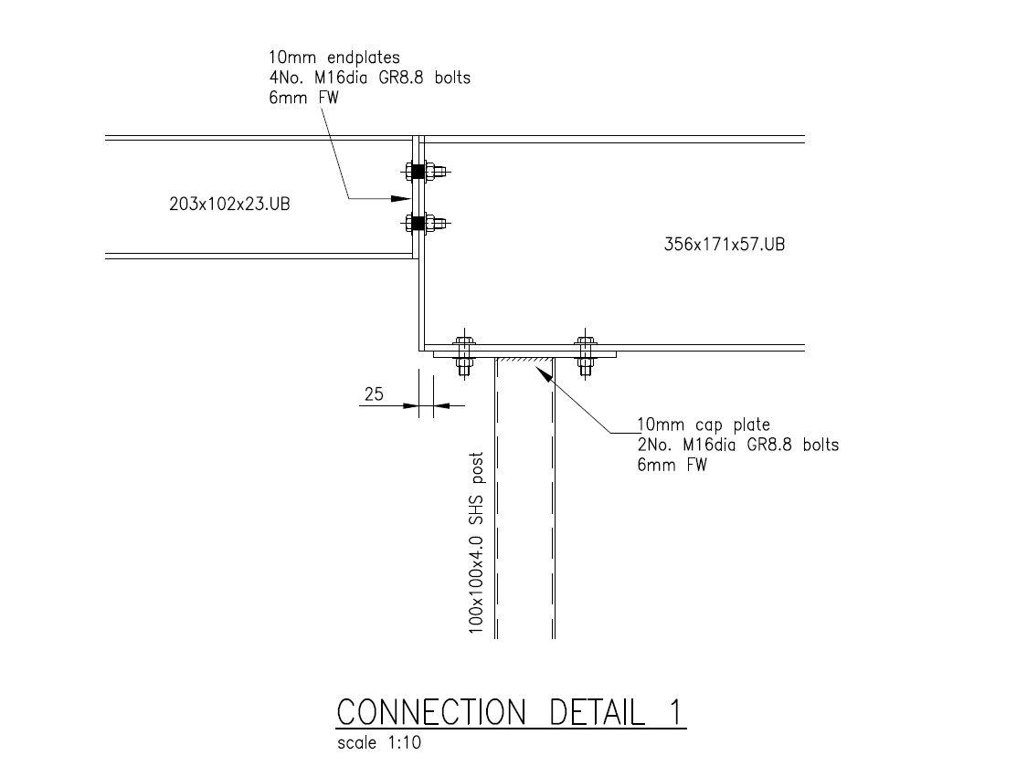

23 minutes ago, Temp said:
This has a sketch of a moment connection but I guess dimensions are important.
That`s an odd steel detail.
Think its missing a horizontal plate for the regular part of the connection?

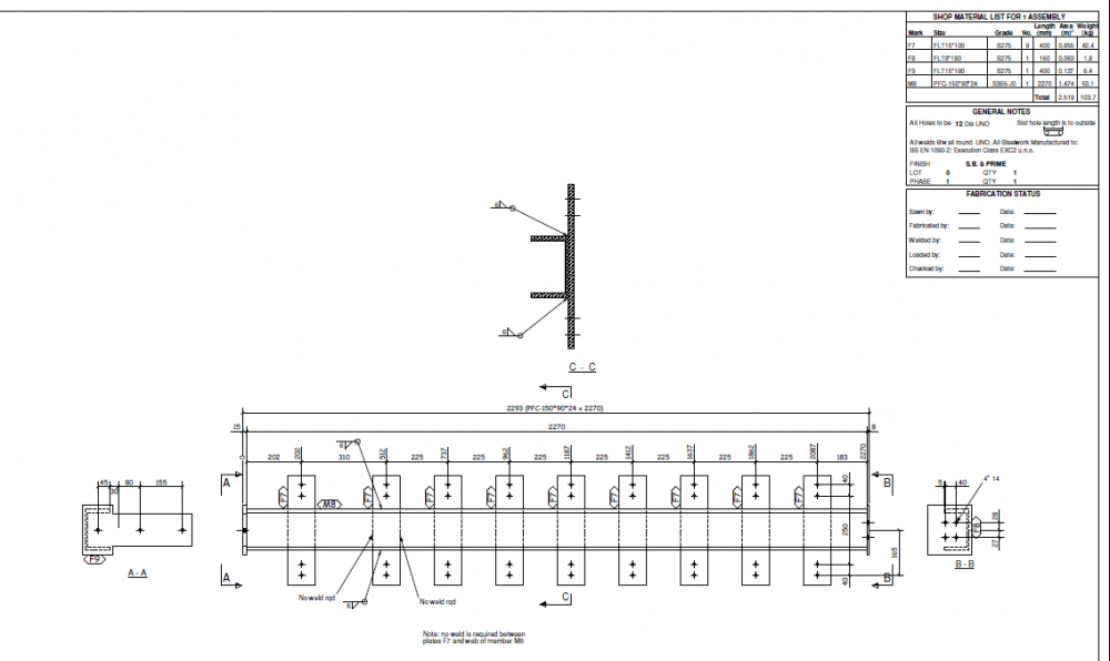

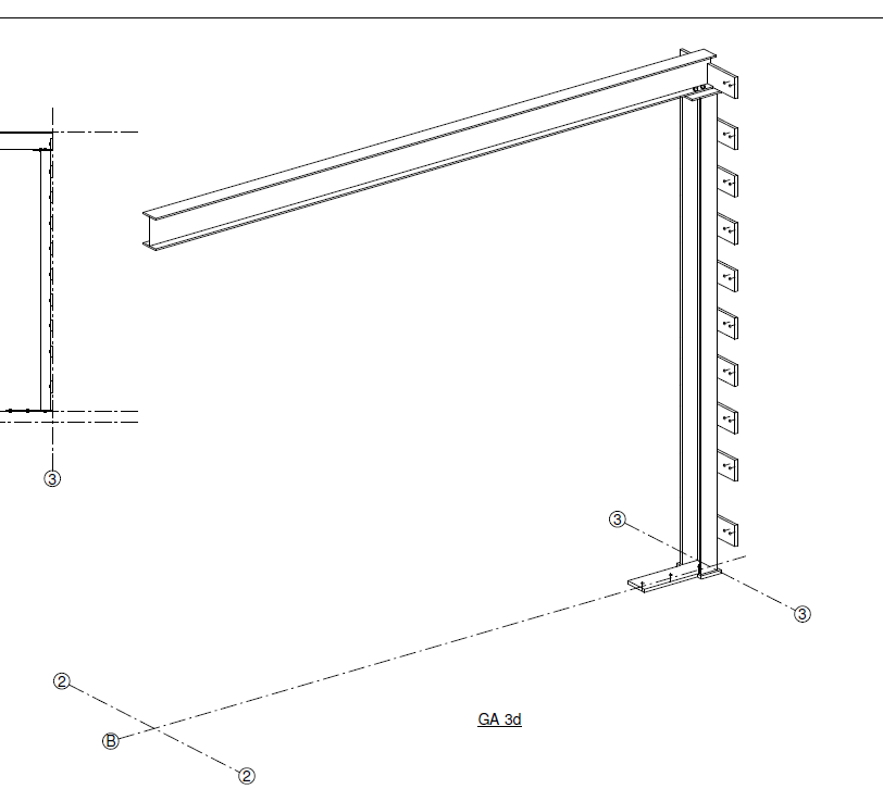

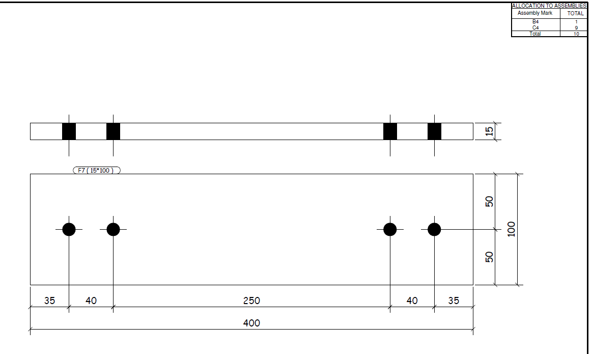

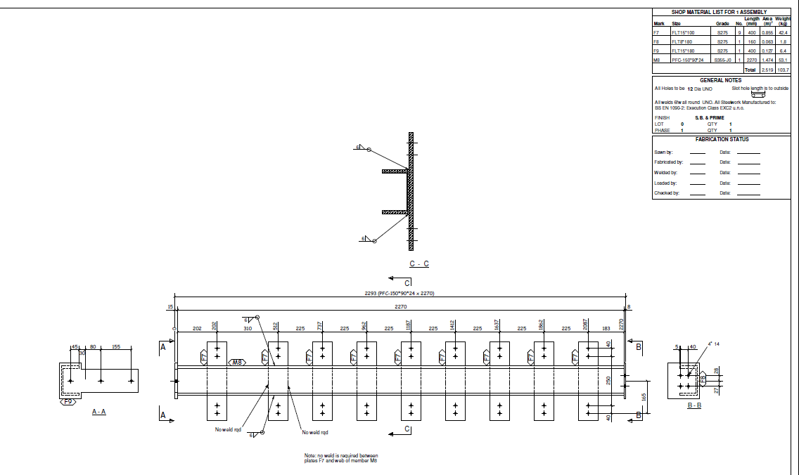

On larger jobs the SE will often contract to produce the steel schemework / call this a general arrangement. They calculate the various forces, size the members and provide drawings that show the beam/ columns, their sizes, grades etc and finish, paint or otherwise. They also provide a list or show the forces @SteveMackon the connections and what type of connection is required, "simple", "moment".. "wind moment connection"... there are others too.  This allows each fabricator who is tendering to design the connection that is most economic for them to produce. The connection design is often passed back the SE to ensure that it meets say the overall stability requirements of the structure.
What is advisable to do if you are an SE is to make sure that the fabricator can actually design and practically fabricate the connection as if not it can be embarrassing. The SE may just rough something out or take an educated guess and make some notes which you may not see. The key here is that you (SE) need to make this clear to the Client in your letter of engagement / brief that this is what you only are providing. This is particularly important when dealing with less experienced Clients.
Fabricators come in all shapes and sizes. Some have their own in house structural designers, some don't. It's quite common that the fabricator will come back to the SE and ask "can you do the connection design"  and we will pay you for it as part of our package. We sometimes call this getting novated to the contractor. Essentially, you go and work for the contractor for a while. There are pro's and cons to this.
There can be quite a lot of work in designing well balanced and cost effective connections. Once you have done this there can be significant amount more work to be done if you then go on to produce the fabrication drawings that go to the shop floor. Often for example each component plate / beam has its own drawing often called a shaft and plate drawing. You then have what are called assembly drawings. If you have a beam with a plate welded to each end this is an "assembly". All the assemblies are then bolted together to form the frame and you have GA (general arrangement) drawings for this. On bigger jobs and even small ones that big fabricators slip in as filler jobs you may also give them what is called an NC file, (numerical control file) this is actually a normal text file .txt that they can plug pretty much into their drilling and cutting line and so on.
But the approach I favour for small domestic works, say knocking down a wall with a beam and columns is to produce all the steel info that a small builder needs to price (tender) easily. They can see what they need to do and not have to worry too much other than check the site dimensions once things are opened up.. before fabrication. You may think this can delay the job but what you do is to book your production slot at the chosen fabricator and thus can deal with last minute minor changes, say a few mm in beam length etc.
The steel info is wrapped up in a package, zipped up in a zip file and all they need to do is send the zip file to the fabricators for pricing etc.
Below is a GA for a small job.. knocking down a wall with a wind post. Important notes are added so they don't get missed. I have screen shotted parts of the drawing. The fabrication package for this beam and column contains 8 drawings. Often the smaller fabricators buy in the plates / shafts so if you make it easy for them the price comes down and this offsets the SE cost.  All they need to do here is send the plate drawings to the plate supplier, shaft to another, get the components in, weld them up and paint or send to galvaniser.
Here is part of the assembly drawing for the column
And here is part of a plate drawing. The title boxes and a little info has been removed to try and avoid identification and so on.
