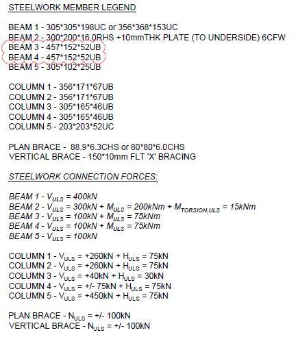

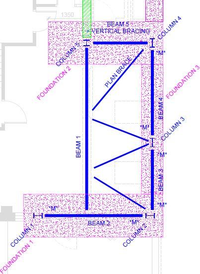

I've attached 2 files, 1 is the layout of the steel and the second is the list of steelwork to be used and forces for which the connections need to have designs.  I have an 80 page calcs document too in support of the design.
Some factors; house is 2 storey brick and block cavity with a loft conversion which is designed to put all the roof weight onto the gable block wall via steels in loft, so there is increased loading on the gable ends and thus can't use 2 lighter bolted together beams due to uneven load on brick/block skins.  Beam 1 is supporting ~80% of the gable wall length of the house.  Beam 2 takes out the corner of the house.
We live next to open fields and regularly get hit with 60mph+ winds with potential for a lot more if it's a bad storm, beams 1 & 2 are the walls facing the very open aspect.
Edited by SteveMack
I've also realised there's no dimensions to give a size to it.  Beam 1 is ~6.1M, Beam 2 is ~4M.  Beams 3&4 were split from 1 single beam to reduce the weight a little on that beam span hence column 3 being present.  Beam 3&4 are quite deep because they need to accomodate a support for an outer brickwork soldier course (The bottom plate has been missed off, he's aware of this, he has agreed to amend further on).  Extension is single story.

Based on what you have posted so far re section size, forces and so on I can sort of see how something like this may work with the wind bracing and so on, but you are going to need a good bit of space to form some of the (assuming bolted) connections, you need to look carefully; if there are window details, a limit on the floor depth and so on. This could be a problem?
What you have posted so far looks like the maximum forces and maybe the fabricator needs more info. Take column 2 supporting beams 2 & 3. Simplistically these beams have a bending force at the ends.. the moments - kNm. Beam 2 moment loads the column about it's "strong axis" and beam 3 loads the column about it's weaker axis. If you combine these forces with the torsional moment plus the vertical load (V) then the column strength capacity looks debatable to say the least.
What the SE may have done is to model beam 3 with a pinned connection at column 2 so it does not transfer a moment (axial load ~V) but at the other end (at column 3) modelled a fixed connection and provided this set of more onerous forces rather than the different forces at each end. This may partly explain the fabricator's response.
The connection at column 2 in particular is relatively complex and will take a good bit of thought to account for all the combinations of forces.  Looking at this I think it's likely more than a ten minute job to design a connection that will be as small as you can get it and thus maybe fit in to the space you have available? You could end up with some pretty big bolts, thick end plates on the box section, stiffeners etc, nearly get it to work then find you have a bolt clash or the sequencing of the works stuffs you in terms of the order you connect in the various beams.
This could be a communication issue but I would just ask the SE roughly what sort of connection and size and form they have in mind. Also ask if they can do the heavily loaded connections with "ordinary" bolts which a local builder can manage ok.  Or does the SE think some kind of tension control (HSFG) bolt may be required which requires more specialist knowledge and tools to install. Make it too complex and most small builders will back off or add a lot to the price.

This is the crux of the matter. I think I would have gone for two connected columns, each orientated for each portal frame - or as you say, not have a moment connected from B3 to C2 and rely on the C3/ C4 portal frame in the up/down direction.
There's something of an ongoing debate in the structural engineering world about whether steel frames in extensions can rely on the stability of the existing building (if enough walls remain) or whether they need to be independently stable. I have tended to use the existing building where possible...
