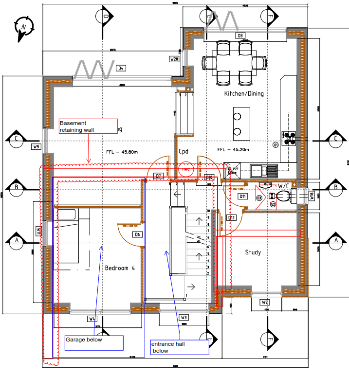

Moonshine Posted January 21, 2021 Posted January 21, 2021 (edited) This is probably a subject that has me and others going round in circles about the external wall construction. I have two choices really Masonary block cavity wall - 150mm fully filled Timber frame inner skin / masonry block external skin I started off going timber frame, but now am looking to go cavity block, though speaking to developers and builders they are mostly saying if build from scratch they would go timber frame inner skin. Timber frame has its advantages, in that it is a package of work that can get me pretty much water tight with one contractor and quickly, but there is a cost to that. The block may be cheaper but there would be more to manage, my logic in using block is that the house has a cavity filled (concrete) block retaining wall basement, so that trade is on site so may as well carry on. What are peoples thoughts and why they went a particular way. Edited January 21, 2021 by Moonshine

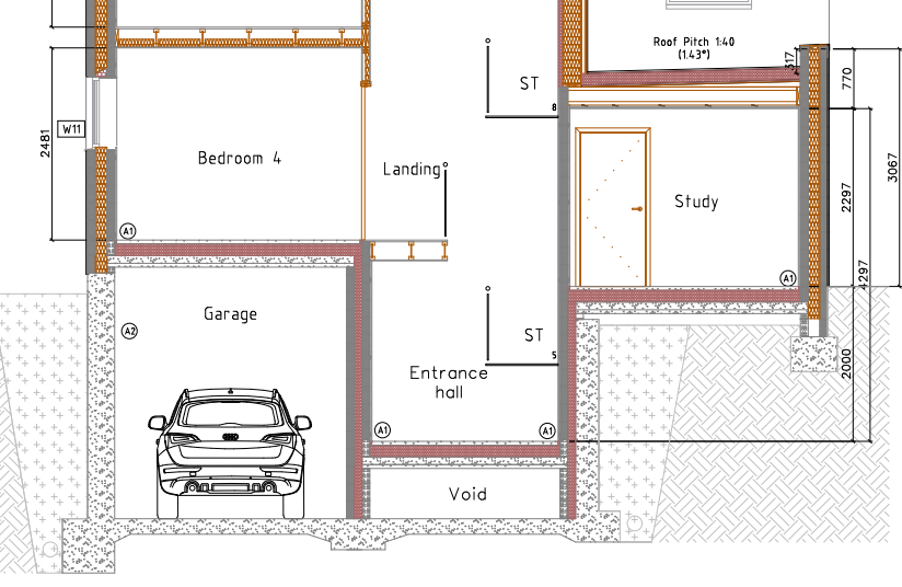

Mr Punter Posted January 21, 2021 Posted January 21, 2021 If there is room for a crane or telehandler, timber frame will get you in the dry quicker. I have done timber frame over a concrete (ICF) basement. We used timber joists for the ground floor structure. You will need to work out where your insulation is going and carefully plan the junction between the 2 systems. Make sure the join between them is at least 150mm above ground level.

Moonshine Posted January 21, 2021 Author Posted January 21, 2021 13 minutes ago, Mr Punter said: If there is room for a crane or telehandler, timber frame will get you in the dry quicker. I have done timber frame over a concrete (ICF) basement. We used timber joists for the ground floor structure. You will need to work out where your insulation is going and carefully plan the junction between the 2 systems. Make sure the join between them is at least 150mm above ground level. Thanks, the basement doesn't cover the whole footprint and most of the basement is garage, so the ground floor in this case is going to be traditional block and beam sat on traditional footings and onto of the cavity filled basement wall. I would look to do something like this at the base of the external walls / on top of retaining walls
Bitpipe Posted January 21, 2021 Posted January 21, 2021 We did our basement in shuttered concrete and put a timber frame on top. We copied the passive slab construction that the timber frame company usually provided. Also steel frame & timber joists for GF, although a concrete lid may have been cheaper, a web joist floor made it easy to install UFH and services (lighting, MVHR etc). Was all pretty straightforward.

Trw144 Posted January 21, 2021 Posted January 21, 2021 (edited) 3 hours ago, Bitpipe said: We did our basement in shuttered concrete and put a timber frame on top. We copied the passive slab construction that the timber frame company usually provided. Also steel frame & timber joists for GF, although a concrete lid may have been cheaper, a web joist floor made it easy to install UFH and services (lighting, MVHR etc). Was all pretty straightforward. This is the choice we currently have. A lower ground floor needing to be block/concrete as its built into a bank, and either continue in block for the next two stories, or put a timber fame on. Having done timber frame for the current build, I do like the speed of build, ease of obtaining high insulation and air tightness. for me. The one downside of TF for me has been sound insulation - the one corner of the house nearest the road does pick up more noise (fortunately it'sthe spare bedroom). PS. I forgot how much I enjoy this forum for knowledge building and thought provoking Edited January 21, 2021 by Trw144
