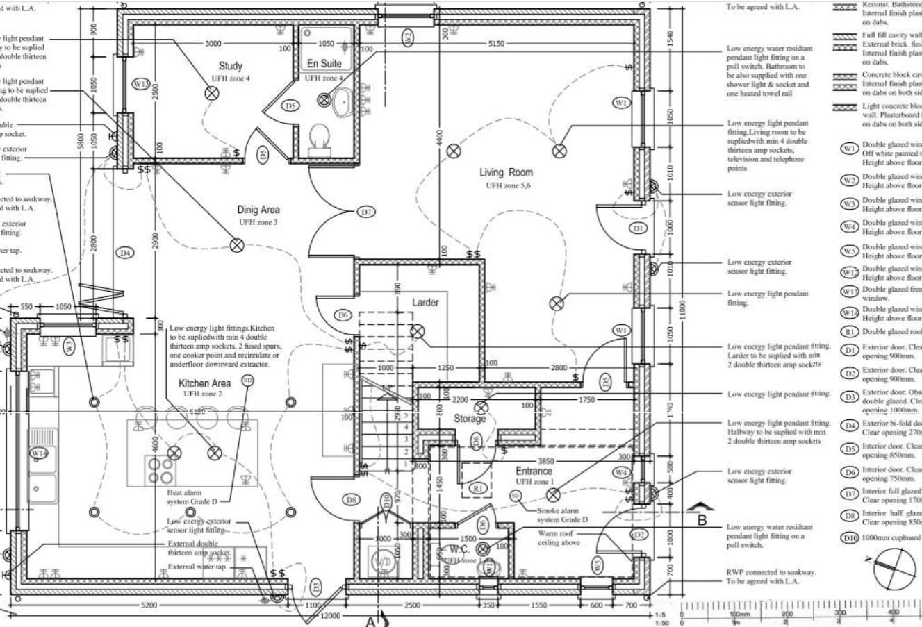

WWilts Posted January 18, 2021 Share Posted January 18, 2021 Which professional would you entrust with the design of foul drainage? (architect / engineer / other) Assume nobody in the family is in a position to self-design This is a self-build in our rear garden, located to the north of our house. The mains sewer is located nr south east corner of our front garden. Land slopes gently down to the rear (north), height difference in ground levels roughly 2 m from rear of new build to main road. Architect has drawn nearly all of the remaining Bldg Regs stuff but has so far avoided committing to any firm foul drainage plan. Saying builders will have good suggestions. So foul drainage is in limbo at present. I'd prefer to get builder (main contractor) quotes for a fully specified build. Grateful for any advice. Link to comment Share on other sites More sharing options...
PeterW Posted January 18, 2021 Share Posted January 18, 2021 Main bathroom run is going to be a nightmare. I’m assuming you don’t want any external soil stack showing on this new build ..?? 1 Link to comment Share on other sites More sharing options...
WWilts Posted January 18, 2021 Author Share Posted January 18, 2021 Open to any possibility. No strong views, given my ignorance. But main question is To which professional shoudl I entrust the drainage design (& specs for Building Regs)? Architect / engineer / other? Context on Building Regs permission: Likely Going for single building notice and private Building Control. Link to comment Share on other sites More sharing options...

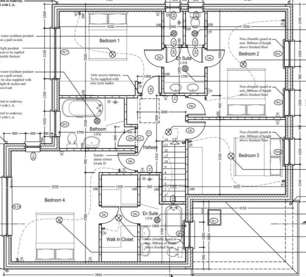

Dave Jones Posted January 19, 2021 Share Posted January 19, 2021 (edited) Plumber will do the above ground , builder/groundworker will do below ground. You don’t really want external soil stack as it looks gash so some thought and planning of where you bring it through the house into the ground is needed. sewer pipe is wider than a stud wall remember, but with pozi joists can help routing them no end. Edited January 19, 2021 by Dave Jones 1 Link to comment Share on other sites More sharing options...
Dave Jones Posted January 19, 2021 Share Posted January 19, 2021 (edited) I’d also ditch the pull cords in bathrooms , architect still thinks it’s 1970 lol don’t get the communal en-suite either split them off , who wants to share a sink with another bedroom ! Odd. the bedroom windows have non climbing guards, are they not fire escape windows ? shower in the second downstairs toilet ??? or are you thinking it’s another bedroom off the kitchen as you already have a downstairs toilet by front door ? 6 toilets for a 4 bed is a lot ! not seeing any extract ducting to the wc’s , building control will want that. Edited January 19, 2021 by Dave Jones 1 Link to comment Share on other sites More sharing options...

PeterW Posted January 19, 2021 Share Posted January 19, 2021 7 hours ago, SuperJohnG said: How come? the WC is above the largest open void and unless you go to the north wall - so go in reverse and put a fairly nasty external soil stack - you can’t get it easily to the East wall where the majority of other WC connections need to be. Depth of the floor would have to be pretty deep to get drops, and if floor joists run east west it will be around 150mm drop across that run and it still then has to do a dog leg unless you do a run of soil stacks along the East wall which isn’t ideal. one option would be to box out the end of the wall where the bifold stops in the edge of the kitchen and use that as a stack and put plenty of sound insulation around it so immediately to the left of the WC there would be a vertical stack. I’d flip the downstairs study WC and shower too and put the WC against the wall as you can also then box in to pick up the Jack and Jill on the same stack. Similar with the front cloaks, switch it left to right and you’ve got a chance of picking up a stack in the bottom right corner of that room. 7 hours ago, WWilts said: To which professional shoudl I entrust the drainage design (& specs for Building Regs)? Architect / engineer / other? Who’s doing all your plumbing design ..? Ventilation ..? Decent M&E designer should see that off in a couple of days or so with a full set of plans and elevations and the site plan. 1 Link to comment Share on other sites More sharing options...

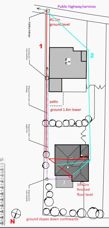

WWilts Posted January 19, 2021 Author Share Posted January 19, 2021 3 hours ago, Dave Jones said: Plumber will do the above ground , builder/groundworker will do below ground. It's the design stage that troubles me. Currently being left for later by architect. I am not comfortable with that. Even alternatives would seem preferable to no design at all. For pricing by potential main contractor, and for Building Regs. 3 hours ago, Dave Jones said: I’d also ditch the pull cords in bathrooms I should know all this, but what is the alternative please? Switch outside the door? No views here, genuine complete ignorance. Hence hunger for alternatives to problem situations. 3 hours ago, Dave Jones said: the bedroom windows have non climbing guards, are they not fire escape windows ? Will ask architect 3 hours ago, Dave Jones said: not seeing any extract ducting to the wc’s , building control will want that. Tks, will ask architect 2 hours ago, nod said: You will give your groundwork’s a detailed drawing Usually done by the Architect or engineer No drawing at all, currently. This is my problem 58 minutes ago, PeterW said: Never seen a house built on a building notice and very much doubt you will find a company that will do it. The opportunity for finding a 5 figure issue at inspection would be huge. Architect has had them done before, I am told, using builders and private Bldg Inspectors he regularly works with. But I am open to alternatives. Architect certificate might not suffice for potential buyers if we have to move in a few years (as probable). Inclined to pay for structural warranty in addition. Another whole topic though. 1 hour ago, PeterW said: one option would be to box out the end of the wall where the bifold stops in the edge of the kitchen and use that as a stack and put plenty of sound insulation around it I like that idea. We had innumerable iterations within the family and had to enforce a design freeze at some point to allow drawings to progress 1 hour ago, PeterW said: I’d flip the downstairs study WC and shower too and put the WC against the wall as you can also then box in to pick up the Jack and Jill on the same stack. Great idea 1 hour ago, PeterW said: Similar with the front cloaks, switch it left to right and you’ve got a chance of picking up a stack in the bottom right corner of that room. first floor or ground floor? Sorry to be unfamiliar with some of the terminology 1 hour ago, PeterW said: Who’s doing all your plumbing design ..? Ventilation ..? Decent M&E designer should see that off in a couple of days or so with a full set of plans and elevations and the site plan. Thanks. Any recommendations for such a M&E designer pls, anyone? Recommendation for drainage design (ground works, routing) is what I really need. See alternative routes 1 and 2 in diagram, next post. 1 hour ago, Jilly said: I think you would be badly advised to do this on a Building Notice. On a Full Plans application they check everything in advance and confirm you are in the clear. The last thing you want is for them to say near completion that they want something changed or that the regs have altered. Sage advice, thanks 1 hour ago, Jilly said: Also get the design stage SAP calculations done on this so that you are certain that is ok. Thanks 25 minutes ago, ToughButterCup said: everyone is shoving responsibility to everyone else It's like going to a surgeon and them saying ask the nurse which operation you need. So the patient needs to google. I'm looking for which surgeon to pin down and make responsible. Paying for design, drawings too. But omissions trouble me Thanks, I might start sleeping better at night as the concerns get sorted out one by one 1 Link to comment Share on other sites More sharing options...
WWilts Posted January 19, 2021 Author Share Posted January 19, 2021 Alternative routes for drainage. My layperson ideas. Which would you prefer? 1 or 2? Why? Link to comment Share on other sites More sharing options...
PeterW Posted January 19, 2021 Share Posted January 19, 2021 35 minutes ago, WWilts said: Architect has had them done before, I am told, using builders and private Bldg Inspectors he regularly works with. But I am open to alternatives. The cost for application is the same. And it makes you plan stuff such as all the points I have called out such as pipework that cannot be installed due to steels or joists the wrong way round. 1 Link to comment Share on other sites More sharing options...
PeterW Posted January 19, 2021 Share Posted January 19, 2021 34 minutes ago, WWilts said: Alternative routes for drainage. My layperson ideas. Which would you prefer? 1 or 2? Why? You can’t do 1 without getting permission from your sewage provider as the section from existing to the road becomes an adopted sewer as it services more than one property. Option 2 requires an easement in property ones deeds so has a cost. 1 Link to comment Share on other sites More sharing options...
ProDave Posted January 19, 2021 Share Posted January 19, 2021 Have you looked at levels yet? Regardless of which route you take, it looks to me like the new house is lower down the slope than the road. Depending on how deep the sewer is in the road, you might very well need a holding tank and pumping station. 1 Link to comment Share on other sites More sharing options...
WWilts Posted January 19, 2021 Author Share Posted January 19, 2021 2 minutes ago, ProDave said: ou might very well need a holding tank and pumping station. Yes, that is intended 15 minutes ago, PeterW said: Option 2 requires an easement in property ones deeds so has a cost. Won't both options require similar agreements with the host dwelling (us)? Link to comment Share on other sites More sharing options...
WWilts Posted January 19, 2021 Author Share Posted January 19, 2021 16 minutes ago, PeterW said: You can’t do 1 without getting permission from your sewage provider as the section from existing to the road becomes an adopted sewer Ancient private drain and manhole there. So option 1 would have the drain running along the east boundary to join the main sewer directly. Link to comment Share on other sites More sharing options...
