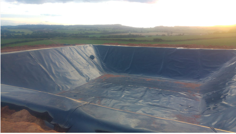

Iceverge Posted January 18, 2021 Posted January 18, 2021 A membrane lined slurry lagoon is what you're after. Then a few hundred Chinese solar tubes, Then sit back and wait for your goldfish to grow to the size of sharks in the tepid water and eat your children. 1
Conor Posted January 19, 2021 Author Posted January 19, 2021 (edited) Well, I've ordered a book on natural pool design and I've started to wear down the project funder... I'd say we'll put off the major landscaping until next year. Plenty of time to get a design (and permission) figured out. @Iceverge not a million miles away from some of the design concepts out there. You put a flat base in, build up walls to form the deep swimming area, fill the outside between the edges and the walls with gravel and clay to form the shallow living area. Edited January 19, 2021 by Conor
