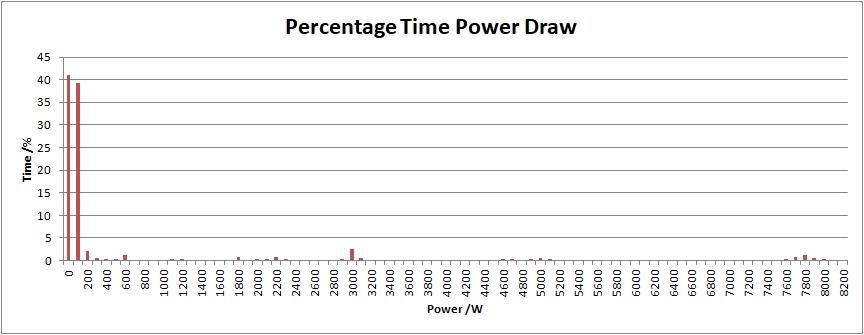

SteamyTea Posted January 23, 2021 Posted January 23, 2021 39 minutes ago, PeterW said: you’ll be surprised at the phantom loads Why I have done things to reduce them. First chart is all my power draws. 41% of the time during 2020, I drew nothing at all. Then 39% of the time I drew less than or equal to 100W. Second chart zooms in on the 0 to 100W window. The main power draw is between 29 and 42W. Most of that will be the fridge and the PC charging.

SteamyTea Posted January 23, 2021 Posted January 23, 2021 14 minutes ago, AliG said: The constant load that people are unlikely to think about comes from things like Sky Q boxes, Wi-Fi repeaters, UFH pumps, MVHR etc which all can use modest amounts of power all the time. You could easily have 100W+ of constant draw from things like these. You can see that in the charts from @joe90's I put up. His base load is around 400W.

joe90 Posted January 23, 2021 Posted January 23, 2021 1 hour ago, SteamyTea said: You can see that in the charts from @joe90's I put up. His base load is around 400W. Which is...... mvhr hard drive recorder router fridge freezer tv (standby) treatment plant bathroom radiators all other things are as required (which might contribute to the 400w).
SteamyTea Posted January 23, 2021 Posted January 23, 2021 1 minute ago, joe90 said: Which is...... mvhr hard drive recorder router fridge freezer tv (standby) treatment plant bathroom radiators all other things are as required (which might contribute to the 400w). Yes, it soon adds up. The only thing on that list I have is a fridge.
