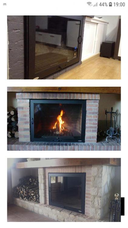

Ronan 1 Posted January 20, 2021 Author Posted January 20, 2021 17 minutes ago, Onoff said: Unless you absolutely must toast marshmallows why not an electric, log effect stove for the traditionalists or an LCD flame effect heater? Different I suppose if your wood is free. Woods free which helps but the main thing is we both really want the open fireplace, I suppose it like a new Porsche or the Rally car in the garage or anything else we throw into houses or our lives because we like them. I'm prepared to put up with all the downside to have them so if as stated elsewhere I have to "buy" SAP points or whatever to satisfy this I'm ok with that. Horses for courses i guess I'll ?
joe90 Posted January 20, 2021 Posted January 20, 2021 I was told my woodburner was no good for my new build but it’s great, don’t light it much but yes it’s my “Porsche “ (don’t need but want). Have the option of leaving the door open to toast marshmallows or shut to see lovely flames but keep the nasties out, best of both worlds IMO.

Ronan 1 Posted January 20, 2021 Author Posted January 20, 2021 38 minutes ago, ProDave said: If this open fire proposal is for a new build, do come back and tell us what building control say and if they pass it please. Hi Dave yes it's a new build. It is for an ammended planning application and as the approved application has 2 fireplaces I don't see it as being a problem BUT I could be very wrong. It has been known ? Whenever my architect finally comes back with the changes and let's me know if I need to do anything else I'll let us know. This Covid aparently stops everyone from working quickly but hopefully I'll know in the not to distant future 37 minutes ago, Thedreamer said: I take it you are not going to be fitting PV and charging one of these. Probably would get 60000 miles a year outta one of them ? or not at least in the timeframe required.
Mr Punter Posted January 20, 2021 Posted January 20, 2021 So the short answer is you will not benefit much with MVHR as it will not be able to compensate for the uncontrolled air losses through the open chimneys but feel free to have it anyway. Agreed that you will struggle to get Building Regs to pass an open fire. Not sure if the convector box ones would let you scrape through? I think they are a bit more efficient than a straight open fire. If you have a fair bit of land you may want to consider mounting the PV panels on an outbuilding or at ground level as you may need quite a few.
Ronan 1 Posted January 20, 2021 Author Posted January 20, 2021 8 minutes ago, Mr Punter said: So the short answer is you will not benefit much with MVHR as it will not be able to compensate for the uncontrolled air losses through the open chimneys but feel free to have it anyway. Agreed that you will struggle to get Building Regs to pass an open fire. Not sure if the convector box ones would let you scrape through? I think they are a bit more efficient than a straight open fire. If you have a fair bit of land you may want to consider mounting the PV panels on an outbuilding or at ground level as you may need quite a few. Thank MrPunter, yes I might look about another type of ventillaion only system that might negate the need for trickle vents and cold bathroom extractors fans. I have just over an acre and a half and a 6m x 12m garage so it would be very suitable for pv if needed. I just need to see what my architect has done or has planned .... I know I'm getting a bit of flack and have different priorities than some on here BUT I appreciate hearing all the different views / arguments on it regardless. Keep up the good work BH ?
