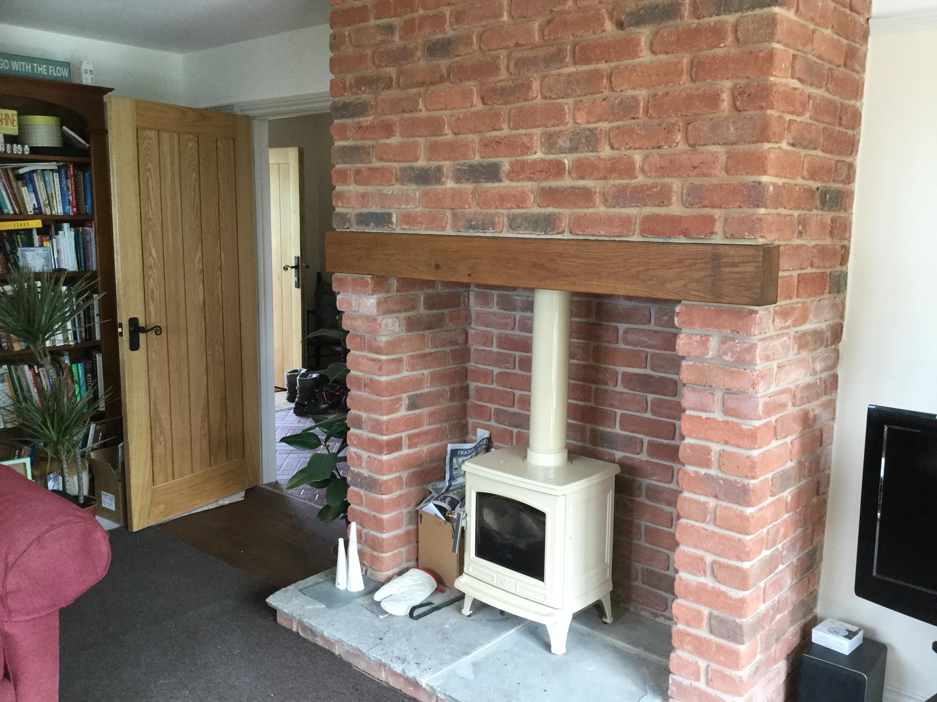

joe90 Posted January 14, 2021 Share Posted January 14, 2021 (edited) +1 with room sealed wood burning stove, I have one and MVHR works very well! (And they need not be black!) Edited January 14, 2021 by joe90 2 Link to comment Share on other sites More sharing options...

joe90 Posted January 14, 2021 Share Posted January 14, 2021 5 minutes ago, Jason L said: Does the Mvhr system overcome the need for the air bricks for the fire . ? if installing MVHR you need a room sealed stove, they have a ducted air input pipe extending to outside so it does not use indoor air. 1 Link to comment Share on other sites More sharing options...

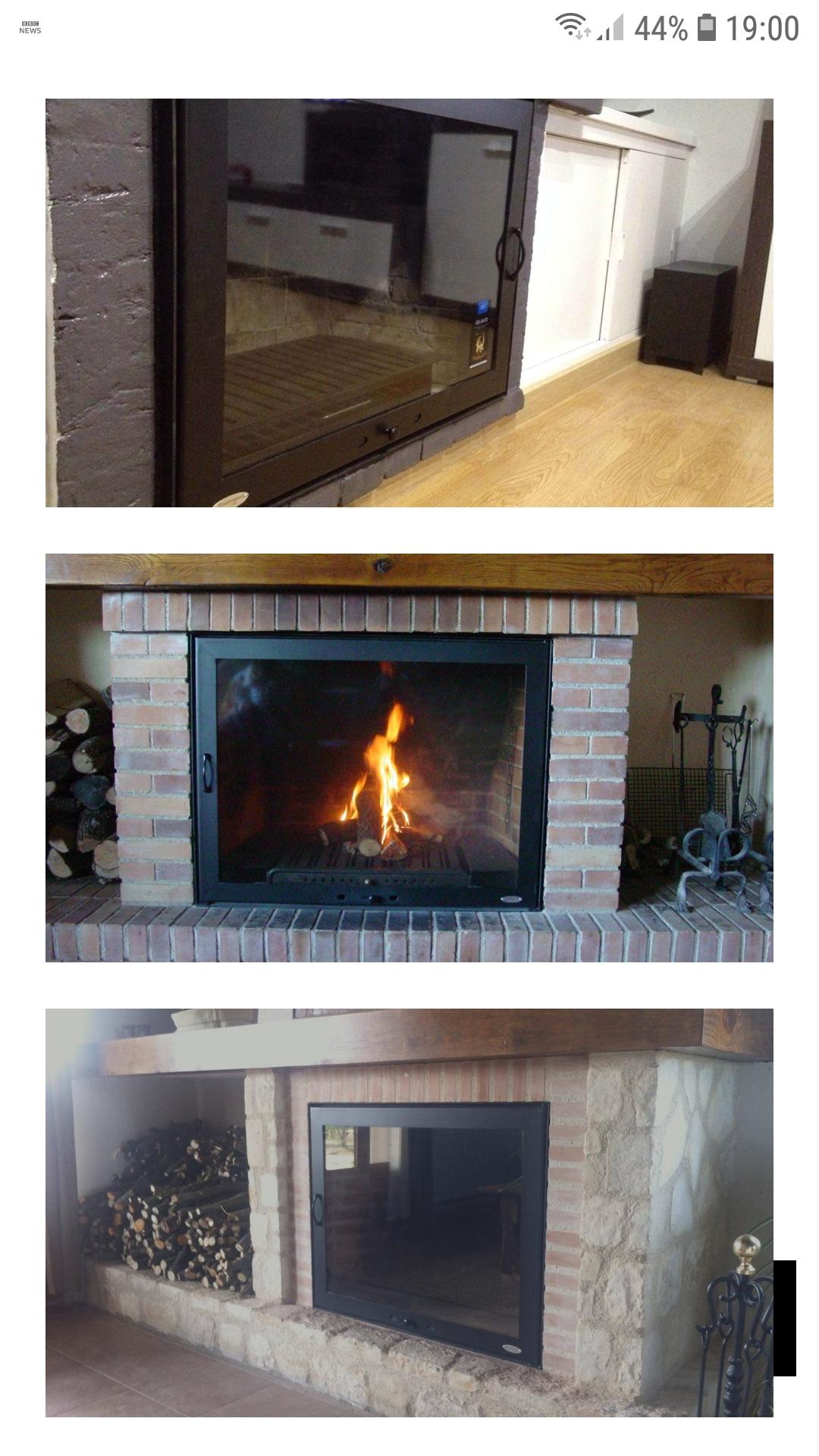

Ronan 1 Posted January 14, 2021 Author Share Posted January 14, 2021 Wonder would one of these glass doors make a difference Link to comment Share on other sites More sharing options...
Roundtuit Posted January 14, 2021 Share Posted January 14, 2021 3 minutes ago, Ronan 1 said: Wonder would one of these glass doors make a difference Probably direct more of the heat straight up the chimney, but it might keep you warm cleaning the glass? 1 Link to comment Share on other sites More sharing options...
Ronan 1 Posted January 14, 2021 Author Share Posted January 14, 2021 (edited) 4 minutes ago, Roundtuit said: Probably direct more of the heat straight up the chimney, but it might keep you warm cleaning the glass? Aparently they are designed to direct more of the heat out !!! But to be honest the fireplaces isint just for the heat and I don't think the fact it will leave the house non airtight will bother me that much, I supposed it's not high on my list of priorities for the build. I will just ensure that it is good and airtight everywhere else and well insulated as I said I'm used to very old, very draught and VERY cold. Edited January 14, 2021 by Ronan 1 Link to comment Share on other sites More sharing options...
Adsibob Posted January 19, 2021 Share Posted January 19, 2021 On 14/01/2021 at 17:18, joe90 said: +1 with room sealed wood burning stove, I have one and MVHR works very well! (And they need not be black!) Beautiful stove @joe90. Which manufacturer and model is that? Link to comment Share on other sites More sharing options...

joe90 Posted January 20, 2021 Share Posted January 20, 2021 9 hours ago, Adsibob said: Which manufacturer and model is that? https://www.ukstoves.co.uk/p/5kw-oakdale-gloss-cream-se-multi-fuel-stove Link to comment Share on other sites More sharing options...
