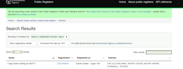

SteamyTea Posted December 10, 2022 Posted December 10, 2022 On 13/01/2021 at 12:06, George said: Licenced waste carrier that can take hazardous waste, I think you can check here: https://environment.data.gov.uk/public-register/view/search-waste-carriers-brokers You need to do all that is reasonable and practicable to check it is legal. So record the emails/phonecalls that you have had to demonstrate your due diligence. How often do they update the database. https://www.cornwalllive.com/news/cornwall-news/cornwall-skip-hire-boss-operating-7911527

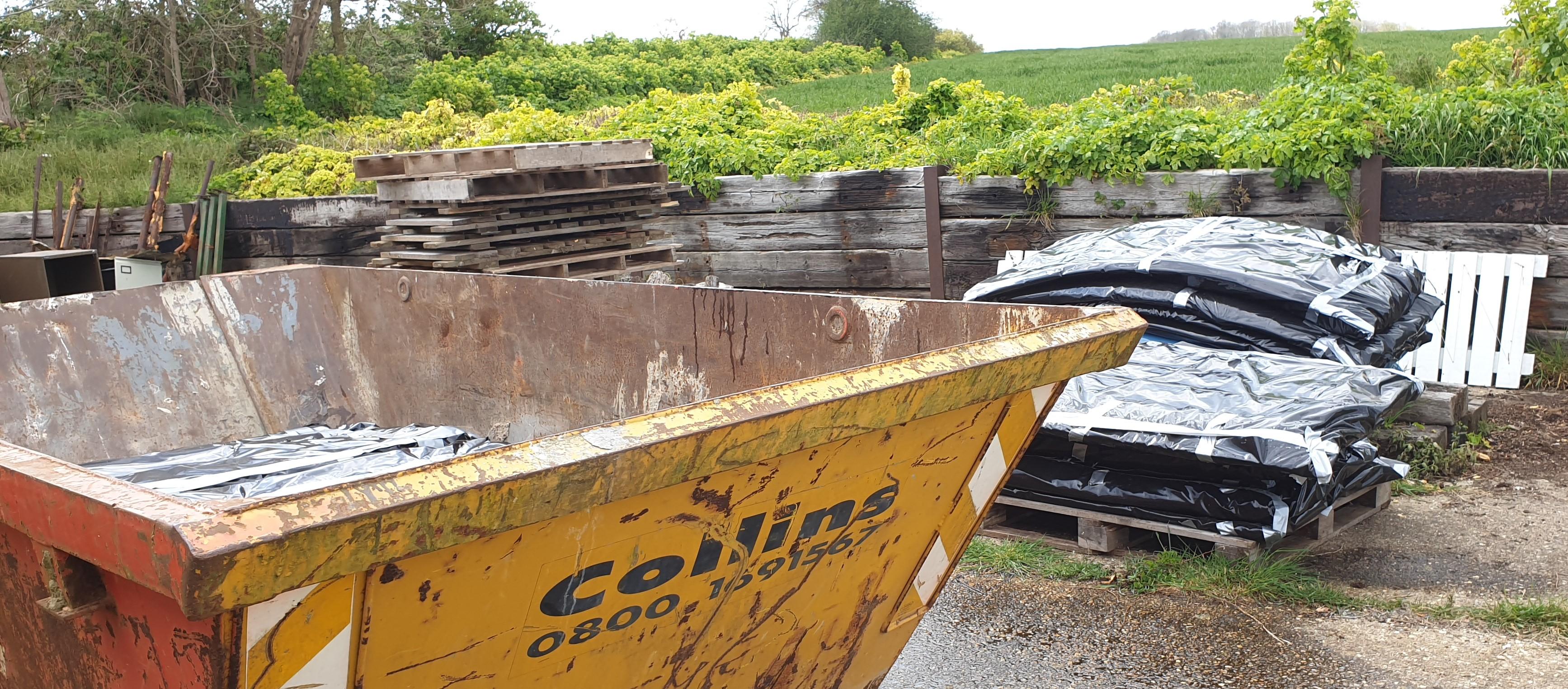

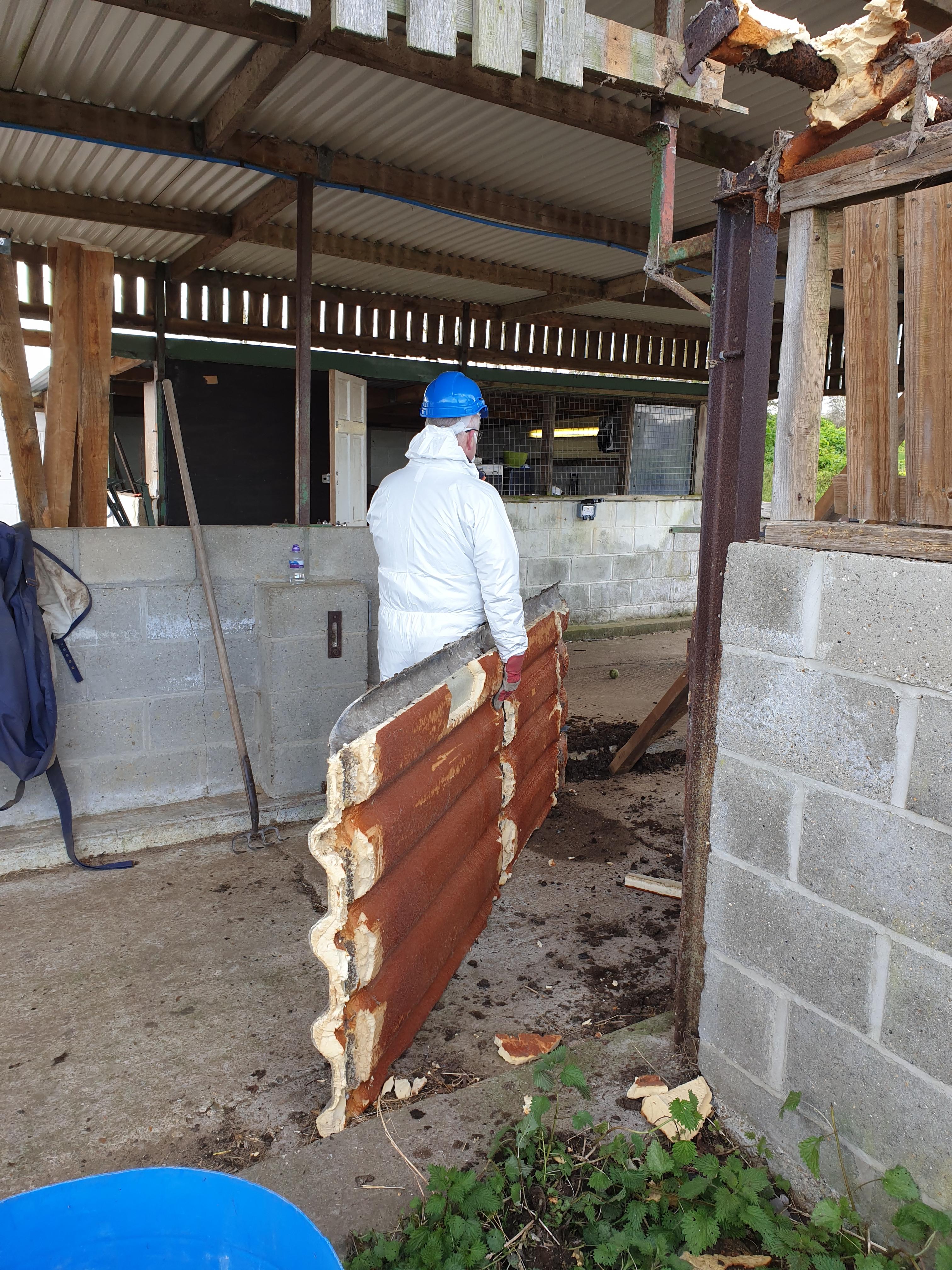

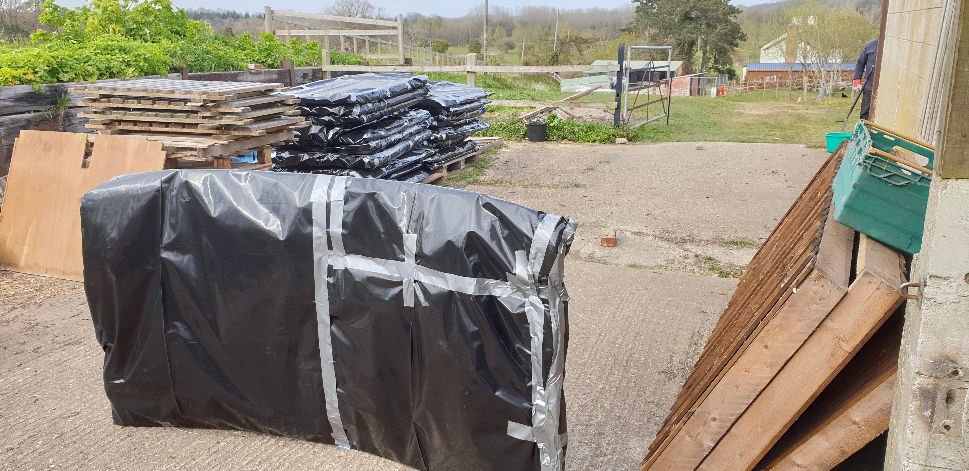

LSB Posted September 5, 2023 Author Posted September 5, 2023 we removed ours and hired a skip. All double wrapped and skip wrapped and covered, total cost of 8m * 6m was £800 All suits disposed off after use. 4
saveasteading Posted September 5, 2023 Posted September 5, 2023 12 minutes ago, LSB said: All suits disposed off after use. In the same skip? With masks. You know you've packed it well and got good value when the lorry struggles to lift the skip.

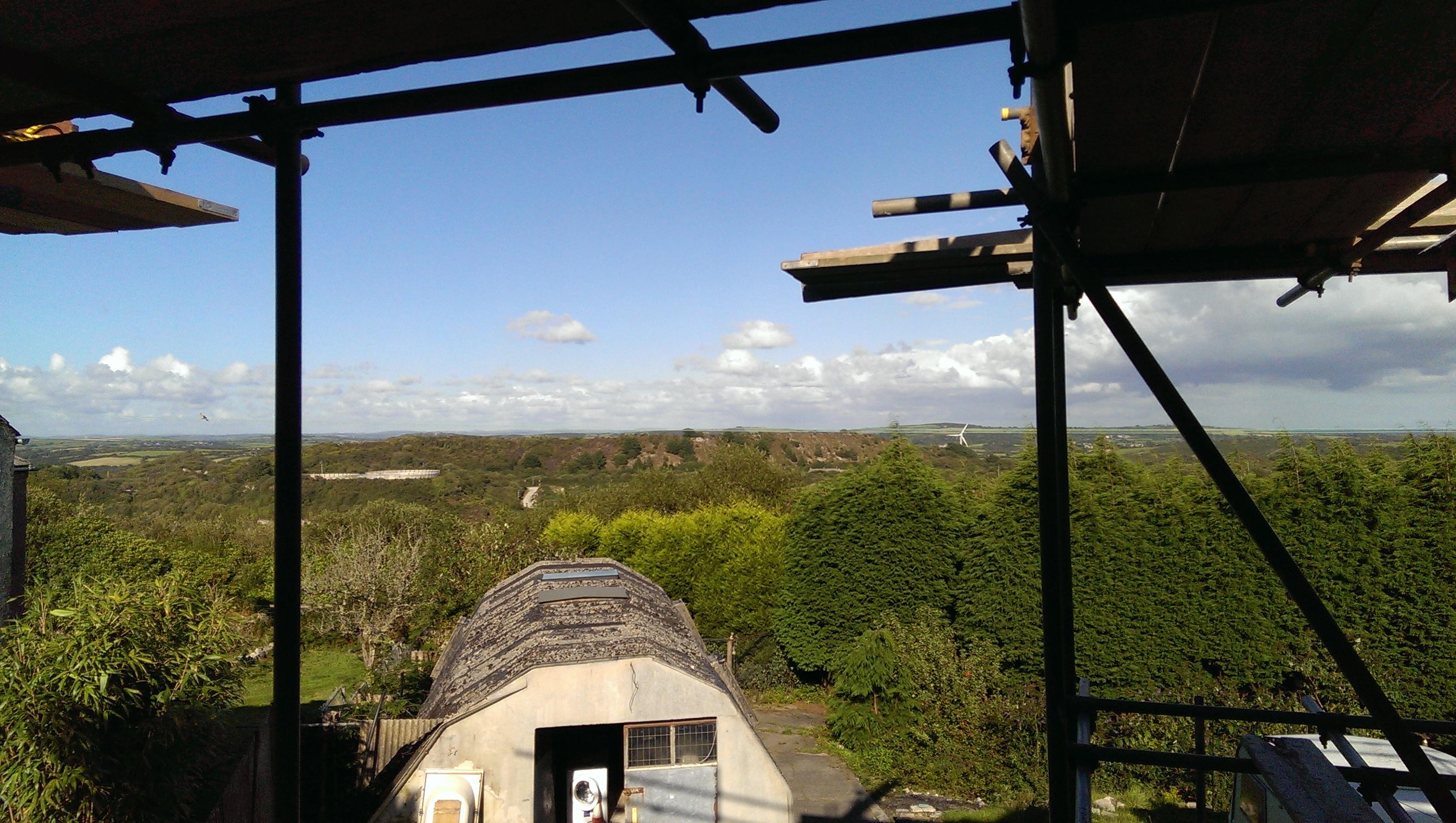

LSB Posted September 5, 2023 Author Posted September 5, 2023 6 hours ago, saveasteading said: In the same skip? With masks. You know you've packed it well and got good value when the lorry struggles to lift the skip. the skip was totally full, flat to the top, and yes the masks and suits all went in wrapped the same. Chances are that there wasn't much asbestos in the sheets, but we decided to do it properly. Skip lorry took 2 attempts to lift. Although since then we have dug up quite a few small bits that we have been able to take to the tip, about a bucket full in total when we dug out, only about 2 inches down though, good soil under that, not sure where they came from as couldn't be seen until we dug. It's funny, it's not until looking that those pictures that I remember the roof was curved. We're supposed to replicate the shape with the new green roof, that will be a challenge, it we decide to try, but not on our drawings so probably won't. The quotes we had were for about 6 - 8 k so did it for 10%. Except one quote for £500, but we just didn't fancy finding it a week later in one of our ditches. 1
saveasteading Posted September 5, 2023 Posted September 5, 2023 2 hours ago, LSB said: that will be a challenge The cladding will curve naturally if you choose the right profile, but getting the rails right takes a bit of working out.
LSB Posted September 6, 2023 Author Posted September 6, 2023 17 hours ago, saveasteading said: The cladding will curve naturally if you choose the right profile, but getting the rails right takes a bit of working out. it's more the green roof bit that I'm not sure about curving.
saveasteading Posted September 6, 2023 Posted September 6, 2023 1 hour ago, LSB said: green roof bit I don't like green roofs. Over-rated: see rants elsewhere. Also very heavy requiring a lot of structure. but will slide off a curved roof, as happened to this, among other dramas.
joe90 Posted September 6, 2023 Posted September 6, 2023 (edited) That was the grand designs using glued together herringbone tiles, didn’t they use plastic formers to hold the soil in place? (I thought it was a big gamble but looked good!!) Edited September 6, 2023 by joe90
LSB Posted September 6, 2023 Author Posted September 6, 2023 I remember that GD. This GR is part of our planning conditions for converting the barn, luckily it's only the small bit of the 'L' and not the whole roof.
