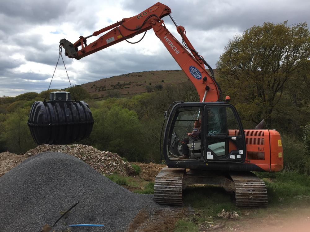

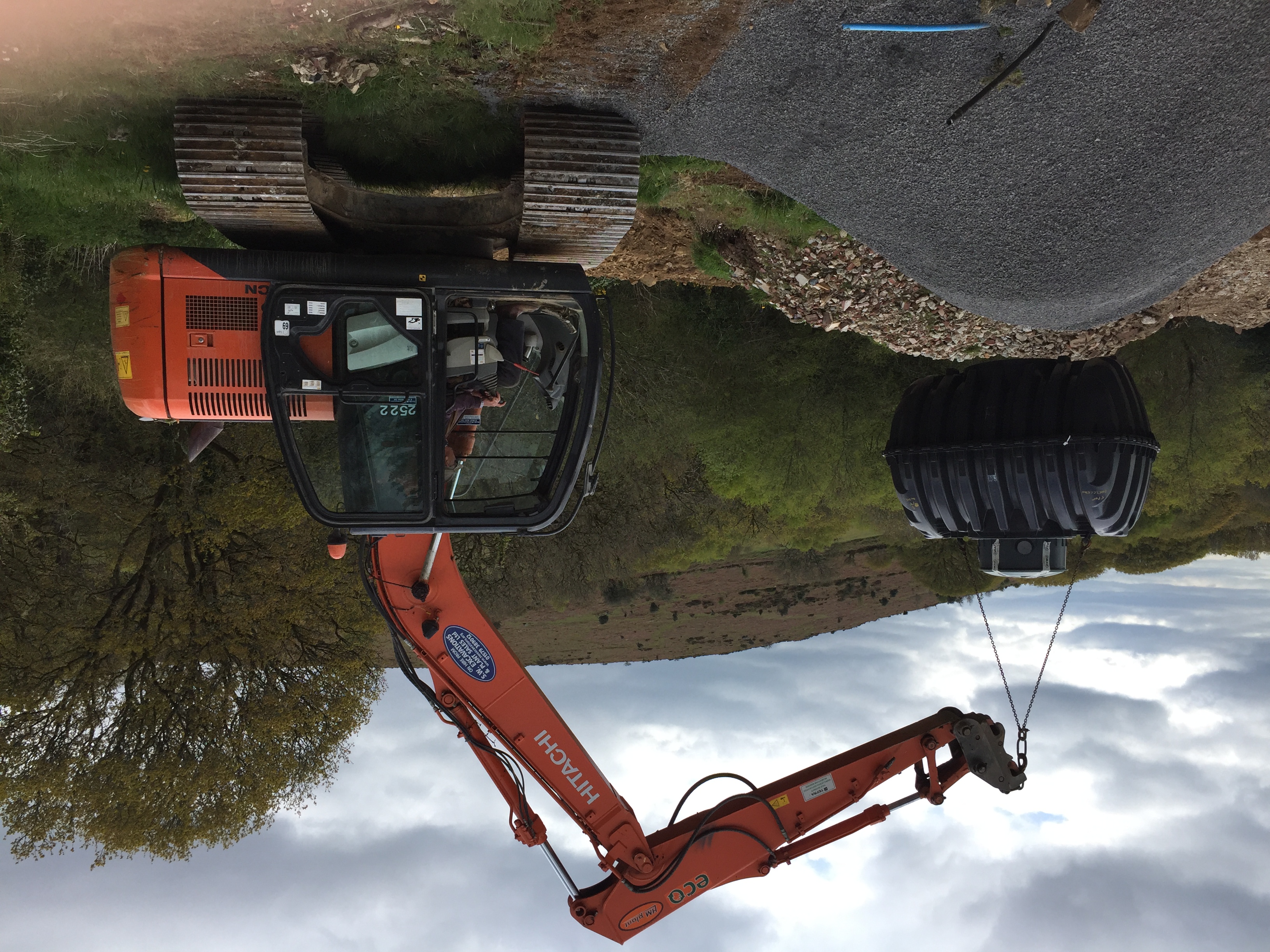

Barney12 Posted April 27, 2017 Share Posted April 27, 2017 The Graff tank going in today. Although the instructions supplied with the pump are limited you have to set the date and time on the unit and it definitely makes references to "cycle rest pauses". 2 Link to comment Share on other sites More sharing options...

Barney12 Posted April 27, 2017 Share Posted April 27, 2017 We should have it fully installed by tomorrow. I'll run a temporary power supply to it and report back on cycle times. 1 Link to comment Share on other sites More sharing options...

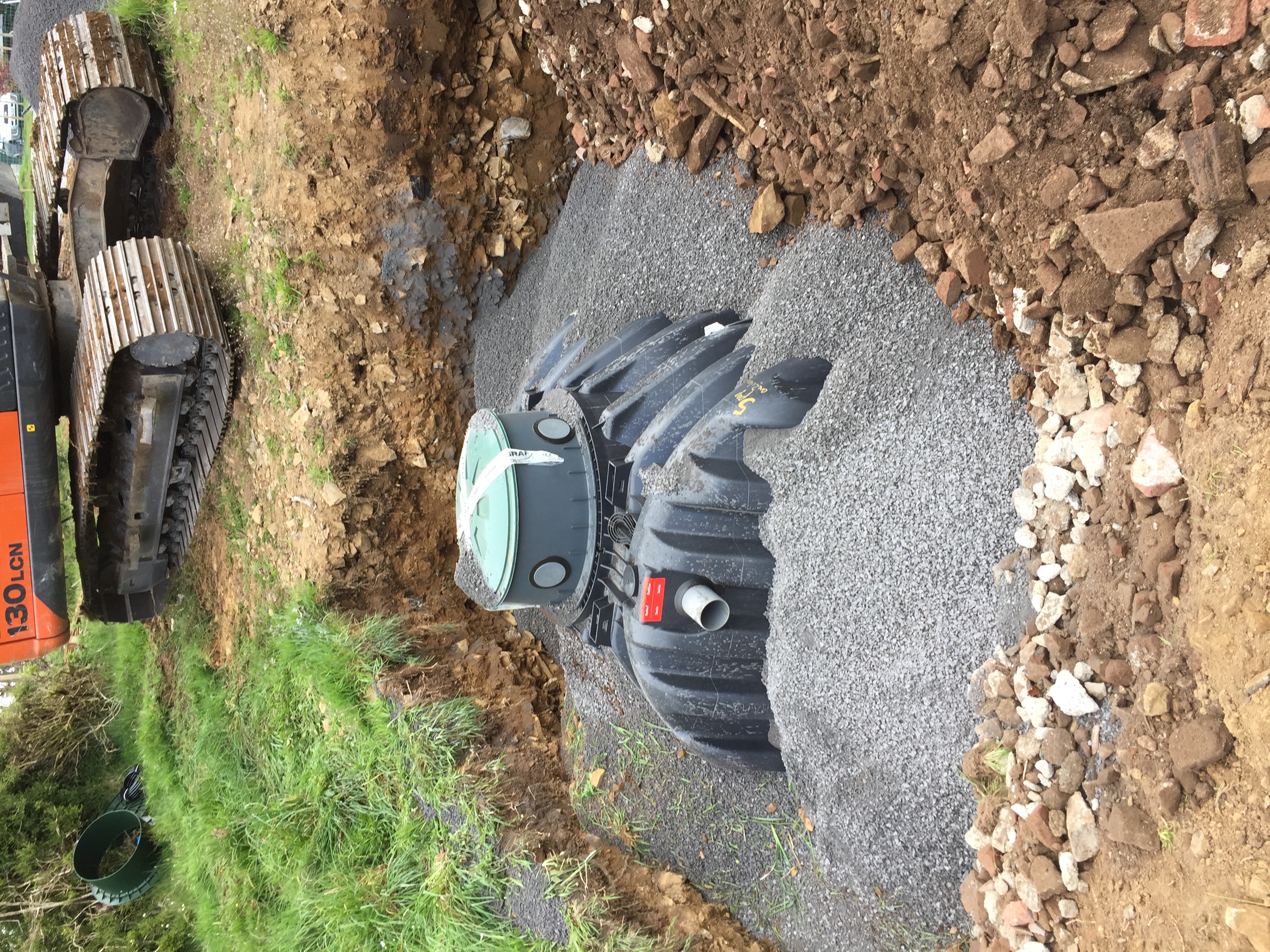

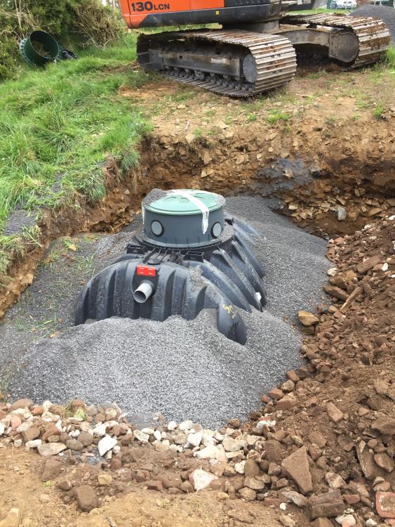

Barney12 Posted April 28, 2017 Share Posted April 28, 2017 Its in the ground! Link to comment Share on other sites More sharing options...

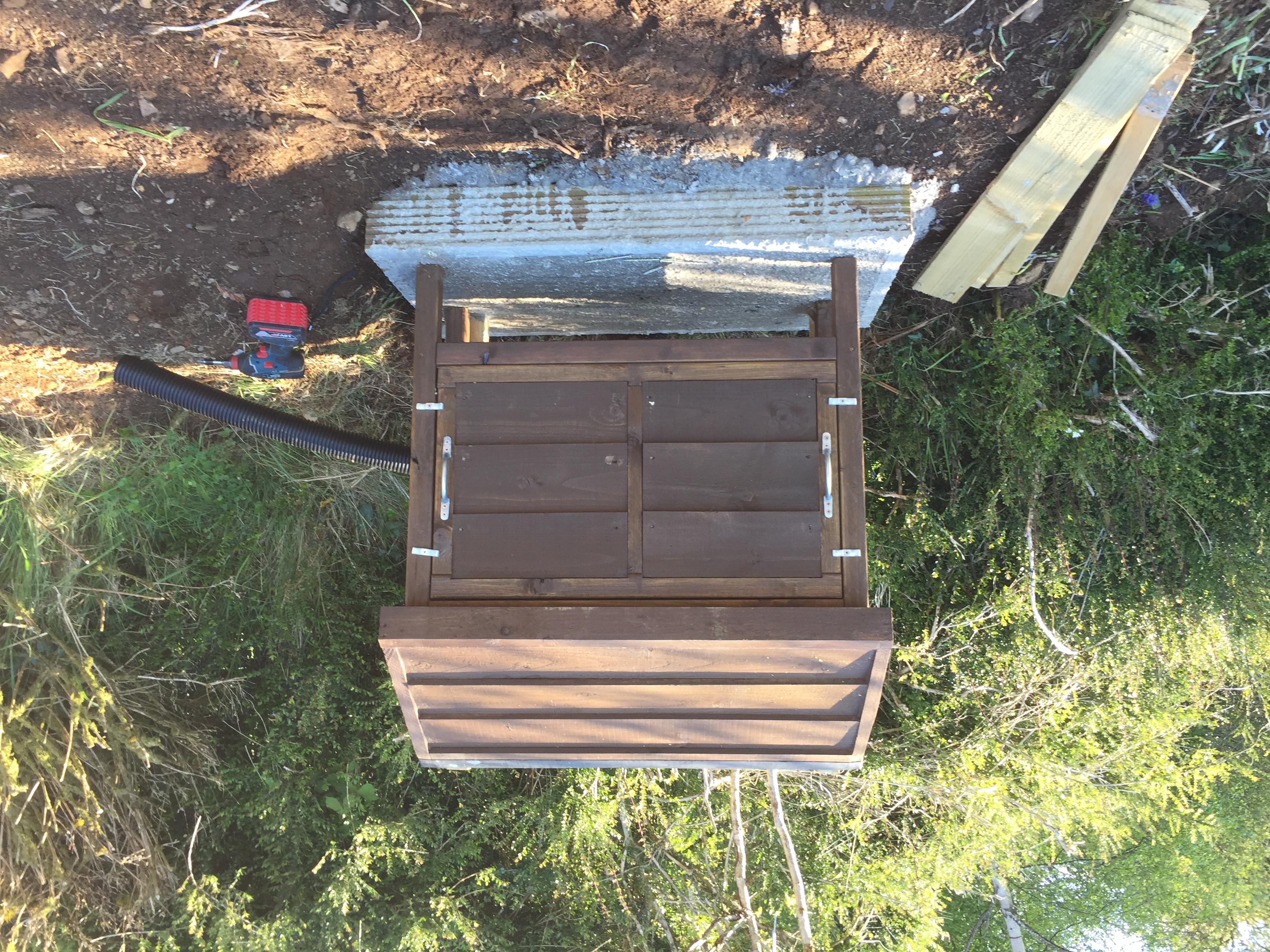

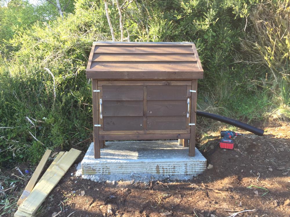

Barney12 Posted May 2, 2017 Share Posted May 2, 2017 Knocked together my little "pump house" on Saturday for the Graff unit. Link to comment Share on other sites More sharing options...
ProDave Posted May 2, 2017 Share Posted May 2, 2017 Watch the local bees don't take up residence Link to comment Share on other sites More sharing options...
Barney12 Posted May 2, 2017 Share Posted May 2, 2017 20 minutes ago, ProDave said: Watch the local bees don't take up residence Bees I can cope with. Bats....well that would be another matter 1 Link to comment Share on other sites More sharing options...

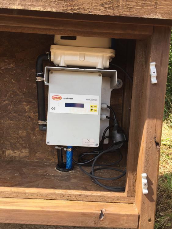

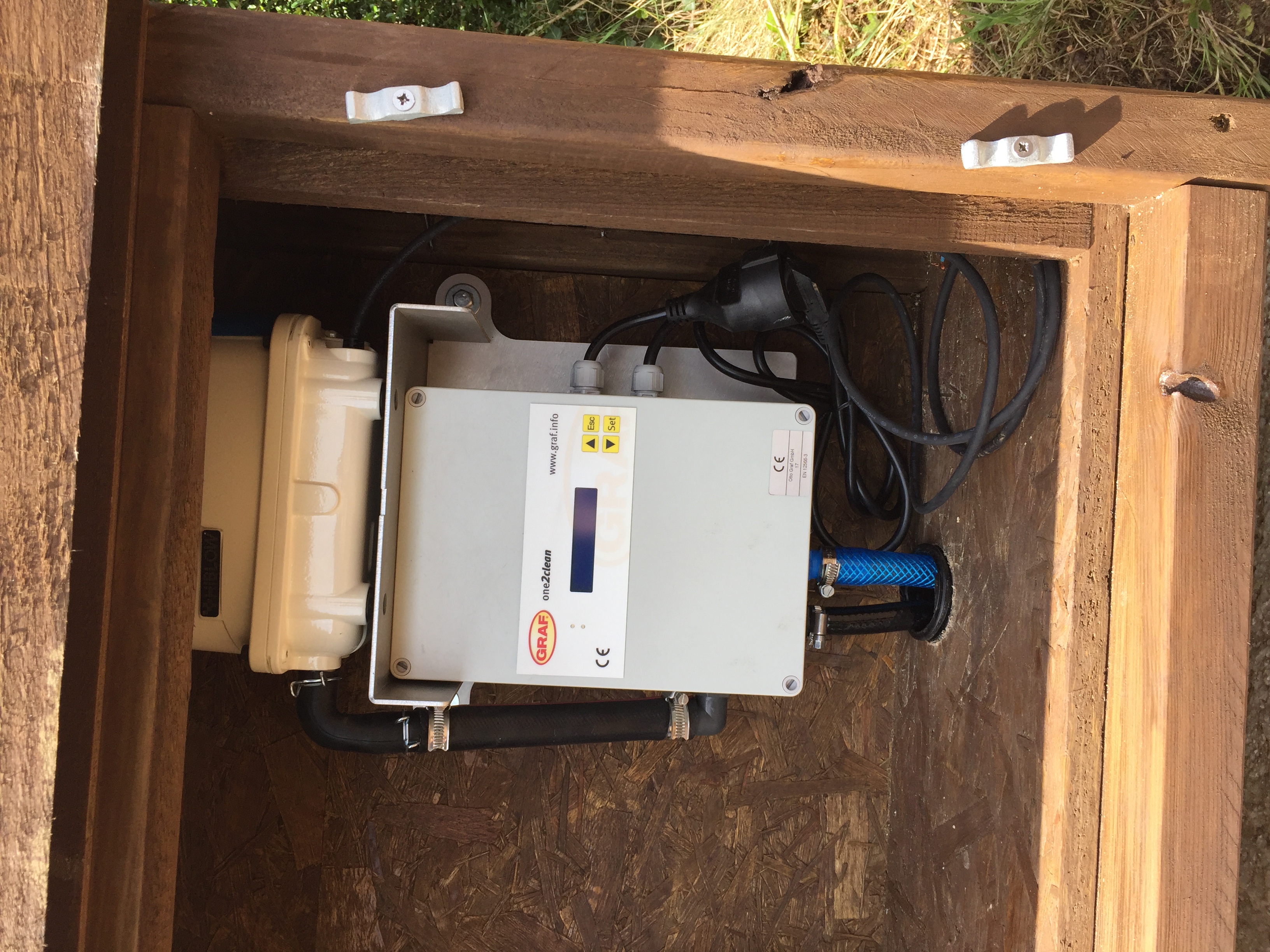

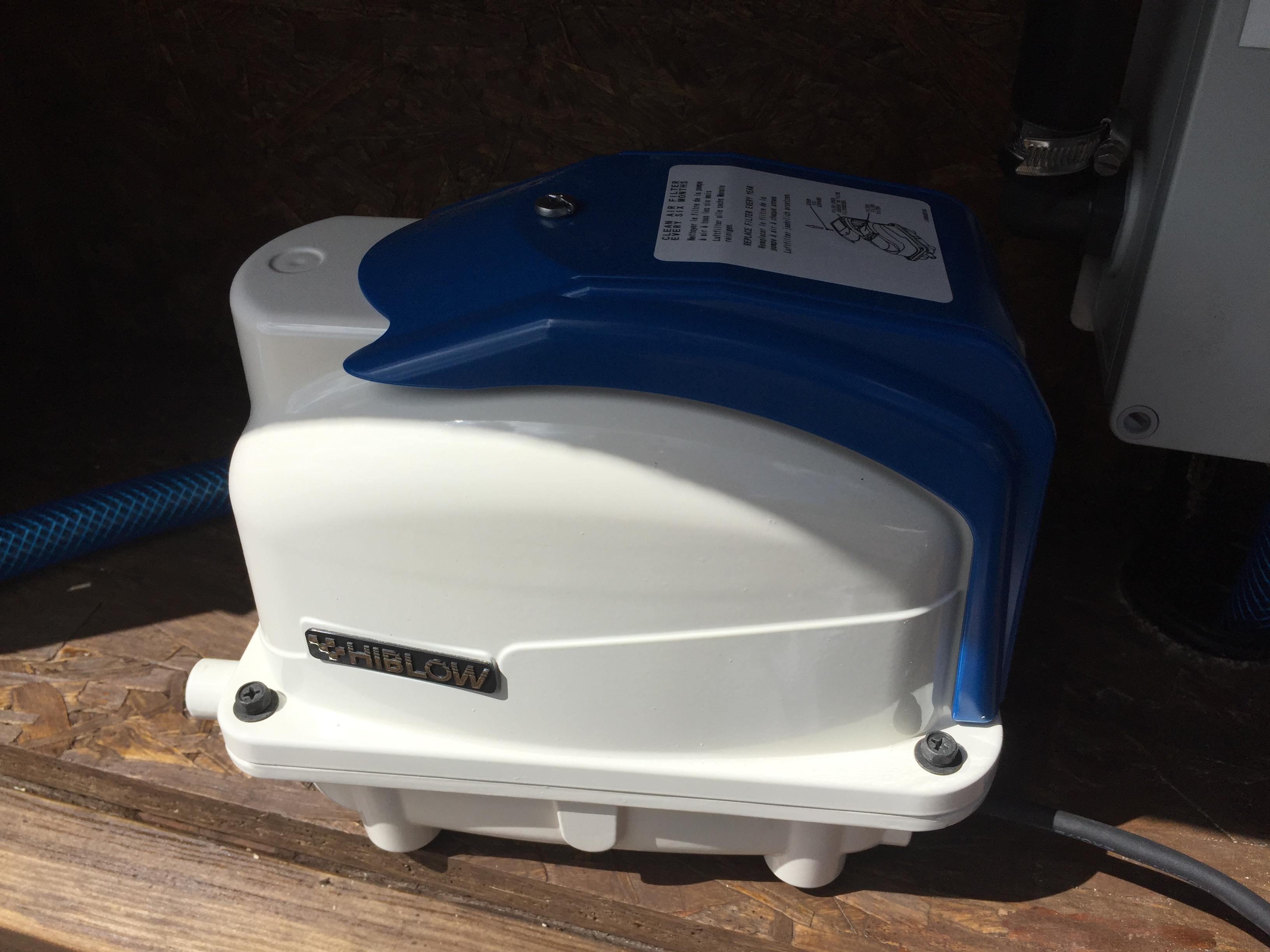

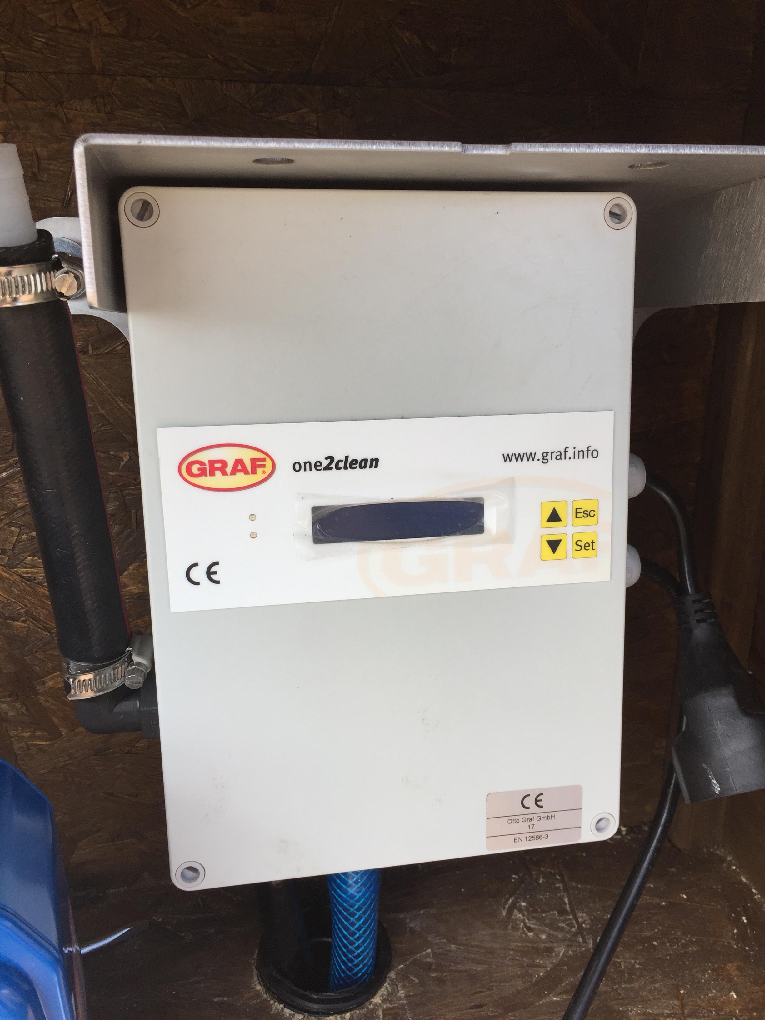

Barney12 Posted May 14, 2017 Share Posted May 14, 2017 A few pics of the control unit and pump for those following this thread: Link to comment Share on other sites More sharing options...
PeterW Posted May 14, 2017 Share Posted May 14, 2017 Errrr is that how they really supply the pump to controller connector ..??! That's a euro plug and socket - not sure that's legal in the U.K. ..??? @ProDave or @Onoff would know ... Link to comment Share on other sites More sharing options...
Jeremy Harris Posted May 14, 2017 Share Posted May 14, 2017 (edited) Not UK legal, and should never be sold here on a new appliance. It should have been supplied with a fitted UK fused plug. You can cut the lead off and fit a 13A plug, fitted with the appropriate fuse, but the onus is on the supplier to have done this. Edited May 14, 2017 by JSHarris Link to comment Share on other sites More sharing options...
Barney12 Posted May 14, 2017 Share Posted May 14, 2017 Yep, euro plug to euro socket between the pump and controller. The controller also has a Euro plug but the instructions tell you to permanently wire to a FCU. Link to comment Share on other sites More sharing options...
