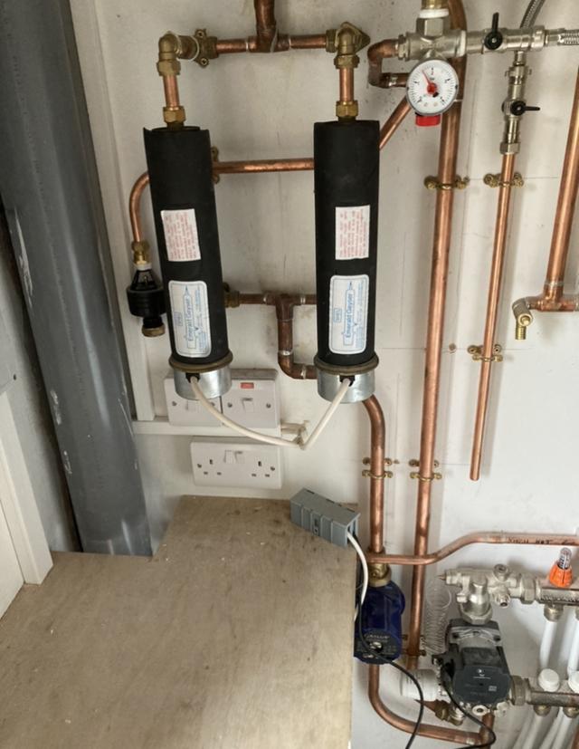

Russdl Posted February 14, 2021 Posted February 14, 2021 I really think this is the best way to heat a passive house (kudos to TerryE, I think he was the inventor?). My Willis heater UFH was recently commissioned and within a few days the trades were asking for the heat to be turned down. We have no controls for it so it was turned off. A week later, in freezing conditions it was still pleasantly warm inside. We do have a problem though as the left hand of the two Willis heaters doesn't work, and evidently from my energy usage it never has, so I guess it was never tested. Who would have thought. There is a peak in consumption as they were turned on on the 27th Jan but not enough of a peak to suggest that both heaters were working, probably just the RH Willis heater and the kettle. The following day it's just one Willis heater and the odd bit of kettle action. It's not the reset button on the bottom, so it needs to be replaced. I think I've found the exact model and as @TerryE pointed out, they are so cheap I may as well get a couple of spares. I guess it's going to be easy to replace. How do I go about replacing it without filling the whole system with air again - or is that inevitable? I also need to get some inhibitor in the system, should I do it when I replace the defective Willis heater or should I run the system for a few days to make sure all the air is out before I put the inhibitor in?
PeterW Posted February 14, 2021 Posted February 14, 2021 Change the thermostat first. They are prone for issues as they are quite short and it could be a duff one that has tripped out and not reset. 1
Russdl Posted February 14, 2021 Posted February 14, 2021 On 14/02/2021 at 18:36, PeterW said: Change the thermostat first Expand Can you give me more clues? How would I do that?
joe90 Posted February 14, 2021 Posted February 14, 2021 Can only find this fir an immersion but should be the same. https://www.diydoctor.org.uk/projects/immersionheater.htm
Russdl Posted February 14, 2021 Posted February 14, 2021 @joe90 That looks like it may be the thing, they look very similar but I wonder if it's worth the faff? Any idea how I check to see if that really is the bit that is screwed? Well outside of my skill set which is why I got a 'pro' in to do all that stuff in the first place...
PeterW Posted February 14, 2021 Posted February 14, 2021 It’s inside the head. Left looks to be off anyway ..? Small but on the bottom of the unit, steel lid comes off. The thermostat will be wired into the live and then there will be a wire off it to the element. Unscrew the contacts and it will drop out. Will be a 7” thermostat. 1
joe90 Posted February 14, 2021 Posted February 14, 2021 (edited) On 14/02/2021 at 19:11, Russdl said: @joe90 That looks like it may be the thing, they look very similar but I wonder if it's worth the faff? Any idea how I check to see if that really is the bit that is screwed? Well outside of my skill set which is why I got a 'pro' in to do all that stuff in the first place... Expand They are pretty cheap, good to have as a spare anyway, saves draining down etc, just make sure the electrics are isolated if you remove it. To check it in situ, (with the electrics on) use a multimeter or tester screwdriver (neon in the handle) and see if you have voltage both sides of the two terminals on it, it’s basically a switch that’s controlled by heat, if it’s cold it’s switched on, if it’s hot, it’s will switch off. Edited February 14, 2021 by joe90 1
Russdl Posted February 14, 2021 Posted February 14, 2021 On 14/02/2021 at 19:16, PeterW said: Left looks to be off anyway ..? Expand Good spot, it had been on for 3 days before I worked out it wasn't working. When it became obvious the LH one wasn't working, I left it off. On 14/02/2021 at 19:16, PeterW said: Small but on the bottom of the unit, steel lid comes off. The thermostat will be wired into the live and then there will be a wire off it to the element. Unscrew the contacts and it will drop out. Will be a 7” thermostat. Expand That sounds even simple enough for me to do, thanks. On 14/02/2021 at 19:17, joe90 said: To check it in situ, (with the electrics on) use a multimeter or tester screwdriver (neon in the handle) and see if you have voltage both sides of the two terminals on it, it’s basically a switch that’s controlled by heat, if it’s cold it’s switched on, if it’s hot, it’s will switch off. Expand As it happens we had an electrician in the house for a totally unrelated reason whilst I was away last week. The good lady asked him to take a look at the suspected defective Willis heater and he declared it dead, no mention of the thermostat specifically being dead just "it's dead". The electrician as it happens is well versed in Willis heater UFH having worked with the installer of our system in the past.
