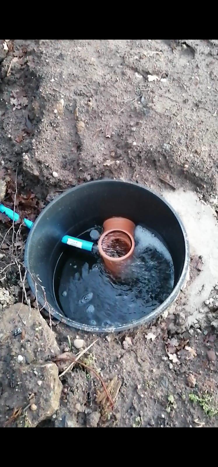

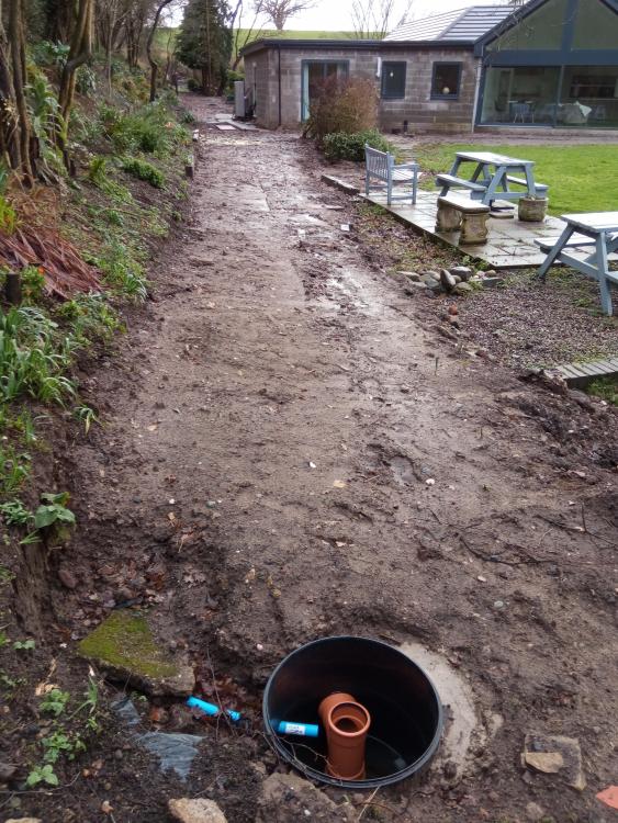

canalsiderenovation Posted January 1, 2021 Share Posted January 1, 2021 We are compiling a very long list of snags for our builder. We got in for Xmas but there are so many things still to sort .... First off, I think this is linked to our waste water as it's at the opposite end of the house to our septic tank but I'm sure that it should firstly have some form of top, secondly that piping looks a mess to me as well and I'm not even sure it's the right piping. Anyone know... Link to comment Share on other sites More sharing options...

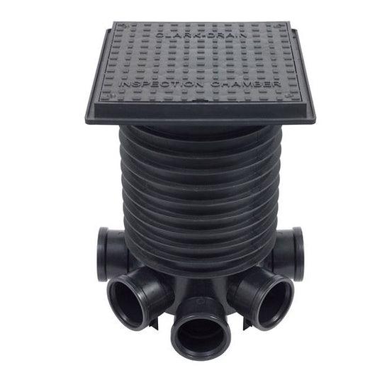

Onoff Posted January 1, 2021 Share Posted January 1, 2021 I'd expect a plastic lid to be kicking around either ground or square on these lines: Link to comment Share on other sites More sharing options...

ProDave Posted January 1, 2021 Share Posted January 1, 2021 31 minutes ago, canalsiderenovation said: There is nothing around, we have put a piece of wood over the top of it for now. Is that piping correct? Not seen anything like that. Is that water flowing out over the top of the brown pipe? What's a blue mdpe water pipe doing connecting to a drain pipe? Ask them to explain exactly what that is, and then to finish it. Link to comment Share on other sites More sharing options...

canalsiderenovation Posted January 1, 2021 Author Share Posted January 1, 2021 1 hour ago, ProDave said: . Is that water flowing out over the top of the brown pip No not over top of brown pipe. 1 hour ago, ProDave said: What's a blue mdpe water pipe doing connecting to a drain pipe? That's what I'm confused about. Link to comment Share on other sites More sharing options...

canalsiderenovation Posted January 1, 2021 Author Share Posted January 1, 2021 Ok we are a little confused as although the initial picture has water flowing from the blue pipe we don't know where it is coming from and having tried all taps, showers etc in the house that doesn't seem to have any impact. Link to comment Share on other sites More sharing options...
Onoff Posted January 1, 2021 Share Posted January 1, 2021 1 minute ago, canalsiderenovation said: Ok we are a little confused as although the initial picture has water flowing from the blue pipe we don't know where it is coming from and having tried all taps, showers etc in the house that doesn't seem to have any impact. ASHP drain? Is that the ASHP alongside the house? Link to comment Share on other sites More sharing options...
Onoff Posted January 1, 2021 Share Posted January 1, 2021 Could it be... The brown soil pipe is waste coming from the house. It goes down in that chamber then onto the septic tank. The blue comes in (from the ASHP?) and should really drain into the brown but stops short. The black chamber is just for access. Pure speculation. Link to comment Share on other sites More sharing options...
LA3222 Posted January 1, 2021 Share Posted January 1, 2021 21 minutes ago, Onoff said: Could it be... The brown soil pipe is waste coming from the house. It goes down in that chamber then onto the septic tank. The blue comes in (from the ASHP?) and should really drain into the brown but stops short. The black chamber is just for access. Pure speculation. That first picture appears to have a fair bit of flow coming out of the blue pipe? More than you would expect to come from ASHP condensate? God alone knows what is going on with this?♂️ Link to comment Share on other sites More sharing options...
SuperJohnG Posted January 1, 2021 Share Posted January 1, 2021 Yeah thats a lot of flow by the looks of it. I assume its not constantly flowing? Link to comment Share on other sites More sharing options...
canalsiderenovation Posted January 1, 2021 Author Share Posted January 1, 2021 30 minutes ago, SuperJohnG said: Yeah thats a lot of flow by the looks of it. I assume its not constantly flowing? Nope infact today we spent quite a while trying to get it to flow with no success and neither of us know what was making it flow yesterday. Link to comment Share on other sites More sharing options...

Mr Punter Posted January 1, 2021 Share Posted January 1, 2021 Is it pumped from somewhere? Overflow from a soakaway or a well? All will be revealed when the builder returns... Link to comment Share on other sites More sharing options...
PeterW Posted January 1, 2021 Share Posted January 1, 2021 I think it may be the pumped outflow from the sewage treatment plant , the brown will be the start of the leach field. 2 Link to comment Share on other sites More sharing options...
SuperJohnG Posted January 1, 2021 Share Posted January 1, 2021 6 hours ago, PeterW said: I think it may be the pumped outflow from the sewage treatment plant , the brown will be the start of the leach field. I was thinking that. But had thought this was going to the sewage treatment plant. That would make sense (and could be the only logical answer!) That ita a pumped tank. Link to comment Share on other sites More sharing options...
canalsiderenovation Posted January 1, 2021 Author Share Posted January 1, 2021 14 minutes ago, SuperJohnG said: I was thinking that. But had thought this was going to the sewage treatment plant. That would make sense (and could be the only logical answer!) That ita a pumped tank. 6 hours ago, PeterW said: I think it may be the pumped outflow from the sewage treatment plant , the brown will be the start of the leach field. You both could be right. The septic tank/sewage treatment plant is further up and is just before that connifer in the distance and is pumped. Link to comment Share on other sites More sharing options...
Gus Potter Posted January 1, 2021 Share Posted January 1, 2021 Hats off to all. Great "Columbo" work. Here is my go. Could it be the sampling chamber before all discharges in to the "Canal" Link to comment Share on other sites More sharing options...
