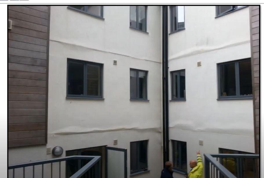

Jason L Posted December 9, 2020 Author Posted December 9, 2020 13 minutes ago, MarkyP said: Looks like others beat me to it, must type faster! Thank you, it looks like you posted the same twice haha Im getting nervous as i watched a presentation on it yesterday with the same construction as mine and they said the timber frame will move as it dries out etc so they are needed. However they didn't really go into where, and it just seemed like a selling their render product presentation in the end. I have asked K rend to email me some tech info which they haven't done.

Mr Punter Posted December 9, 2020 Posted December 9, 2020 Nobody read the original thread very carefully. You may want to take advice from the carrier board people. The Bluclad BBA certificate says: 13.7 Horizontal movement joints must be provided at every floor to accommodate vertical shrinkage of up to 6 mm in the timber frame and to follow movement joints in the substructure. For steel-frame structures, reference should be made to the Structural Engineer’s details for detection at floor level and movement joints in the substructure. 13.8 Vertical movement joints should be provided at the required intervals. The actual spacing and position of the joints will be determined by the shape of the area to be rendered and should coincide with movement joints in the structure and allow for the same degree of movement. 1
Bitpipe Posted December 9, 2020 Posted December 9, 2020 I have a Parex render system (topcoat / base coat / mesh / base coat / renderboard / batten) on a TF wall and no expansion gaps were specified. I have had a lot of issues - render pillowed up and boards under are now cracked. Company committed to fix it. Initially I was worried that it was due to no expansion gap (which were not in design) but then find out none were needed. Instead it's incorrect fixing of battens to structural timber in the frame so they were able to pull through the outer skin.

ProDave Posted December 9, 2020 Posted December 9, 2020 5 hours ago, Jason L said: Yes cheers. ill have a look for that thread laters. i cant remember if i spoke to the carrier board manufacture, but i can try them. This presentation that i watched put up a couple of scare pictures such as this one ! What is the back story there? What was the cause for the failure? Link to anything describing it (I still have some issues with my rendering, also the Baumit system)
Jason L Posted December 9, 2020 Author Posted December 9, 2020 52 minutes ago, ProDave said: What is the back story there? What was the cause for the failure? Link to anything describing it (I still have some issues with my rendering, also the Baumit system) Sorry I don’t know anything about that, other than it was one of the photos the presentation showed of issues that is caused without movement joints. What are your issues ?
