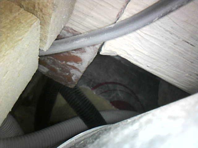

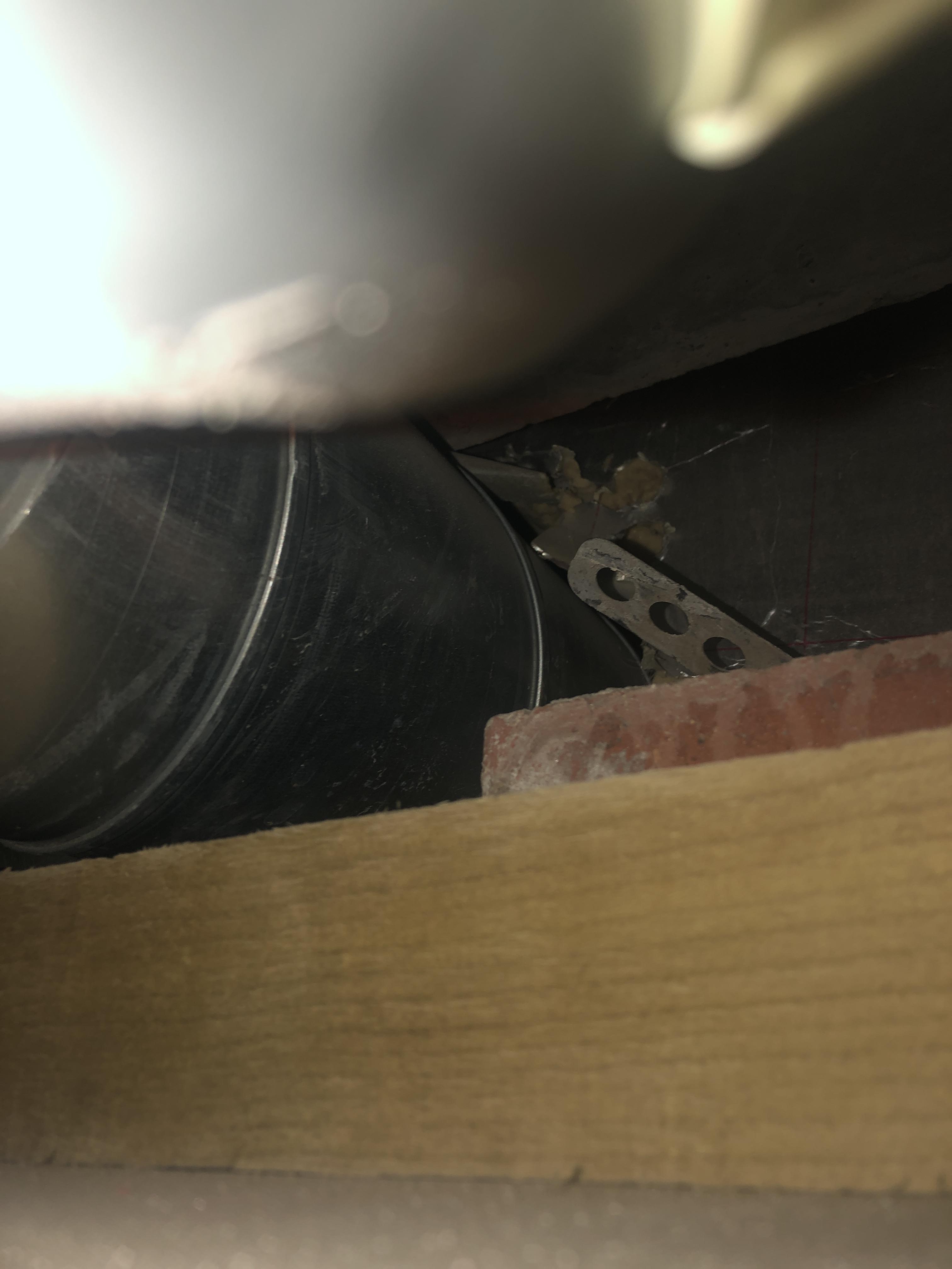

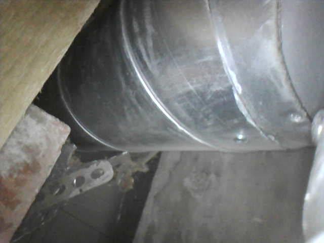

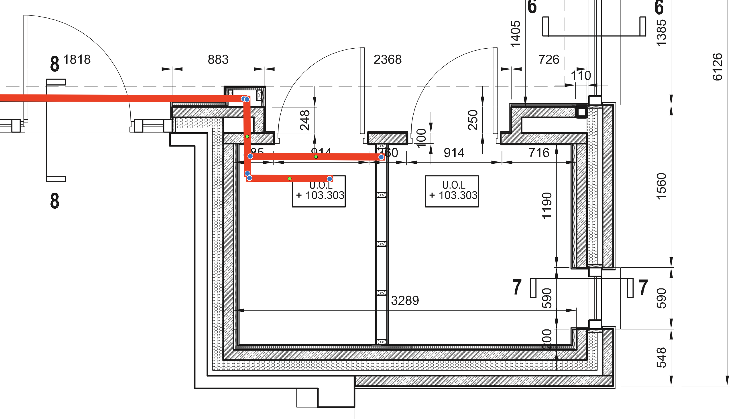

AliG Posted January 13, 2021 Author Share Posted January 13, 2021 OK, got my hole saw. Scary thing to use as the blade keeps turning after you stop the drill and even more scary using it just above your head. I stopped with the hole 90% cut and finished off with a knife. Found the issue. I also ordered an inspection camera for £30 off Amazon and that is helping. The MVHR has to come round a sharp corner and through the Porotherm wall to get from the hall to the WC, it runs above head height in the space between the ground and first floor windows.. They took out the two corner Porotherm blocks and assumed that the PIR behind them was enough to stop draughts. But of course it is not tight in any way. Trouble is, it is such a massive hole, I am not sure how to fill it. Link to comment Share on other sites More sharing options...
AliG Posted January 13, 2021 Author Share Posted January 13, 2021 I have know there was an issue here for some time. Other places where the MVHR is taken through the Porotherm it was sealed. Here, however, I think the builders thought it was an inside wall so left it, but it connects to the outside cavity. Link to comment Share on other sites More sharing options...
