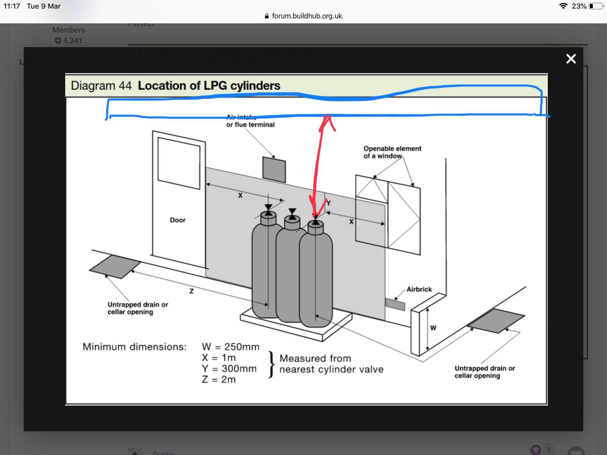

Temp Posted December 3, 2020 Share Posted December 3, 2020 (edited) Diagram 44 Page 67 of part j shows that the opening part must be 300mm vertically or 1m horizontally AND shows that a non opening part of the window can be nearer. Edited December 3, 2020 by Temp 2 1 Link to comment Share on other sites More sharing options...
Nickfromwales Posted December 4, 2020 Share Posted December 4, 2020 Dave. We’ve put flues through baffled sections of non opening windows before, blanking them with non-combustible material and intumescent mastic type seal to complete the picture. The reason they don’t show a non-opening window is because they don’t care about a non-opening window. Carry on with the 47’s and tell your BCO to suck it. 2 Link to comment Share on other sites More sharing options...
ProDave Posted December 4, 2020 Author Share Posted December 4, 2020 10 hours ago, Temp said: Diagram 44 Page 67 of part j shows that the opening part must be 300mm vertically or 1m horizontally AND shows that a non opening part of the window can be nearer. Perfect Not only does it show a non opening window, it also males it clear the distances are measured from the gas valve on the cylinder, not the top of the handle. So I suspect I would be okay even if my windows opened. So I will proceed on that basis that I now have a pretty picture to show BC when they object and grounds to argue it. 1 Link to comment Share on other sites More sharing options...

Russell griffiths Posted March 9, 2021 Share Posted March 9, 2021 Starting this back up. I have a couple of issues raised this morning when the gas man turned up to look at sticking in my lpg pipework. The first one is the distance vertically to a combustible material, my house is a bungalow and he was concerned about the height from the top of cylinders to the soffit and facia board, my soffit is timber, I cannot find any drawings that say anything about the actual fabric of the building is more about openings. Please see pic. Any thoughts @ProDave Link to comment Share on other sites More sharing options...
ProDave Posted March 9, 2021 Author Share Posted March 9, 2021 I would ask him to show you the regulation that is concerning him. Is he worried about a leak, ignited, and a flame out the top of the cylinder? 1 Link to comment Share on other sites More sharing options...
markc Posted March 9, 2021 Share Posted March 9, 2021 I think he is talking rubbish, unless he is looking at combustible materials above a cooker or appliance rather than the bottles 2 Link to comment Share on other sites More sharing options...
joe90 Posted March 9, 2021 Share Posted March 9, 2021 That diagram (grey area) extends 300mm above cylinder only. As @ProDave says, ask him to recite the regs to which he is referring! Link to comment Share on other sites More sharing options...
