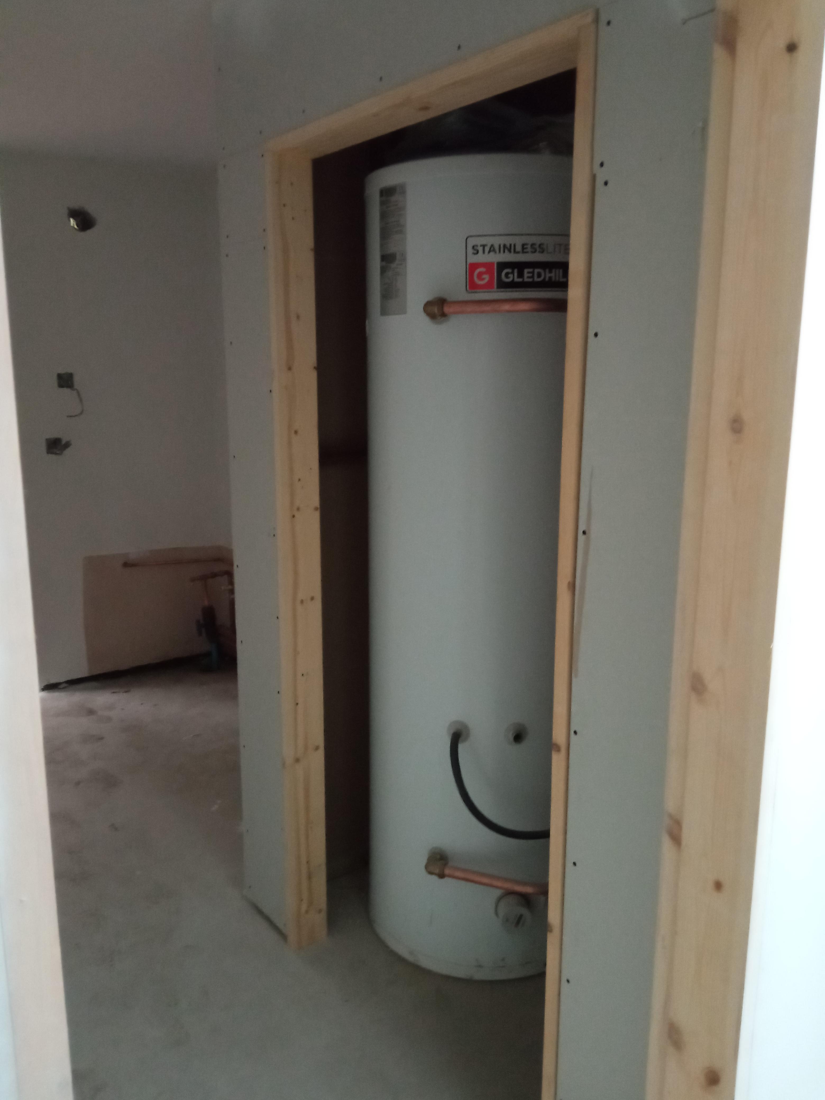

ZacP Posted November 29, 2020 Author Share Posted November 29, 2020 (edited) 33 minutes ago, PeterW said: 400 tall larder, 800 sink base then a washing machine and tumble dryer side by side - bridge over the whole lot if you really want more cupboard space. Utility will give you access to the drain for the PRV and will keep things tidy. Think @canalsiderenovation is doing something very similar. That’s why I was v interested in their posts on this! I’ll have to convince my wife, a decent size utility was relatively high on her list... prv? Pressure release valve as a guess this for a vented cylinder? On a similar/separate note could you put fuse boards etc in this mini-plant-room? Or would it get too hot? Edited November 29, 2020 by ZacP Link to comment Share on other sites More sharing options...
canalsiderenovation Posted November 29, 2020 Share Posted November 29, 2020 (edited) 1 hour ago, PeterW said: 400 tall larder, 800 sink base then a washing machine and tumble dryer side by side - bridge over the whole lot if you really want more cupboard space. Utility will give you access to the drain for the PRV and will keep things tidy. Think @canalsiderenovation is doing something very similar. Yes, we have all of our stuff in our utility and it's been studded in. It has meant we have less space than we thought (2125 in total now) but will fit an 800 base unit (because we have gone for a large sink) and then a washer and dryer with some narrower units above (kind of like bridging units as we already have one 900mm spare from our main kitchen so just going to put a 600mm bridging either side) as we didn't want anything too low over our sinks (hot/steamy water). You can see the 'before' it was boxed in pics on a post on here. Edited November 29, 2020 by canalsiderenovation Link to comment Share on other sites More sharing options...
ZacP Posted November 29, 2020 Author Share Posted November 29, 2020 1 minute ago, canalsiderenovation said: Yes, we have all of our stuff in our utility and it's been studded in. It has meant we have less space than we thought but will fit an 800 base unit (because we have gone for a large sink) and then a washer and dryer with some narrower units above (kind of like bridging units) as we didn't want anything too low over our sinks (hot/steamy water). You can see the 'before' it was boxed in pics on a post on here. I followed your utility post @canalsiderenovation! Think we may be going down the same route... what size cylinder is that? Link to comment Share on other sites More sharing options...
canalsiderenovation Posted November 29, 2020 Share Posted November 29, 2020 (edited) 6 minutes ago, ZacP said: followed your utility post @canalsiderenovation! Think we may be going down the same route... what size cylinder is that? 400l is the tank size which was recommended by a couple of people on here as we have a PV and a solar immersion solic 200. Our fuse/consumer unit and UFH piping manifold is all in a store cupboard just outside the utility door and whilst I'd of preferred this extra space to be in the utility for vacuum/mop etc it's quite a large stud cupboard so will probably end up with a couple of coats, etc in it as well and we just couldn't fit everything in one place without taking up too much room. There was also lots of debate about the manifold being in the centre of the house. Edited November 29, 2020 by canalsiderenovation Link to comment Share on other sites More sharing options...

ZacP Posted December 7, 2020 Author Share Posted December 7, 2020 (edited) Ok, so slight switch in thoughts... how does everyone feel about just ditching the whole ASHP/hot water cylinder thing and sticking with a plain simple mains gas combi? I know it’s not as brilliantly environmentally friendly, but the installation costs I assume will be much lower and running costs can’t be that much more expensive?!? Plus space saving.... Edited December 7, 2020 by ZacP Link to comment Share on other sites More sharing options...
Gone West Posted December 7, 2020 Share Posted December 7, 2020 2 hours ago, ZacP said: Ok, so slight switch in thoughts... how does everyone feel about just ditching the whole ASHP/hot water cylinder thing and sticking with a plain simple mains gas combi? Something I would certainly consider if mains gas was an option. Other factors to take into account though. Link to comment Share on other sites More sharing options...
ZacP Posted December 7, 2020 Author Share Posted December 7, 2020 (edited) 2 hours ago, PeterStarck said: Something I would certainly consider if mains gas was an option. Other factors to take into account though. It is available yes. what other factors am I missing? Edited December 7, 2020 by ZacP Link to comment Share on other sites More sharing options...
Gone West Posted December 7, 2020 Share Posted December 7, 2020 6 minutes ago, ZacP said: what other factors am I missing? How many showers are likely to be taken at the same time. Combis not the best for continuous large volumes of hot water. Link to comment Share on other sites More sharing options...
PeterW Posted December 7, 2020 Share Posted December 7, 2020 20 minutes ago, ZacP said: It is available yes. what other factors am I missing? combi won’t run UFH without a buffer tank so you’ll need space for that somewhere. You’ll also need a big combi to get decent water flow - WB CDI30 or similar so won’t be change of £2k installed. Also needs an annual service to keep the warranty, so lifetime costs are not cheap. Link to comment Share on other sites More sharing options...
Dave Jones Posted December 7, 2020 Share Posted December 7, 2020 7 minutes ago, PeterW said: combi won’t run UFH without a buffer tank so you’ll need space for that somewhere. You’ll also need a big combi to get decent water flow - WB CDI30 or similar so won’t be change of £2k installed. Also needs an annual service to keep the warranty, so lifetime costs are not cheap. thats wrong. A tankless combi ran o0ur first builds UFH for many years no problem. Link to comment Share on other sites More sharing options...
PeterW Posted December 7, 2020 Share Posted December 7, 2020 4 minutes ago, Dave Jones said: thats wrong. A tankless combi ran o0ur first builds UFH for many years no problem. A 30KW combi will not modulate down far enough, and will short cycle to death and not condensate at modern UFH temperatures. It physically isn’t possible as the flow rates are too low to sustain for UFH, and the condensate level is too high. Fact. An older, less insulated and higher UFH flow temp house may support this, but that isn’t what we are talking about, so this is like comparing apples and giraffes. 1 Link to comment Share on other sites More sharing options...
