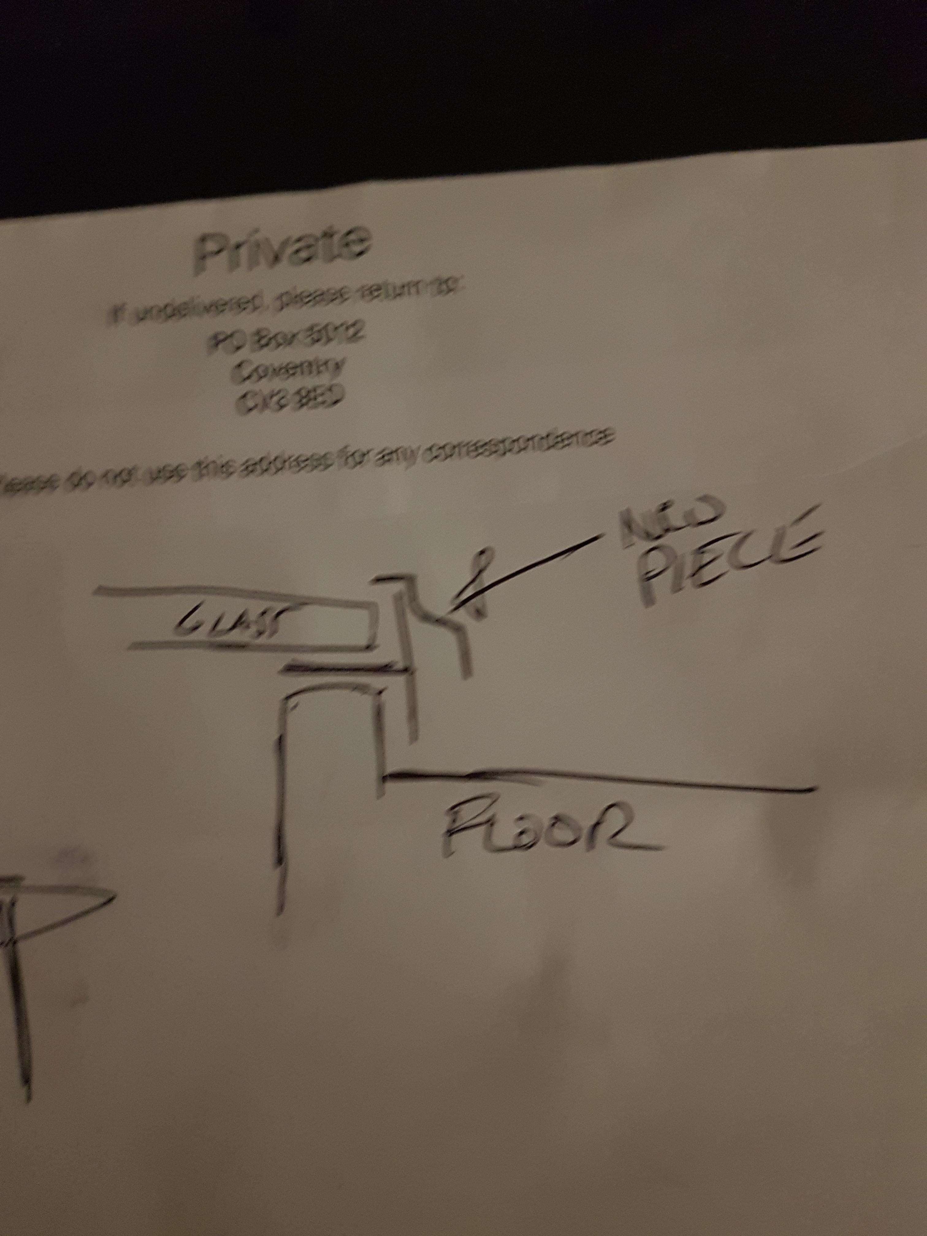

Oz07 Posted November 20, 2020 Share Posted November 20, 2020 If it is deffo getting in under there because of a gap in silicone could you 're seal from underneath with a 90 nozzle or whatever then get some metal skirts made to introduce a wider drip. These could overlay the glass by 20mm and cover that black edge. I hope that black isn't the glazing compound uv light breaks it down 1 Link to comment Share on other sites More sharing options...

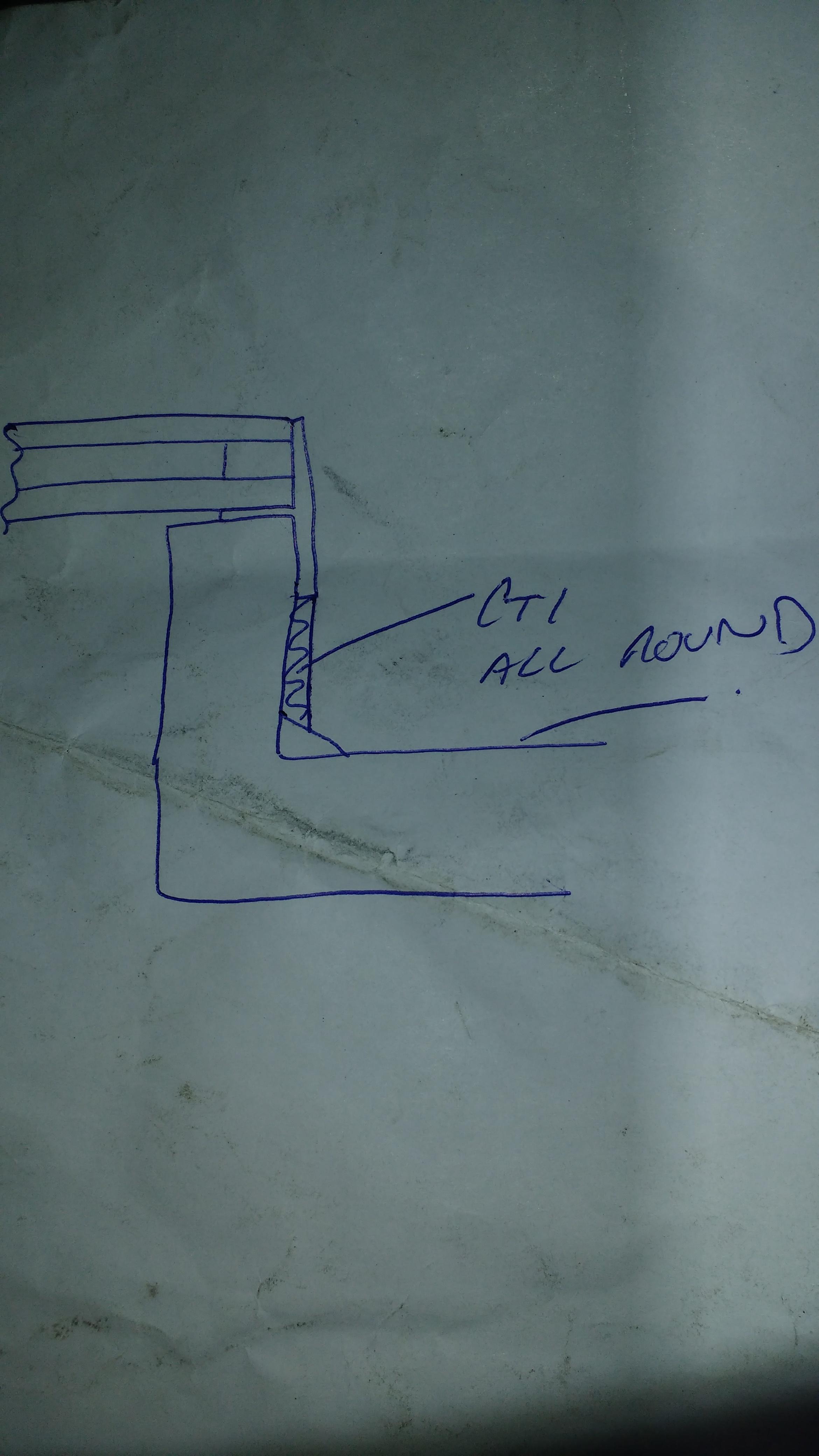

Onoff Posted November 20, 2020 Share Posted November 20, 2020 I don't like that mitred joint in the felt where the little plant is growing by the corner. Is that the corner where the leak is? Nothing lost going over those joints with some clear CT1 and rubbing it in well. I'd be saying f*** it and doing this then taking the excess off with a Fugi tool. 1 Link to comment Share on other sites More sharing options...

Pocster Posted November 20, 2020 Author Share Posted November 20, 2020 9 minutes ago, Oz07 said: If it is deffo getting in under there because of a gap in silicone could you 're seal from underneath with a 90 nozzle or whatever then get some metal skirts made to introduce a wider drip. These could overlay the glass by 20mm and cover that black edge. I hope that black isn't the glazing compound uv light breaks it down Another good plan . The black is structural silicone as recommended by the glazing firm . Link to comment Share on other sites More sharing options...
Pocster Posted November 20, 2020 Author Share Posted November 20, 2020 2 minutes ago, Onoff said: I don't like that mitred joint in the felt where the little plant is growing by the corner. Is that the corner where the leak is? Nothing lost going over those joints with some clear CT1 and rubbing it in well. I'd be saying f*** it and doing this then taking the excess off with a Fugi tool. Yeah - it’s also a good plan Remember the felt is just a protective layer . The firm who did the roof properly said I didn’t need it . It’s just to protect the bituminous layer . But is ct1 really that good outdoors in all weathers forever ?? Link to comment Share on other sites More sharing options...

Onoff Posted November 20, 2020 Share Posted November 20, 2020 12 minutes ago, pocster said: Yeah - it’s also a good plan Remember the felt is just a protective layer . The firm who did the roof properly said I didn’t need it . It’s just to protect the bituminous layer . But is ct1 really that good outdoors in all weathers forever ?? Dow Corning 791 & 795 are the weapons of choice on most commercial curtain walling I see. 1 Link to comment Share on other sites More sharing options...
