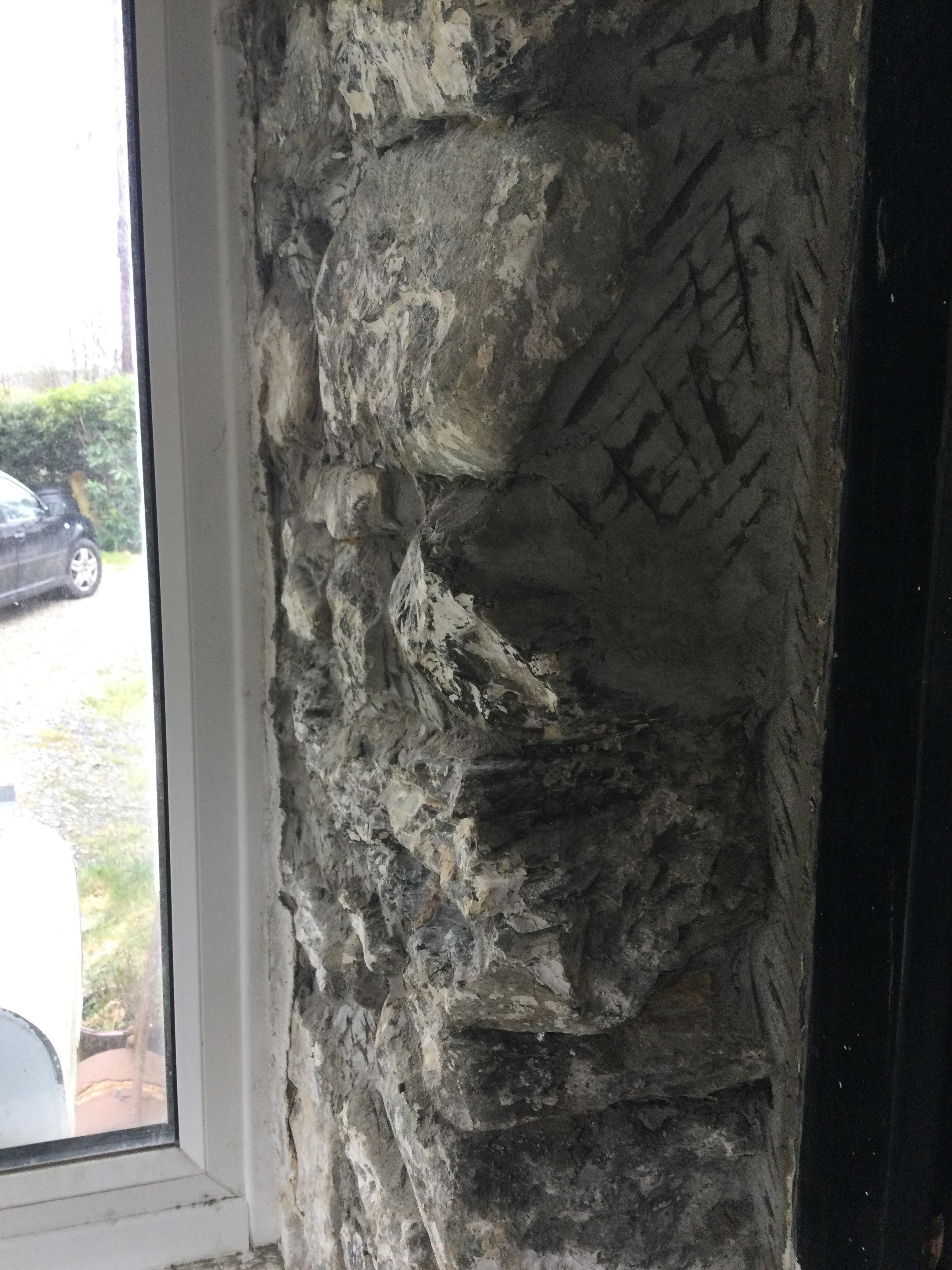

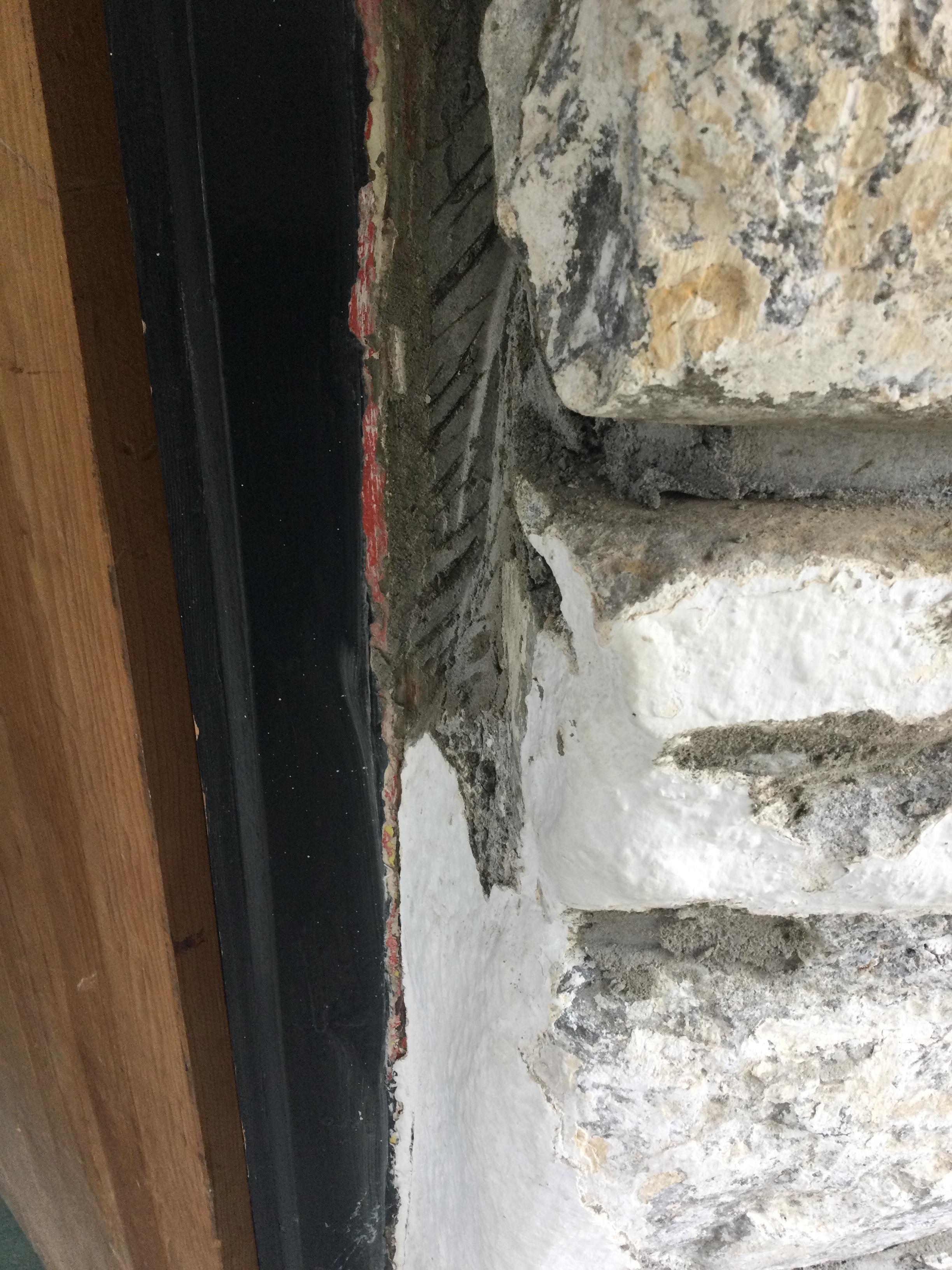

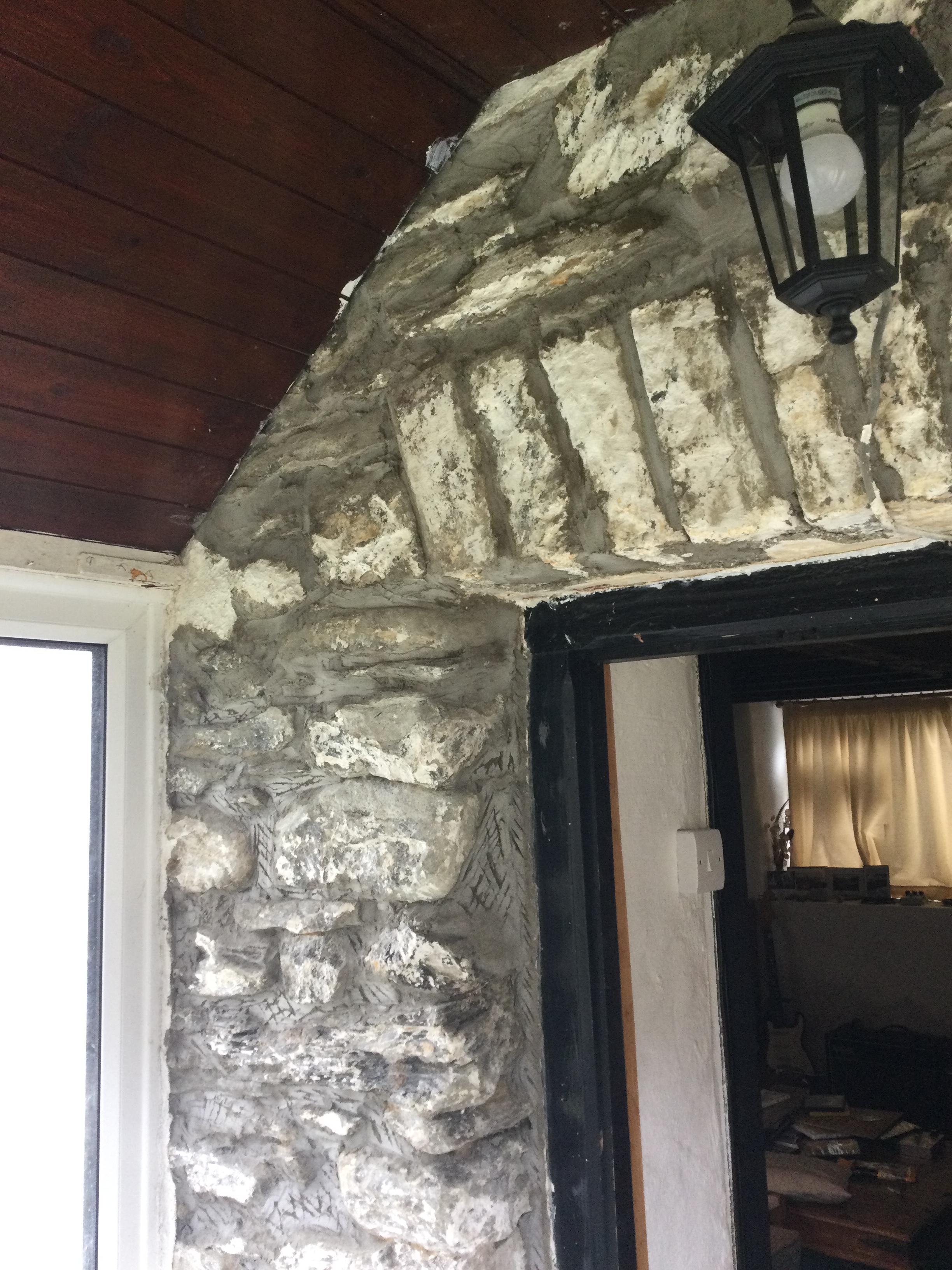

zoothorn Posted April 8, 2021 Author Share Posted April 8, 2021 Sorry the pics aren't too clear.. Could someone help me out? I'm not sure how long after my 1st repoint layer (of 4:1) I can put the 2nd layer? I needed 2 layers (or "passes" I dont know the right term) because the depth was so big between my stone. I think that was the right idea. So it's been 3 days curing. Also how long does a bag of cement last, opened? do I need to store it in an airtight bag? thanks- zH Link to comment Share on other sites More sharing options...
markc Posted April 8, 2021 Share Posted April 8, 2021 You could have done it in one go, but likely to sag. A day or so is more than enough time for the infil. Cement will last indefinitely as long as it doesnt get damp, Roll down the top of the bag to expell the air and it will last weeks/months Link to comment Share on other sites More sharing options...
joe90 Posted April 8, 2021 Share Posted April 8, 2021 Don’t stress, it’s a cottage, stuff like that is called “character “. Just tidy it up, don’t render over all the stone as that needs to breathe. When I do stuff like that I tend to finish it off with a brush when it’s nearly hard. Not too hard a bristle, paint brush will do, evens out the trowel marks and gives a rustic finish, which is what “cottage” is all about IMO ?. I have cement in my container 6 months old and still usable as it’s kept in the dry, top rolls down and a brick on it. Link to comment Share on other sites More sharing options...
zoothorn Posted April 8, 2021 Author Share Posted April 8, 2021 3 hours ago, markc said: You could have done it in one go, but likely to sag. A day or so is more than enough time for the infil. Cement will last indefinitely as long as it doesnt get damp, Roll down the top of the bag to expell the air and it will last weeks/months Ah thank goodness. I can crack on with the 2nd 'coat' this wknd then. I hate wasting 20kg of cement you see/ so that's good, I might use asap after for another mortar job. Thx markc Link to comment Share on other sites More sharing options...
zoothorn Posted April 8, 2021 Author Share Posted April 8, 2021 3 hours ago, joe90 said: Don’t stress, it’s a cottage, stuff like that is called “character “. Just tidy it up, don’t render over all the stone as that needs to breathe. When I do stuff like that I tend to finish it off with a brush when it’s nearly hard. Not too hard a bristle, paint brush will do, evens out the trowel marks and gives a rustic finish, which is what “cottage” is all about IMO ?. I have cement in my container 6 months old and still usable as it’s kept in the dry, top rolls down and a brick on it. No good point. Doing every job the 1st time (mixing mortar- my 1st effort) innevitably means stress.. I convince myself it's all wrong & you lot are laughing at me. its a confidence thing. There's character.. & a crap diy job though joe: I chipped off one crap '80's diy job, to only then replace it with another wasn't on the job sheet! I'm worrying close to this outcome as it is- so I need to up my game & tart up the remainder of the job best I can. The reveals where I chipped off a 1" thick cementy-covering "render" needs consideration: I wonder whether I need a new "render" layer to replace it, after doing the 4:1 point job. I back filled the large voids around frame ok (builder told me just use mortar/ ok) so I sort of have a base layer to create new reveal bits. Ok one thing that did occur, is why I didn't buy hydrated lime (looked on ebay today, 1kg £10) & put into my 4:1 mix, to make "lime mortar" more affordably than the suggested 3x £30 tubs.. but anyway a bit late now. Or maybe I'm not understanding what constitutes "lime mortar" (or the difference between this, & render, which has lime in 6:1:1 ?). I'm so new to all this you see: I try googling prior to asking on here but it's still not clear to me even still. Thanks zoot Another Link to comment Share on other sites More sharing options...
zoothorn Posted April 10, 2021 Author Share Posted April 10, 2021 Hi- if anyone could help. I'm about to do my 2nd layer of mortar between the stone. Once this is done, I still have the reveals to do: but I don't think mortar is correct for here, I think a render is (tho I might be wrong- I'm just making a guess I must admit). Can I make render with the two materials I have (sand, cement), plus buying say a small ammount of 'hydrated lime'.. to make render of 6:1:1 ? Am I on the right track with this idea? I don't think, so far as I can establish, that using my mortar mix as a render for the reveals is correct. Thanks- zoot Link to comment Share on other sites More sharing options...

joe90 Posted April 10, 2021 Share Posted April 10, 2021 I would not worry about the lime fir the second coat as the first had none, it does make the mix a bit more easy to use but you could add a little plasticiser to it to do the same job. 1 Link to comment Share on other sites More sharing options...

joe90 Posted April 13, 2021 Share Posted April 13, 2021 @zoothorn, yes lime is best fir old stone buildings but as this is such a small area, in a porch and not covering the stone just go with 4:1 and a little plasticiser if you have any, it’s such a small area it’s not going to cause global warming/fall down. It sounds like your old barn was lime, it takes much longer to go off which is why you brushed it the next day. Using 4:1 sand cement will go off much faster so you need to brush it off after 1 or 2 hours with a fairly soft brush, it will still be wet enough to not be dusty but solid enough to not fall out/leave large marks. Crack on mate ? Link to comment Share on other sites More sharing options...
