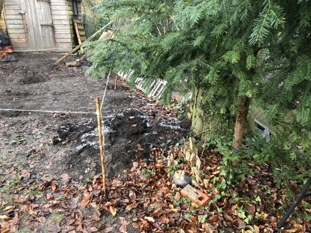

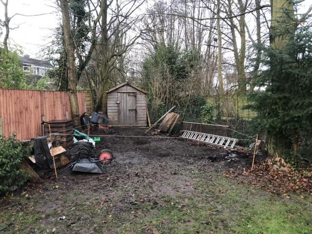

I’ve dug out the old shed base and have made a rough guess of where the cabin will sit.
the ground is pretty claggy clay and full of root matter from when the garden was completely overgrown. There’s close proximity to a couple of tree, a slight fall left to right and on the right hand side behind the tree and chain link fence it is the bank of a stream. We’ve not had flooding but the highest stream level came up to the base of the chain link fence, approx 100mm below the ground level there.
At the front right corner, I think I’m going to remove the small pine tree and the foundation will run about 1m away from the big tree.
At the rear left corner, it’s currently only about 0.4m away from the tree which I imagine will be a little close. I think I will be able to move the position forward a little and rotate around the front right to bring that rear left corner away from the tree.
I’m still at a loss as to what sort of base to build. My wife wants a concrete slab but I want it properly insulated. I will struggle to build something straight and level
enough.
I’m not looking for something super insulated, it’s a 45mm thick log cabin and I won’t be insulating the walls, only the floor and roof. It’s not going to be used all the time so I’m wondering if it would be a mistake to include the slab in the thermal
envelope as it will always need heating up when we use it. Whereas a cold slab with insulation on top with a floating floor might be warmer?
But I wouldn’t want it to literally float if there was a flood ?
I’m looking for the lowest skilled solution.
Edited by daiking
