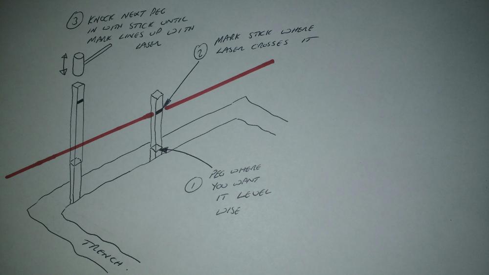

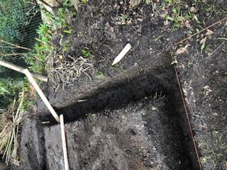

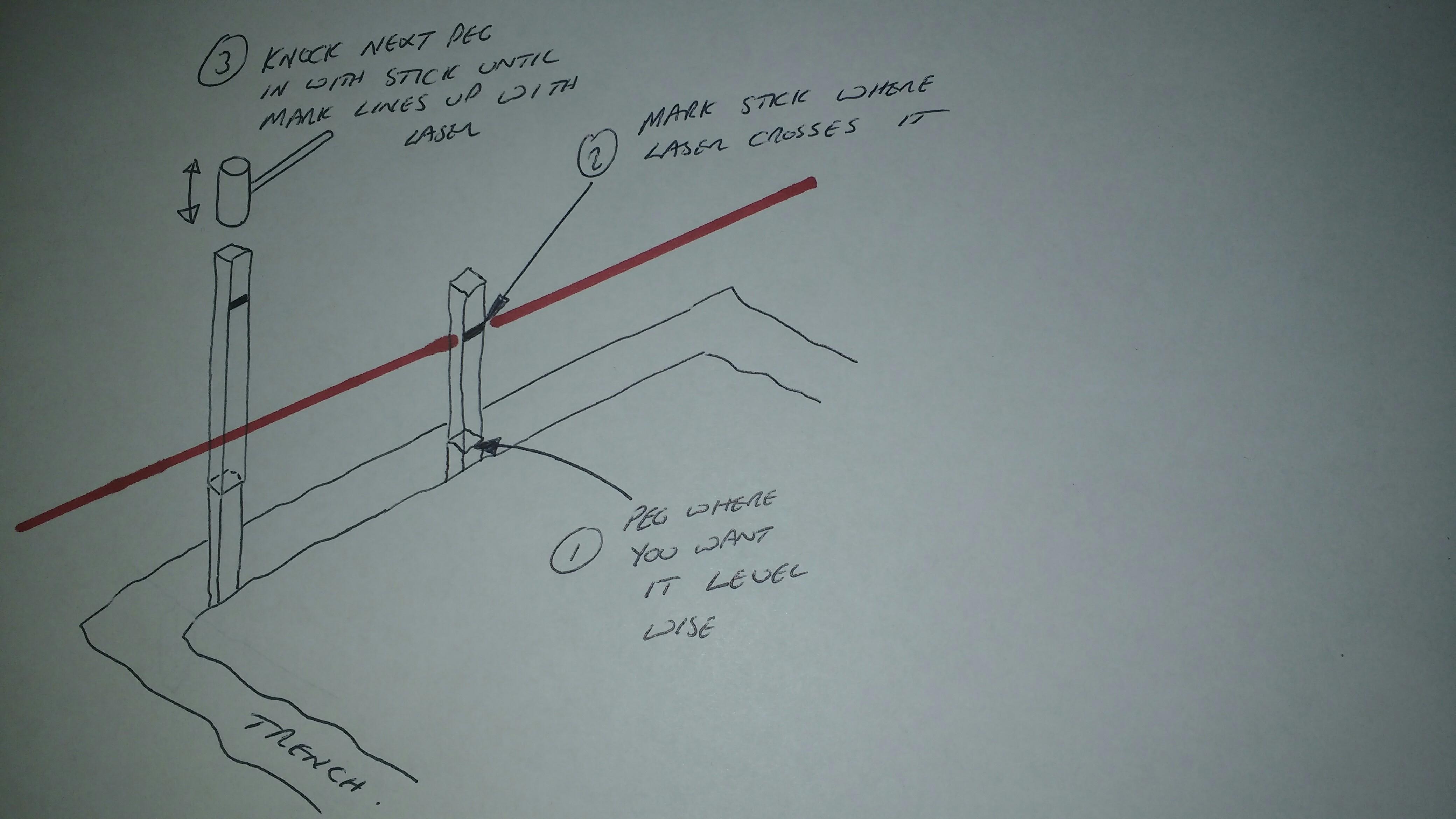

I think I’m dug out now. No idea on the level of the trench (I was wrong).
With nothing in particular to use I decided to pick the high point of external ground and hammer stakes into the bottom of the trench with the planned 150mm concrete depth marked on it.
Then banged in another stake to the same level 850mm along the trench (I only had a 900mm level) worked my way round with lots of stakes and when I got back to the start, I did not have the same level ?.
I was planning on getting a 1800mm level anyway so got it. Did the same again and whilst the levels were a lot closer, was still a few mm out.
so I’m expecting the concrete man to come and fill the trench with concrete up to the level of the top of the pegs. The variation in the level of the concrete will need to be overcome by the mortar bed under the concrete blocks.
fingers crossed eh?
fingers crossed eh?
Shouldn't sweat it for a few mm. (A concrete poker would level it out pretty good). Cheap laser level is good for pegging out.

This is precisely what I've tried to do with a traditional level.
hit the peg, check the level, hit the peg, check the level, hit the peg, check the level, just a little bit more, (expletive deleted), too low. Pull it out and do it again, ad infinitum.
The laser is the constant.
