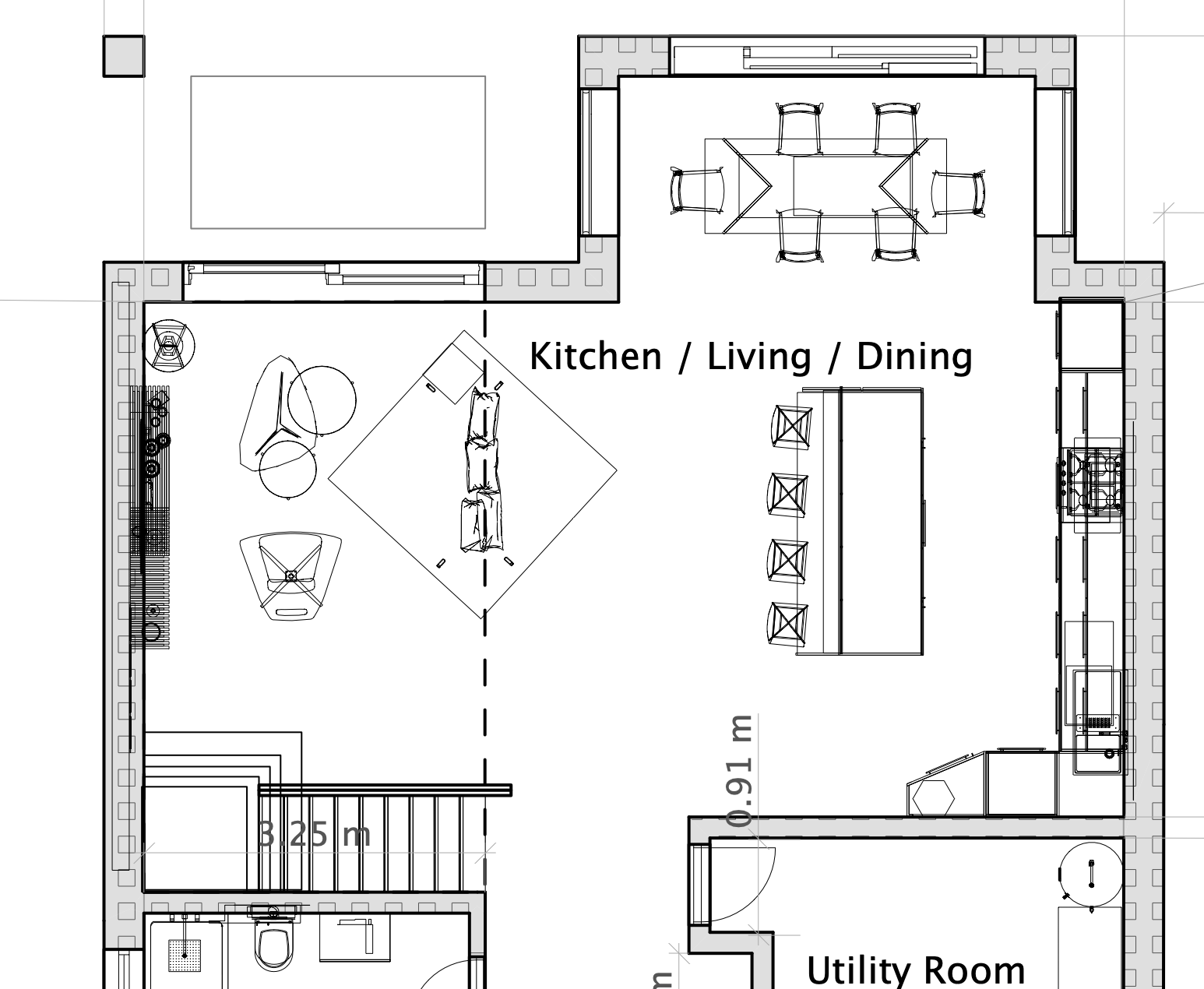

BartW Posted November 15, 2020 Share Posted November 15, 2020 Hi, I am specifying the intermediate floor pozi joists for our build, and read on Mitek's website the max permissible deflection is length / 250 = mm. Their product brochure seems to suggest various joists choices and sizes with varied spacing and deflection. Is there a practical maximum below the manufacturer's guidelines that the SE is likely to accept? I am having a 6 metre unsupported span above the living room, and I am trying to foresee the route (and the joist heights) I might have to take. Also, is there a robust cantilever detail that one would be able to suggest for the front corner first floor bedroom and "porch" overhangs? The house will be built out of Durisol ICF. I am trying to predict and resolve any structural engineering issues to ensure I will not have to later change my planning due to prohibitive cost, or complexity of one solution over another. Link to comment Share on other sites More sharing options...

BartW Posted November 16, 2020 Author Share Posted November 16, 2020 So, when I specify 5700mm span between the Utility and the extension wall, that is just under 5700mm. 254mm high achieves just under 12mm @ 400mm centres. Equally, a 304mm gets it down to 8mm deflection. I agree that perhaps introducing a bean midspan could take away some of the loading. As for cost, I suppose handling a 3m joist is more of a two people job than handling 6metres. Obviously the contrary goes for the steel beams depending on their size x weight. Handy calculator can be seen here: https://www.mitek.co.uk/span-calculator/ Link to comment Share on other sites More sharing options...

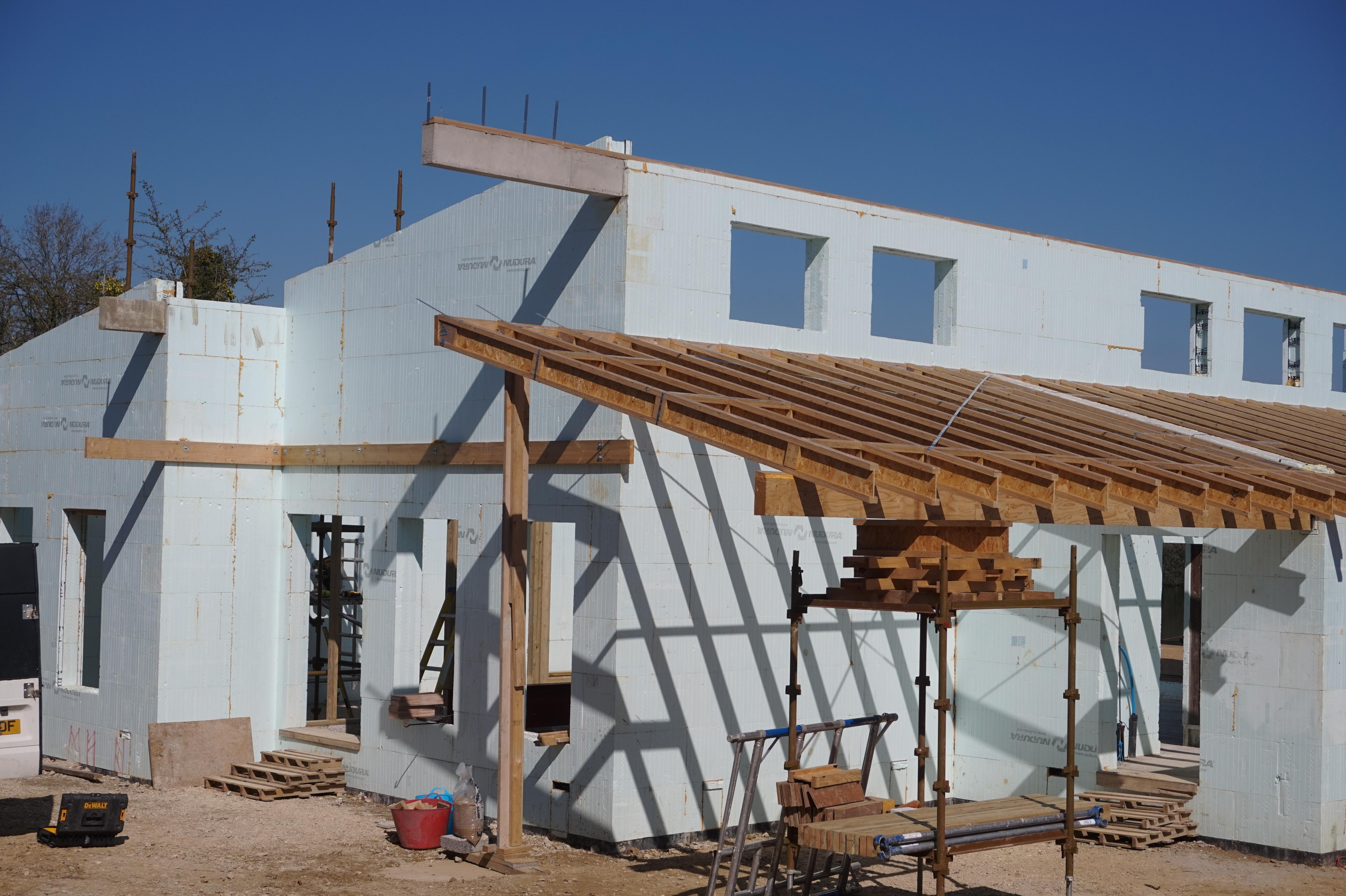

Russell griffiths Posted November 16, 2020 Share Posted November 16, 2020 (edited) I have got some fairly serious cantilever sections holding my roof up, it is all formed out of the concrete core of the icf, so lots of reinforcement inside the icf then a concrete beam was formed using shuttering plywood, pored the concrete and removed the plywood leaving a concrete beam poking out. Mine are just straight out arms but I have seen a ring beam configuration done the same way. Edited November 16, 2020 by Russell griffiths Link to comment Share on other sites More sharing options...
