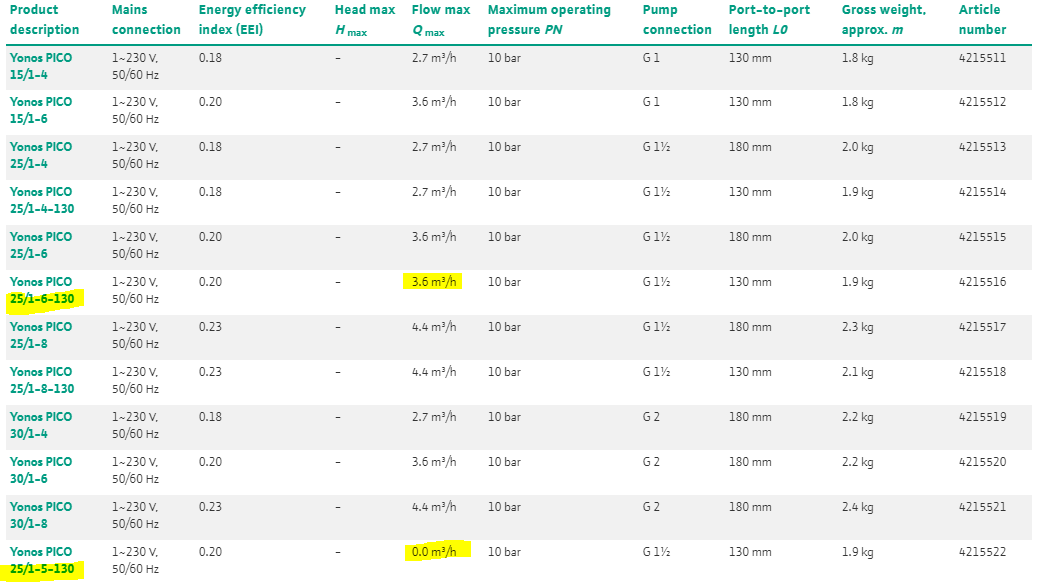

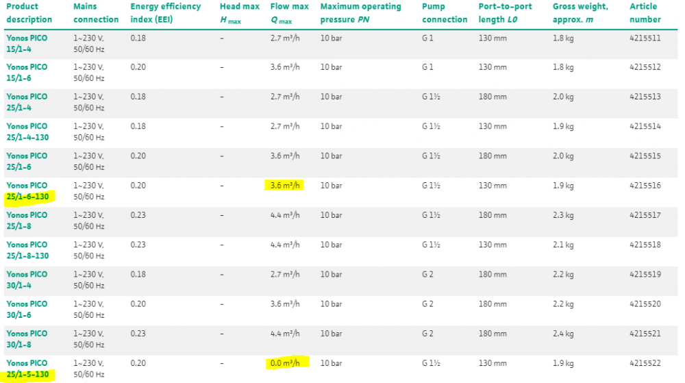

oranjeboom Posted November 13, 2020 Author Posted November 13, 2020 Hope you got (your?) disasters sorted out @Nickfromwales!! Should have stayed at home seeing it's the 13th today! The very reason I won't do any plumbing today whilst I wait for the vinegar to do it's stuff on the willis heaters. I just bought the more expensive Wilo ("Green button technology") - overkill? I could get the other cheaper one if there's nothing in it to recoup a couple of beers. https://www.screwfix.com/p/wilo-yonos-pico-25-1-6-130-glandless-circulating-pump-230v/6153x 6m Max. Delivery Head vs 5m on the cheaper one. Not sure the flow max is correct on the more expensive unit: Thank-you!
PeterW Posted November 13, 2020 Posted November 13, 2020 For anyone looking for cheap Wilo pumps for this sort of stuff, Toolstation have got the 5/130 at change of £90 https://www.toolstation.com/wilo-yonos-pico-circulating-pump/p75983

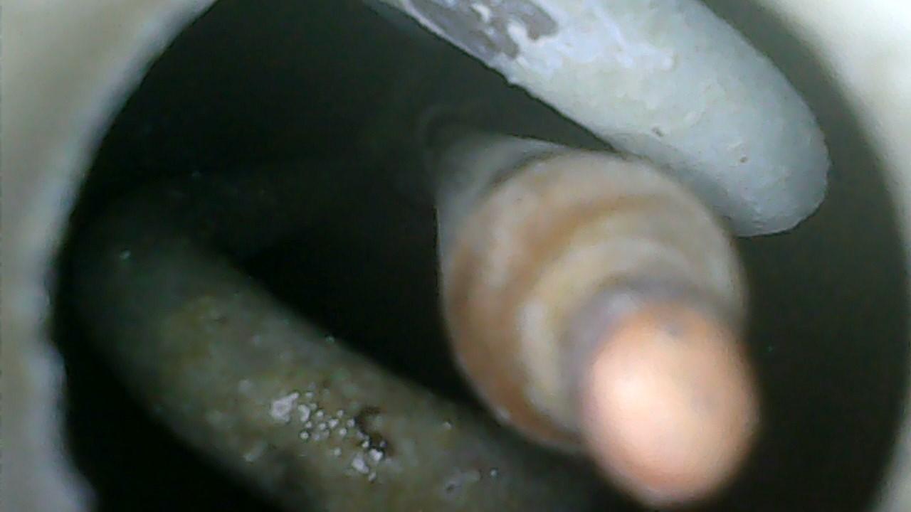

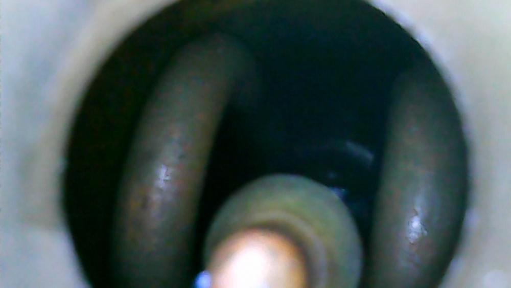

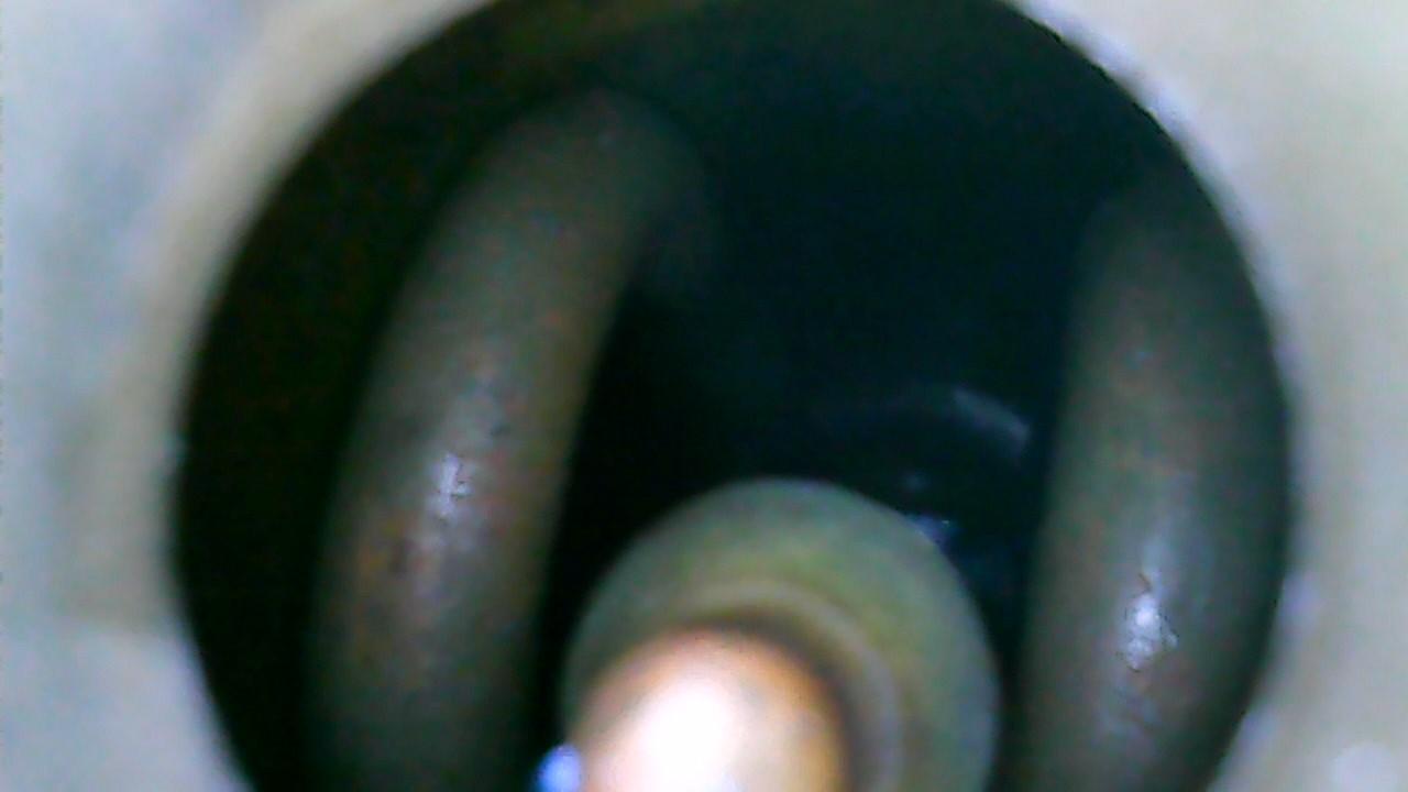

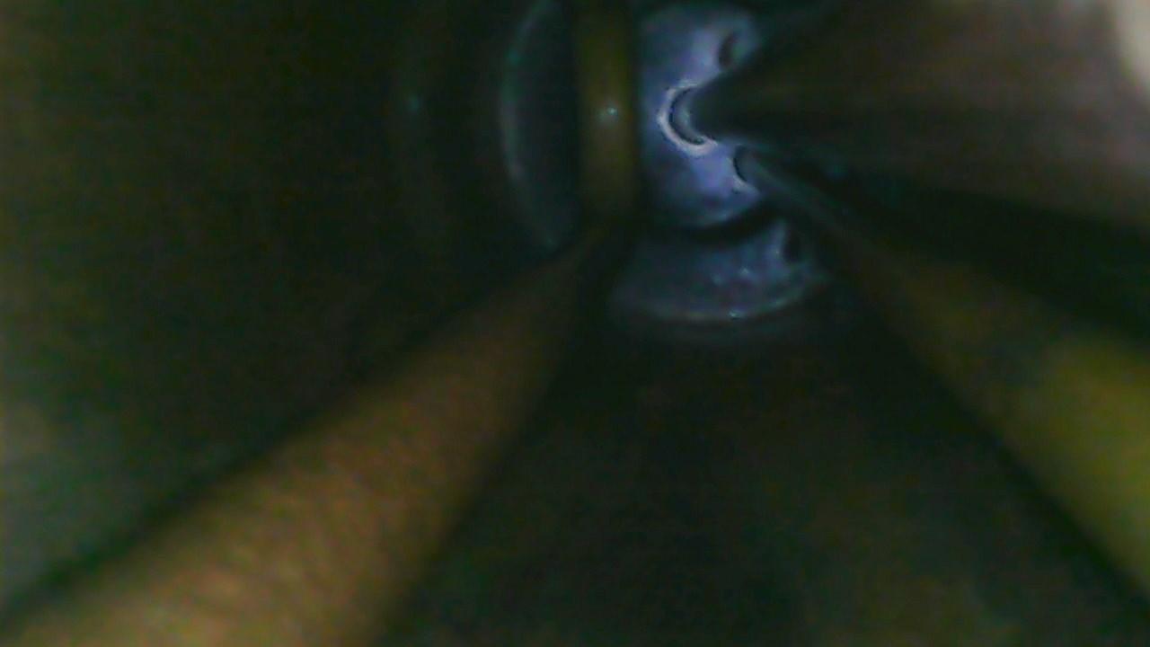

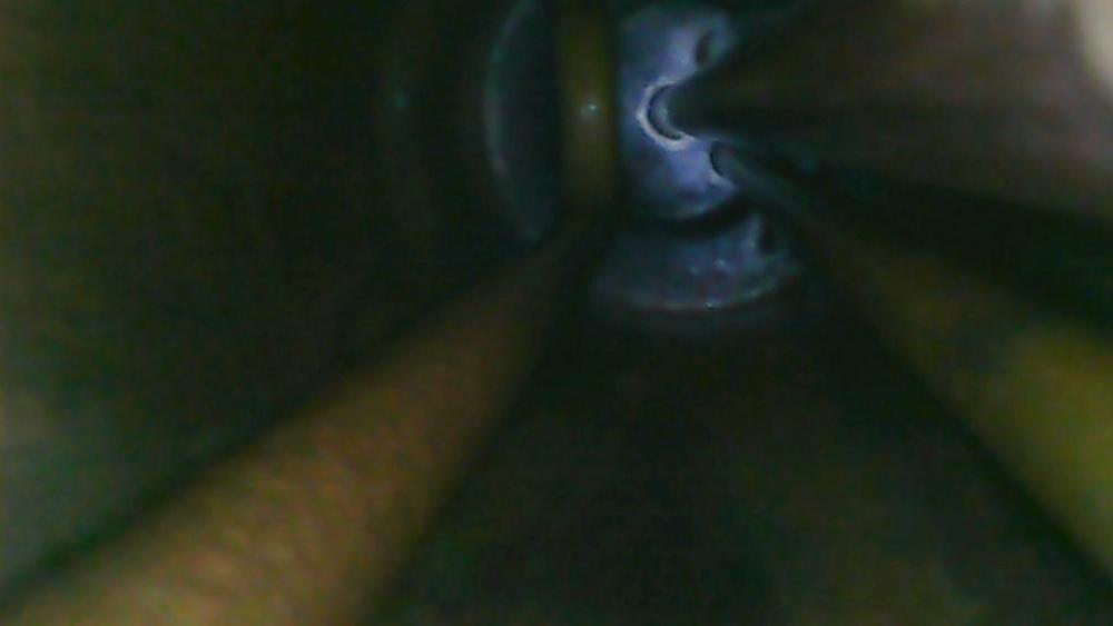

oranjeboom Posted November 17, 2020 Author Posted November 17, 2020 On 12/11/2020 at 20:41, Onoff said: Seriously, if you want 5L of it, no problem. The clever people on here will say whether it's OK. Cleans up elements a treat. Expand Thanks for the offer. I got some distilled vinegar and that seems to have done the job nicely: After On 13/11/2020 at 19:28, PeterW said: For anyone looking for cheap Wilo pumps for this sort of stuff, Toolstation have got the 5/130 at change of £90 https://www.toolstation.com/wilo-yonos-pico-circulating-pump/p75983 Expand Yes, thanks. I had already purchased from TS as I find the cheaper in 90% of cases. Bought the more expensive version, but not sure what benefit that gives me really. On 13/11/2020 at 19:33, PeterW said: Have you not got any inhibitor in the system ..?? If you are hacking into the system then worth adding one of the mag filters (cheap one here) which you can also use for dosing inhibitor into the loops. Shouldn’t be getting scale on a Willis as it’s a closed loop system. Expand Yes I added some but no room anymore for a mag filter. So with the fact that ScrewFix didn't have any Tectite push fittings and the fact that the family started moaning about no heating on Saturday I re-inserted the cleaned Willis heaters into the original configuration without new pump. They soon started hisssssssssssssssing again which surprised me as they were fine for many months originally. I could have used compression fittings but as it's such a tight fit and the flexi's to the manifold are at different angles and aren't flat to the wall, I splashed the cash for the Tectite fittings (not read great stuff about the Connex fittings from TS. Can't solder in that confined space with the plastic pipe and compressions will keep twisting elsewhere when I make any adjustments I suspect. Anyway, when I get all my fittings from SF I will do as prescribed by @Nickfromwales et al and hope it all behaves again.
