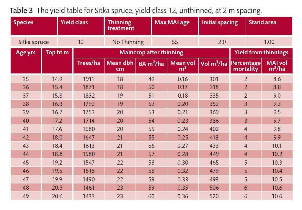

On 04/11/2020 at 22:15, Thedreamer said:
I burn a small trug of logs from about 6pm to 10pm.
I think that needs a surprisingly small amount of area to feed it.
I'd still like to know the mass (or volume) of timber in that. But let's do some approx. numbers.
If I take it as 150 days (ie 5 months of stove-evenings per annum) that is 150 small trugs per annum. I'll take a small trug as 10kg of timber.
At @SteamyTea's 4.5kWh heat output per kg of wood, that is 1500kg or 1.5 tonnes of wood per annum. That feels about right in terms of amount of wood.
At a convenient (say) midrange softwood density of 500kg per cubic metre that is 3 metres of wood per annum required.
So what does it take to generate 3 metres of softwood per annum?
Looking at the Forestry Commission Yield Tables, you can see that you get 3 metres just from thinnings on a plantation of approx 0.3 Hectares (ie just under an acre) as long if your (say) Sitka Spruce trees are 35 years old. And the main crop will still contain 300 cubic m of standing timber per Hectare, so you can get a maincrop as well. Or you could have a smaller patch and fell a bit every year.
I would say that half an acre of softwood should give you what you need for your evening fire on a continuing basis, containing 200-500 trees several decades old at 2m spacings. Ish. Very ish.
A quarter of an acre of your garden will make a big hole in your need. But you will be cutting at least one tree down every month ? . Below the Forestry Commission Licence level (assuming Scotlandshire is the same as Englandshire), but they are not especially small trees.
Ferdinand
Of dry timber, not sure if the FC table is for that.
And just for a giggle, work out the area of land needed, with PV on it, to supply the same energy at the same time of year.
I think my error margins are so large that the extra (or not) 5-20% mass of the moisture is De minimis. ?
(And with a single bound he was free).
I would put the overall error bars at +/-50% or so, but it is still a useful indication of scale - which is what I intended.
Very give or take I make it 200 panels.
Or one tenth of an acre.
Ish.
