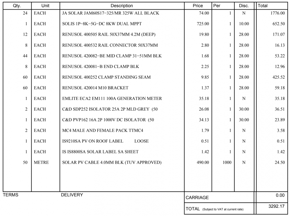

gc100 Posted November 3, 2020 Share Posted November 3, 2020 (edited) So I'm getting towards the end of my build and I want to make a decision on how much solar/PV to install. My quotes are: 4K ~£1700 6K ~£2500 8K ~£3100 + electricians time to install. My main point for me is to consume 'green' energy vs saving money *I don't want to go in to the argument of either of those points! Until I've lived there for 12 months I'm not going to know my consumption. However I want to buy now as part of the house build so I can get the VAT back. I have no idea really which on to go for. I don't want to go say for the 4 and then 12/24 months later add to this as I will need another inverter which is a significant part of the cost. Anyone else had the same situation? FYI it a 3 bed house, single story, 160m2 , vaulted ceilings throughout, reasonably airtight and insulated. 4 people, 2 working from home, ASHP, MVHR - electric everything (not a car yet though!) Edited November 3, 2020 by gc100 Link to comment Share on other sites More sharing options...

gc100 Posted November 3, 2020 Author Share Posted November 3, 2020 17 minutes ago, Mr Punter said: I am surprised it is so cheap. Is that supply only? Does it cover all materials? As it is only single storey it may be fairly easy to add panels later, when they may become cheaper / more efficient, so could you go for the 4K and allow for later add-on? As per first post. Supply + electrician time to install (2 days max ~£400). Don't want to add later as you loose the price of the inverter. 15 minutes ago, Bored Shopper said: Do you consider a storage battery? Our array is c.6K, and on a very good day we are up to 70% solar-powered-only, but on bad days (like this week) we are barely 4%. Normally any surplus in our circuit goes into our Tesla Powerwall, which then discharges into the house either during the night or at least half-day next day. Without storage we won't be that efficient. Yes but too expensive for me and I can't justify personally. I can 'loose' 3K in the cost of my build and have the good feeling of consuming some energy I generate. But an additional £10K is too much for me. Link to comment Share on other sites More sharing options...

PeterW Posted November 3, 2020 Share Posted November 3, 2020 Is that for the panels inverter and all the mounting equipment ..?? What brand is the inverter ..? 8k is 28-30 panels depending on power output, there is no way one person can install that in 2 days with all the rails etc to install. That’s the equivalent of 20 mins per panel to rig the roof, install and wire. Do you still have scaffold on the building ..? And have you got planning permission for panels ..? Link to comment Share on other sites More sharing options...

gc100 Posted November 3, 2020 Author Share Posted November 3, 2020 41 minutes ago, PeterW said: Is that for the panels inverter and all the mounting equipment ..?? What brand is the inverter ..? 8k is 28-30 panels depending on power output, there is no way one person can install that in 2 days with all the rails etc to install. That’s the equivalent of 20 mins per panel to rig the roof, install and wire. Do you still have scaffold on the building ..? And have you got planning permission for panels ..? Regarding install time. Yes I don't know exactly how long it would take, but I would probably put that panels up myself and just get the sparky to guide/do the electrics. I'll ask him how long but I'm sure he said a couple of days the first time we discussed (though that might of been a 4K in his head). I already have the cable and can get less expensive clams than on this quote. The lower roof line is very low and easy to get (2.5m) to either by the hand yougman scaffold or just a simple ladder. Yes we have permission. I feel no believes me so here's the 8K quote from the supplier. Link to comment Share on other sites More sharing options...

markharro Posted November 3, 2020 Share Posted November 3, 2020 Can I ask where you got the quote from? I will eventually be in the market for maybe 54-60 panels of around the same wattage for our proposed passive house + build and its only going to happen if I can source the kit for really keen prices. I had previously been looking at panels by the pallet load from Bimble solar but those were quite a bit more I think than your quote of £74 per panel. Are these new standard size panels for that price? Thanks. Link to comment Share on other sites More sharing options...

gc100 Posted November 4, 2020 Author Share Posted November 4, 2020 I cannot really share the supplier due to discounts applied, but its a national trade electricial supplies company. There aren't that many! Just get your electrician to phone around. I think I'll be going 8K as per Joth logic about getting a batteries down the road. Link to comment Share on other sites More sharing options...
