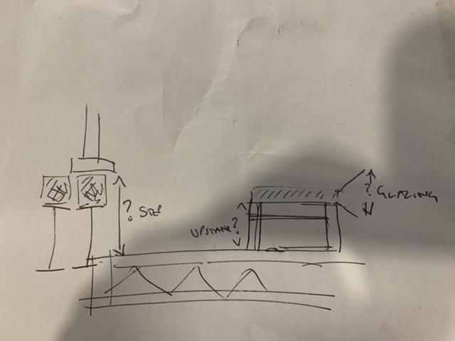

revelation Posted October 20, 2020 Share Posted October 20, 2020 Hi all We had a flat roof (with a parapet wall) constructed and some doorways for balconies, our original builders didn't account for the the roof build up for a thick layer of insulation in the warm roof. So for the balcony area to work we decided to reduce the insulation down to 50mm (and 25mm in a couple of places) for the warm roof. And though we will make up the rest below in the ceiling as we have around 25cmm of room, either with kingspan kooltherm or a layer of spray foam insulation. Does that sound okay, any potential problems with that? Link to comment Share on other sites More sharing options...

revelation Posted October 20, 2020 Author Share Posted October 20, 2020 That really doesn't sound good. We started off with a set of builders who really messed things up, they didn't consider the build up of the initial warm roof. We were planning to have 120mm-150mm of insulation in the warm roof. But as we had doors that were supposed to open out to the balcony they would have been blocked off due to the room build up going higher than the bottom of the doors. So we thought if we reduce the insulation on the outside and have extra insulation on the inside (below), that should balance things out. Would it potentially work if it was say a closed cell spray foam insulation below? We do have a heat recovery system so I am hoping that will help keep moisture levels in the house down. Link to comment Share on other sites More sharing options...

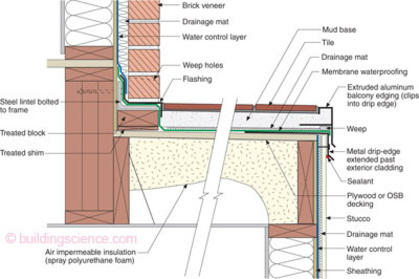

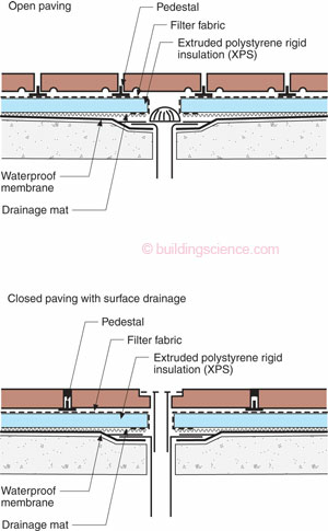

revelation Posted October 23, 2020 Author Share Posted October 23, 2020 Thank you everyone, without doubt it seems like our current set up is going to be a huge problem. So I am going to be making some changes. My current builders are good, the previous guys made a mess of the levels which has caused us the issues with the levels. I have attached some images showing what was going to be the set up and what I think my options are with this. The image shows one of the doorways going out onto the roof, there is still a block to go on that steel, but we don't have a lot of room for the build up. ORIGINAL PLAN definitely been scrapped. PLAN A This would be the least disruptive (if you guys think it will work as it changes nothing on the roof above) I have been advised that if I have insulation below the OSB that there will be air gaps and voids where you can get condensation. If I were to get spray foam insulation (closed cell) which will effectively fill in any air gaps leaving nowhere for condensation to form? PLAN B. As a couple of people suggested, I shouldn't have more insulation below than I have above. Therefore if I add on some insulation above and then an equal or slightly lesser amount below would this work. The only issue I have is the walk on roof glass not sitting flush with the decking, which would be a possible trip hazard and aesthetically wouldn't look very good. Considering the cost of the glass its going to be a shame if we can't finish flush as we wanted. Link to comment Share on other sites More sharing options...
PeterW Posted October 23, 2020 Share Posted October 23, 2020 Not sure why the flush finish would be an issue as you just use adjustable legs to get the decking in line with the glazing ..?? When you say some has been done, what do you mean..?? Is all the deck down with insulation ..?? Or is some of the felt / membrane / GRP done ..?? Spray foam won’t be cheap and I don’t think will resolve your issues. Link to comment Share on other sites More sharing options...
the_r_sole Posted October 23, 2020 Share Posted October 23, 2020 The rule of thumb I've heard with hybrid roofs is you should have twice as much insulation on the outside... If you're using adjustable feet to take the deck, have you looked at all the options for that? And/or can you not raise the finished level of the glass to accommodate a higher deck? Link to comment Share on other sites More sharing options...
