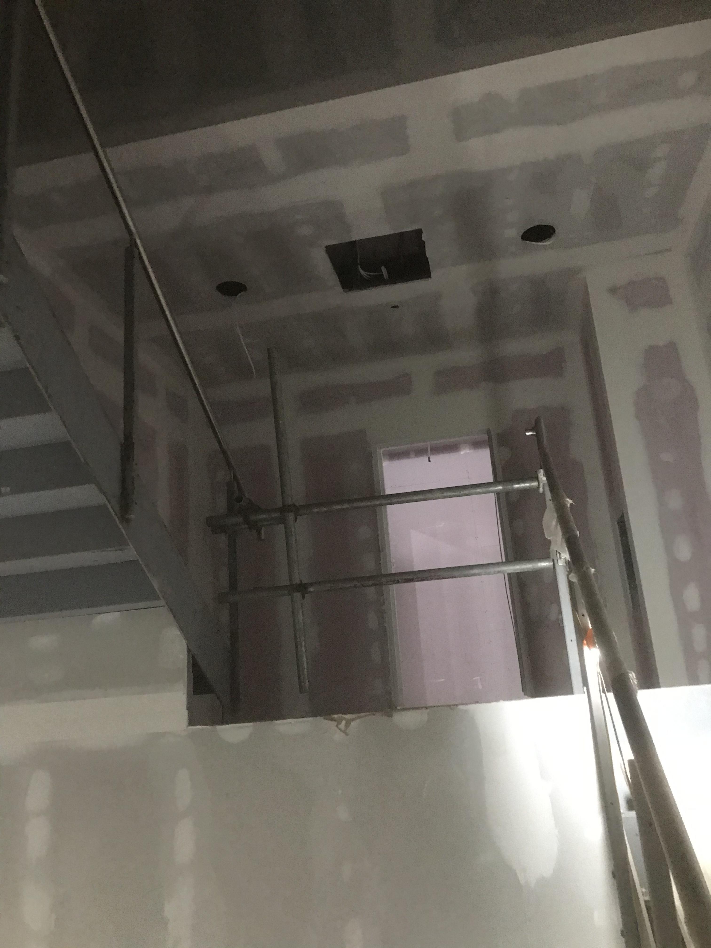

nod Posted October 20, 2020 Posted October 20, 2020 2 hours ago, revelation said: Others have said you will probably see some of the imperfections in the finish. If its likely to only be a small difference I may well go down the skimming route. I employ two tapers and numerous plasters My wife and myself did most of the building work on our house I chose to skim ours out myself rather than tape it Taping is ok if it is done correctly But Skimming is a better finish Picture is the 8 floor staircase I taped over lockdown Due to lack of multi finish The client rejected it due to it not being as durable as Skimming Four days wasted We had to spend nearly a week over skimming
revelation Posted October 20, 2020 Author Posted October 20, 2020 6 hours ago, nod said: I employ two tapers and numerous plasters My wife and myself did most of the building work on our house I chose to skim ours out myself rather than tape it Taping is ok if it is done correctly But Skimming is a better finish Picture is the 8 floor staircase I taped over lockdown Due to lack of multi finish The client rejected it due to it not being as durable as Skimming Four days wasted We had to spend nearly a week over skimming In your experience is there a significant enough cost saving to go down the taping route. Ours is a decent sized 4 bed semi, and if skimming gives a better finish and is more durable water resistant etc... And the cost difference is only 10% or so, then its a no brainer for me.
