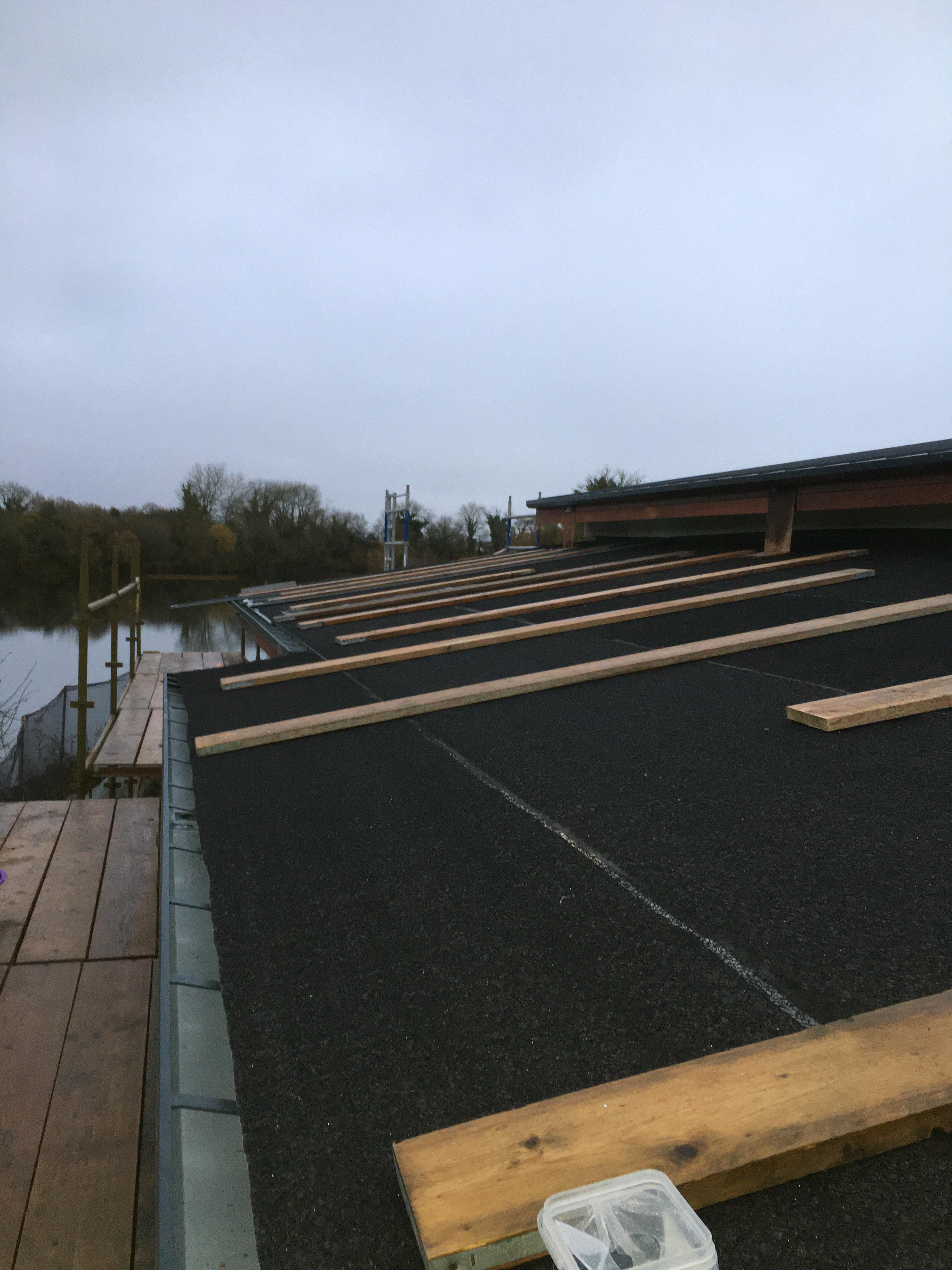

Mr Punter Posted October 20, 2020 Share Posted October 20, 2020 If it is a zipped seam the halters holding the roof panels should space them away from the substrate. If it is flat to the substrate you could maybe use a membrane like they do on some zinc roofs, where the membrane is covered in coarse plastic extrusions or dimples that support the panels and leave a gap for air and drainage. Link to comment Share on other sites More sharing options...
Russell griffiths Posted October 20, 2020 Share Posted October 20, 2020 I used one of the fancy membranes with the polypropylene mesh on top i wouldn’t use a standard membrane. 1 Link to comment Share on other sites More sharing options...

Patrick Posted October 22, 2020 Share Posted October 22, 2020 On 20/10/2020 at 20:36, Russell griffiths said: I used one of the fancy membranes with the polypropylene mesh on top i wouldn’t use a standard membrane. That's how it's done. Link to comment Share on other sites More sharing options...
