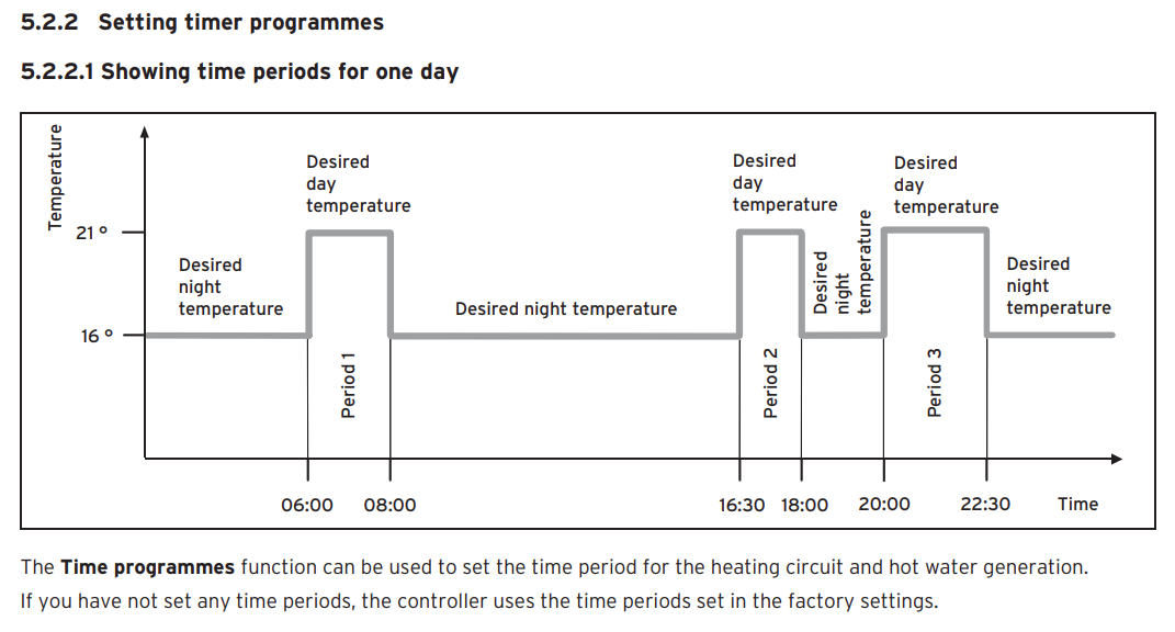

11 minutes ago, PeterW said:
Can’t do that with the unit he has - it only has 2 temperature settings, the heat setting and the setback. Both have to be the same in on/off periods so basically whatever temperature is “off” between 9am and 12 noon for example is the same setting between midnight and 6am.
...and the diagram on page 25 may help illustrate this as it can get a bit confusing just written down if you're not familiar with this method of control:
2091168237_Screenshotfrom2020-11-0109-49-43.thumb.png.4ce37d0279ad2730bf61801a694181f5.png
  • Like 1
Link to comment
Share on other sites
So to ensure a silent night time, set the set back temperature to 5 degrees and accept if there is an off period in the middle of the day the house might get very cold.
If you can't accept a very cold house in the middle of the day then make the morning heating time stay on for longer and make the afternoon heating time start earlier.
