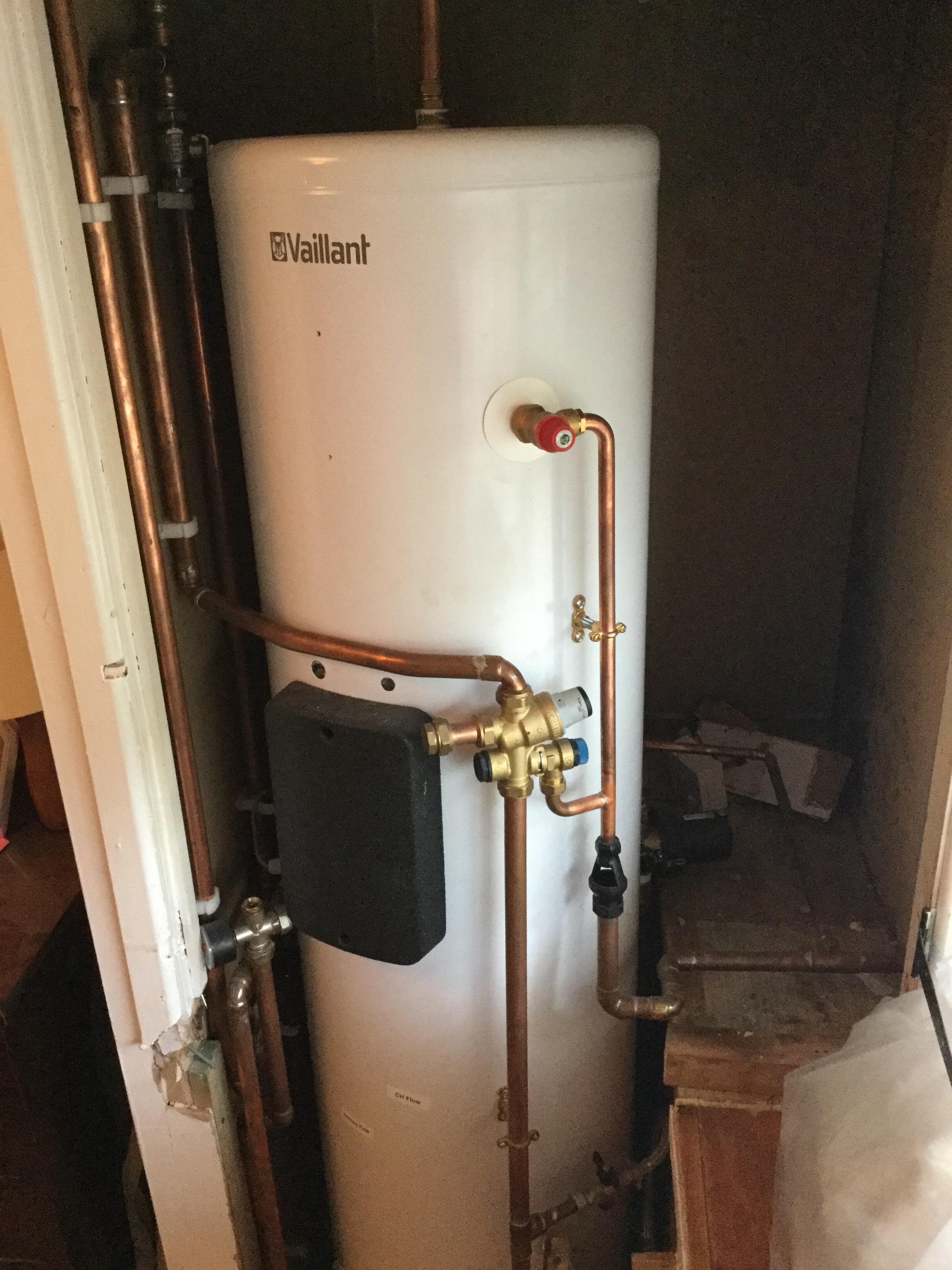

joe90 Posted October 30, 2020 Posted October 30, 2020 7 minutes ago, zoothorn said: I also notice an excess of water coming out of the outlet pipe outside, from the cylinder, there is your problem (I think) the only outlet pipe is a release pipe to stop excess pressure in the system, sounds like you’re pressure release valve is leaking (I had one of these in the past.) ( but a proper plumber will be along in a mo ?♂️).
zoothorn Posted October 30, 2020 Author Posted October 30, 2020 Just now, joe90 said: there is your problem (I think) the only outlet pipe is a release pipe to stop excess pressure in the system, sounds like you’re pressure release valve is leaking (I had one of these in the past.) ( but a proper plumber will be along in a mo ?♂️). Aha! yes of course, if you mean here is the mystery "leak"? Right that makes sense. Its definitely linked to the new pump: I have only seen this excessive water (I assume it is a bit excessive, & not normal) after the new pump fitted. So is it a problem of the innitial installers? surely you can't put this problem in their intray to sort out.
ProDave Posted October 30, 2020 Posted October 30, 2020 You might be on to something if you are seeing water leaking from an outside vent pipe. This could be your hot water from the hot water tank, but it could equally well be the water that is going missing from the heating circuit. They are two completely separate things. Taking the heating system first, this is a sealed system that is charged to a set pressure then the water is turned off. There is an expansion vessel that will absorb normal rise and fall of pressure as the water heats up and cools down. As a safety feature this has a pressure and temperature relief valve that will let water out if the pressure gets too high. This is the one that will cause the low pressure error if it loses water for some reason as it does not automatically get topped up. Now the hot water cylinder. That is constantly topped up with cold mains water in, via a pressure relief valve to limit it to a safe pressure. That too has an expansion vessel (a larger one) to absorb changes in volume as the water heats up. This will have over temperature and over pressure relief valves that will discharge water if it gets too hot or the pressure gets too high. You need to follow the dripping discharge pipe into the house and find where it goes and which one is discharging. Both will discharge via a tundish that looks like this The open bit in the middle is so you can see if it is discharging water. It might not be discharging all the time, so this is where you want to insert a bit of tissue paper into both of them, and check regularly to see if the paper is getting wet. If you find one of the tundishes is discharging water, get your installers back and show them which one and get them to check it and fix the problem. 1

zoothorn Posted October 30, 2020 Author Posted October 30, 2020 @ProDave ok this is gaining clarity now. Yes Ive seen this black thing, I easily traced the outside outlet pipe back to this thing inside the house.. & since this pump installed notice it drip driping away sometimes even a slight stream. I was told by installers, to expect a bit of water asap after the new system installed 3 months ago. That it did, then settled down after a few days (never ammount I saw a few days ago, a week+ after this new pump fitted tho). I still feel reluctant to ask the installers back, if/ as seems highly probable, its an 'after-issue' directly linked to a new pump a Vaillant engineer's just fitted. But you still think its for the installers to rectify-?
joe90 Posted October 30, 2020 Posted October 30, 2020 Where does the pipework go after the tundish? (Black thing), any chance of a pic.?
zoothorn Posted October 30, 2020 Author Posted October 30, 2020 3 minutes ago, joe90 said: Where does the pipework go after the tundish? (Black thing), any chance of a pic.? Straight out the wall joe to the outlet pipe, slight downhill etc.
joe90 Posted October 30, 2020 Posted October 30, 2020 (edited) Noooo, the other way, what’s it connected to? Which bit of plumbing is producing this water? Edited October 30, 2020 by joe90
ProDave Posted October 30, 2020 Posted October 30, 2020 A tundish should NOT normally drip. It is there as a warning so you can see if it is dripping in which case you know something is wrong. So if it is dripping then something IS wrong and it is up to the installers to come and fix it. Don't let them fob you off with any notion that it is normal for it to drip.
zoothorn Posted October 30, 2020 Author Posted October 30, 2020 3 minutes ago, ProDave said: A tundish should NOT normally drip. It is there as a warning so you can see if it is dripping in which case you know something is wrong. So if it is dripping then something IS wrong and it is up to the installers to come and fix it. Don't let them fob you off with any notion that it is normal for it to drip. ProDave- ok that's conclusive as to a problem then thanks. But I'm back to same thing: this only started after new pump Vaillant fitted. Are you referring here to Vaillant as effectively being the installers on this issue then?

joe90 Posted October 30, 2020 Posted October 30, 2020 Just for my piece of mind where is it coming from,???. Follow the pipe above the tundish and let us know, or take a pic to show us.

zoothorn Posted October 30, 2020 Author Posted October 30, 2020 2 minutes ago, joe90 said: Just for my piece of mind where is it coming from,???. Follow the pipe above the tundish and let us know, or take a pic to show us.
ProDave Posted October 30, 2020 Posted October 30, 2020 ^^ If that is the tundish that is dripping then you have TWO faults. That is the tundish for the hot water, and it means either the over pressure valve (with the blue knob) or the over temperature valve (with the red knob) is letting water out. So that is a fault that needs fixing, potentially it is unsafe at the moment with an unknown fault. BUT that will not be the cause of the heat pump tripping on low pressure. There will be aoother set of valves and another tundish somewhere, quite likely near the inside half of the ASHP. You have a second fault causing the heating circuit to lose water. I don't presently have much confidence in your installers.......

Temp Posted October 30, 2020 Posted October 30, 2020 32 minutes ago, zoothorn said: You think the installers should rectify a problem linked to Vaillant fitting the new pump-? Its not clear if they are definitely linked.. In my limited experience I have found that Pressure Relief Valves (PRV) are fragile temperamental things. If the pressure goes up too high just once (so that a little water comes out) then they can start leaking all the time. Not quite sure why but I've had at least three or four do that. So if you get the PRV replaced and need to pressurise the system yourself in future be careful not to go so high that the PRV opens. As you know water expands and contracts when it heats up and cools down. Others have already mentioned that there should be a correctly sized expansion vessel (or two) somewhere that accommodates the expansion of the water so that the pressure doesn't rise too much and the PRV doesn't open. If the expansion vessel is too small (a design fault) or has lost its charge (needs pumping up or replacing) then the pressure can rise too much causing the PRV to open and in my experience its quite likely to fail with a constant slow leak. None of this is specific to ASHP. I've had this issue on both gas and oil fired systems. If you can find the expansion vessel(s) they may have the size writtin on them and if you know how big the tank is it might be possible for one of us to check if the expansion vessel is too small.
