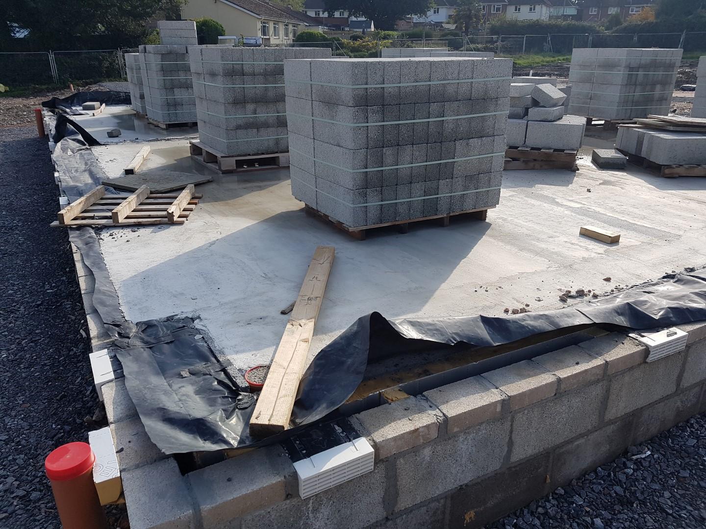

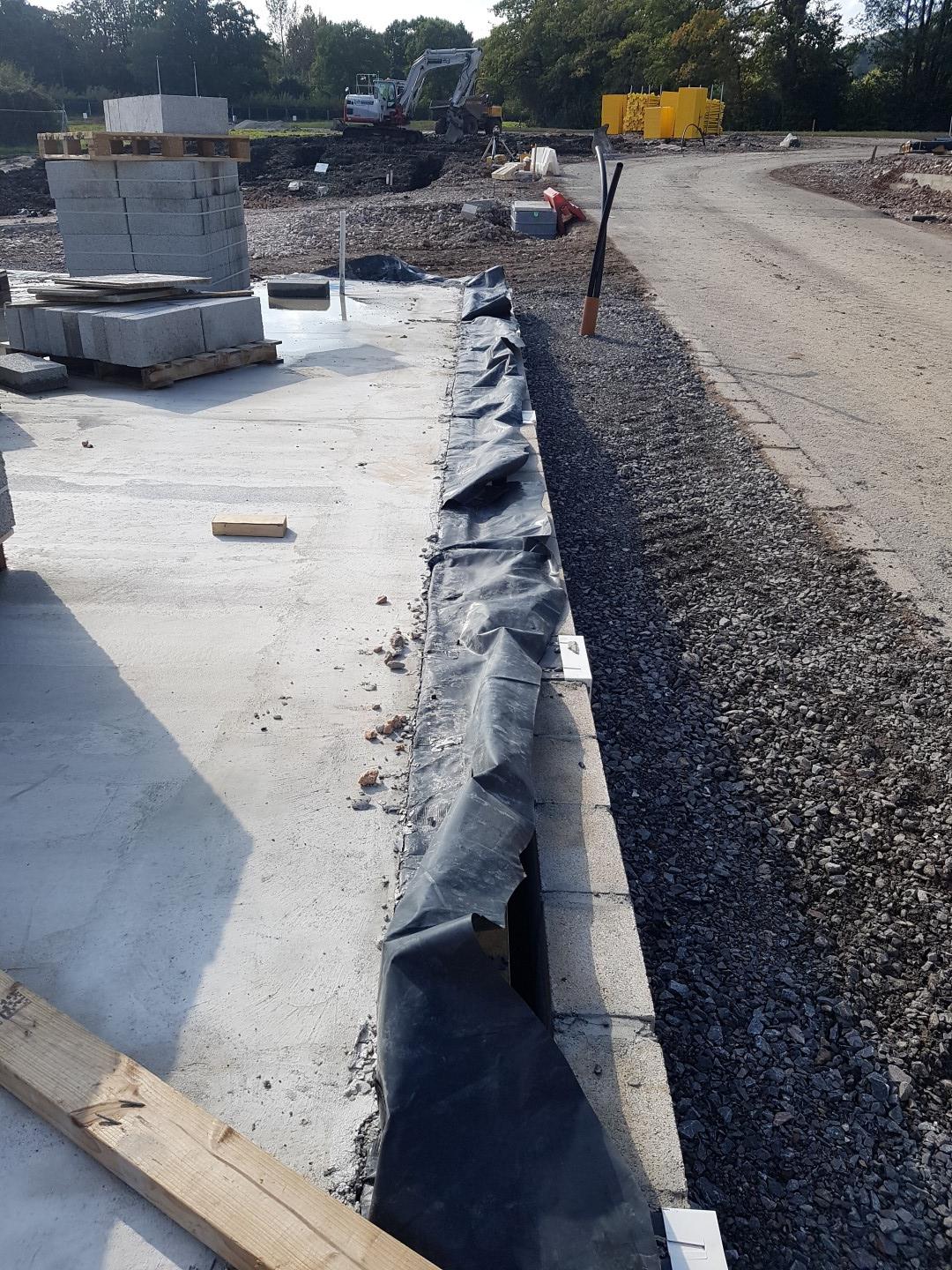

Moonshine Posted October 14, 2020 Author Posted October 14, 2020 interestingly i was on site today and was having a look at builds going up, and particularly that they had some detached house plots with beam and block which were already screeded with concrete without any external walls or roof. Speaking to the site manager this is how they do it even with UFH in the screed. I presume with the concrete screed exposed to the elements isn't too much of an issue.
MJNewton Posted October 14, 2020 Posted October 14, 2020 I think that's how they did our house, with just then a thin levelling compound at the end to neaten up the surface for covering.
Moonshine Posted October 15, 2020 Author Posted October 15, 2020 23 hours ago, Moonshine said: Just looking back at this photo I have just realised that the is no thermal insulation upstand, so there is going to be some nice thermal bridging. I have been in contact with a local liquid screender who have quoted £1515 + VAT for 80m2 of 65mm depth. That is £19 per m2 which doesn't seem that bad.
MJNewton Posted October 15, 2020 Posted October 15, 2020 3 hours ago, Moonshine said: Just looking back at this photo I have just realised that the is no thermal insulation upstand, so there is going to be some nice thermal bridging. They'll have likely gone over the top of the upstand slightly thus obscuring it. I think you can see some of it exposed around the pipe in the other picture. 1
