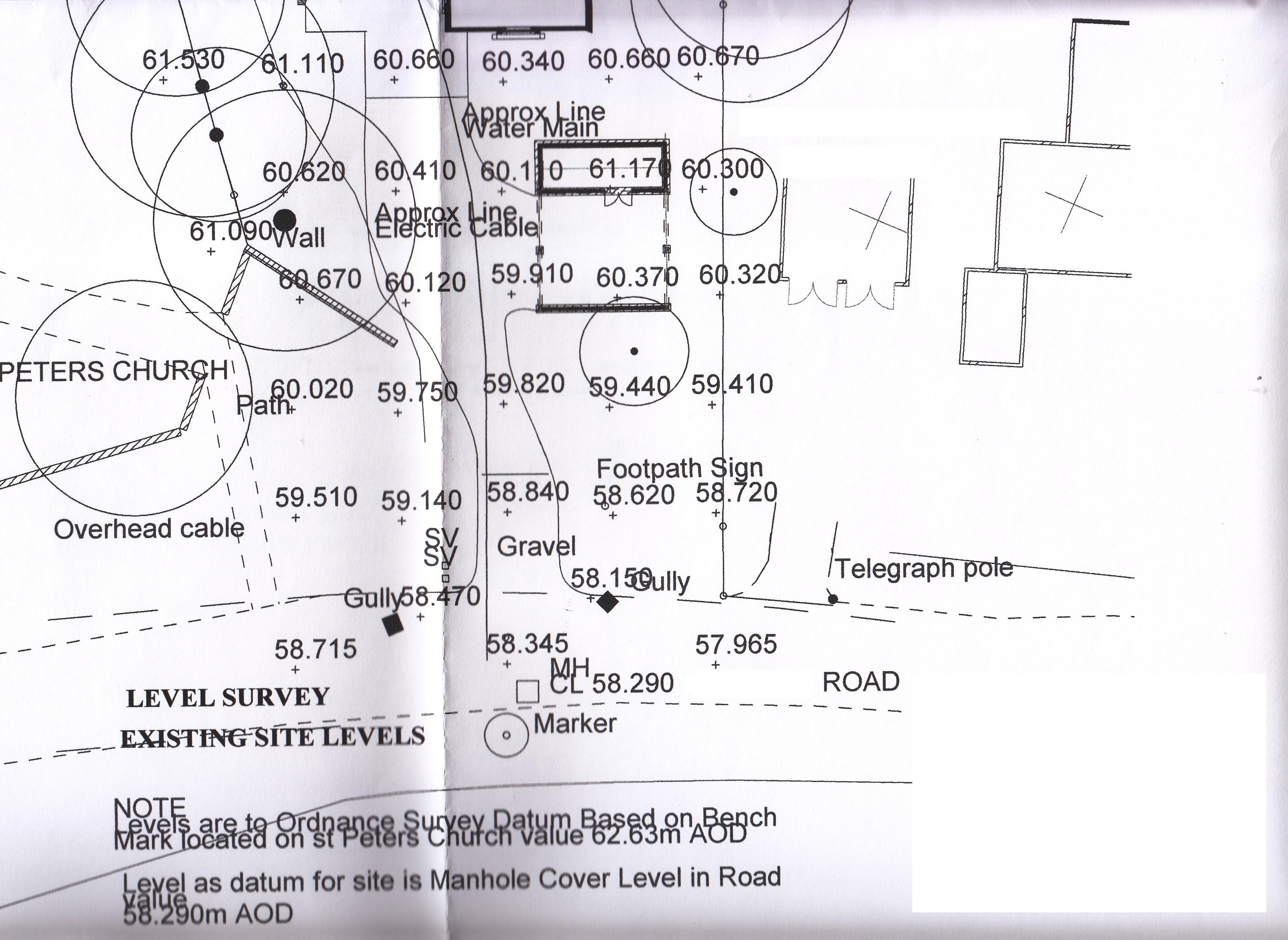

Temp Posted September 5, 2020 Posted September 5, 2020 (edited) 7 hours ago, Internet Know How said: I have already measured the site with a tape measure, so whilst this isnt exactly laser level, could I not just buy a laser level myself for about £50 if he wanted something a little more accurate? You could probably do one yourself. Here is part of ours. Basically its a site plan with a 10m grid of height markers and two reference points noted at the bottom. This version was done for the planning application so it also shows our proposed house (mostly off the top of the scan). I assume the surveyor sent an electronic copy to the Architect so yours might be expecting it in some electronic format he can import into his CAD. PS We had one done because the site slopes. Edited September 5, 2020 by Temp

Internet Know How Posted September 6, 2020 Author Posted September 6, 2020 13 hours ago, Temp said: You could probably do one yourself. Here is part of ours. Basically its a site plan with a 10m grid of height markers and two reference points noted at the bottom. This version was done for the planning application so it also shows our proposed house (mostly off the top of the scan). I assume the surveyor sent an electronic copy to the Architect so yours might be expecting it in some electronic format he can import into his CAD. PS We had one done because the site slopes. Ok I didnt realise my Architect may import and overlay his design onto it to ensure it fits correctly. Even still, if I laser level out the site wall to wall I cant see how we can go wrong given its fairly level and will be digging out for a basement

NandM Posted January 11, 2021 Posted January 11, 2021 What do the numbers mean? I was look at one yesterday and couldn't work out if that was the distance between the points or something else.
Mr Punter Posted January 11, 2021 Posted January 11, 2021 On site surveys the numbers with 3 decimals are the height (normally) above ordnance datum (AOD) - which is a recognised benchmark height based on mean sea level. 1
