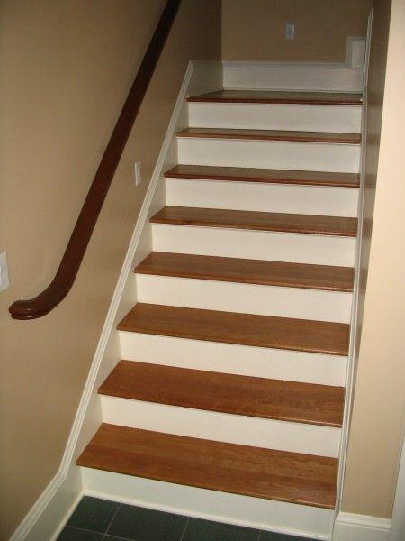

Carrerahill Posted September 4, 2020 Posted September 4, 2020 For the stairs it depends, are you going to carpet them or leave them bare or what is the plan? If you were going to cover them in carpet or even wood I would make a false stringer - basically tale a piece of 1x8 or something, and cut out the stair part, then sit it over the top so it looks like a normal stringer, you can then leave as is or dress with a piece of bead. cut the ends 90° to the floor and you can then run skirting up to these. Another option is just cut and fit skirting up and around them all but I think that looks a bit fussy and doesn't look right in general. If you were say tiling the floor then tile up the wall one tile type thing. As for the rad pipes... what can I say!

joe90 Posted September 22, 2020 Posted September 22, 2020 (edited) I would want steps equal (and building regs also say this, if they apply). Measure the total height difference and divide by 3 (IMO) and build Up the steps with timber , step depth also equal so new bottom step = middle step depth. Skirting as per @Carrerahill picture above. Edited September 22, 2020 by joe90

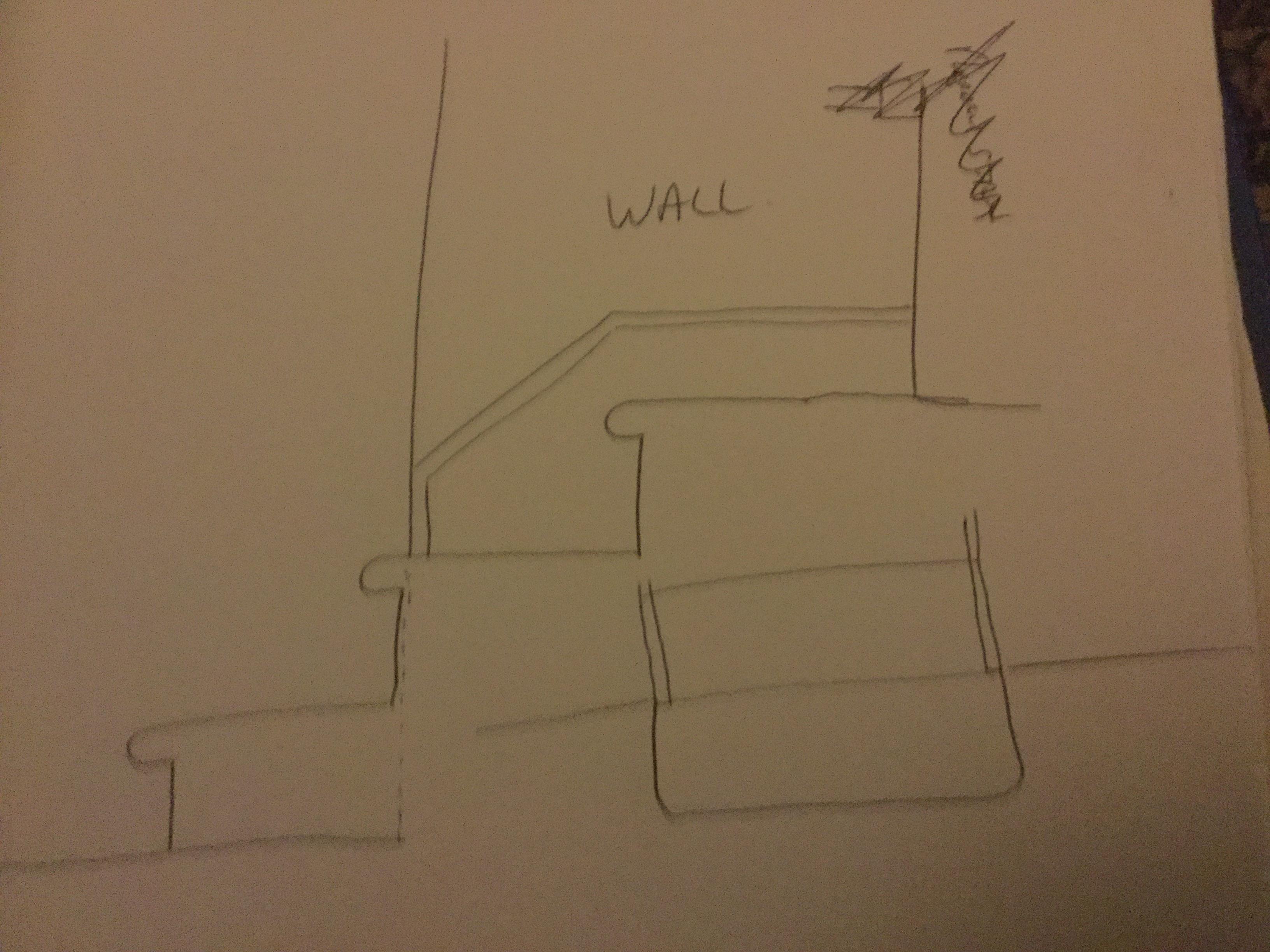

joe90 Posted September 23, 2020 Posted September 23, 2020 Sloping skirting ends at the wall of the lower room, new bottom step rounded corners with bull nose all round.

zoothorn Posted September 23, 2020 Author Posted September 23, 2020 58 minutes ago, joe90 said: Feck off, watching tv (actually I can do isometric projection or oblique projection, which would you require ?). I dig the drawing joe90 thanks. I can't quite follow the idea of skirting finishing before the new lowest step. The main prob I have with visualising any sloped skirting, is the stuff itself: if I have 5" high stuff around ther room, as I have just done up to the room corner just LHS of the steps, then I assume the idea is to use the same profile skirting.. but well over 2x the height so ~ 12" high? IE once put on the angle the deep bits go right down to the step. But the only skirting I see with my profile.. is 5". TBH Ive never seen 10" or 12" skirting (or whatever is needed, if I'm visualising it right.. likely I'm not) Ive only ever seen max 6" or so. So how on earth this huge angled section is made & from what.. I have no idea.

joe90 Posted September 23, 2020 Posted September 23, 2020 Right mate, photo of how I finish end skirtings, 45’ cut through top moulding and plant on end piece. Also need to plant on (glue) additional wood to make depth required. Hope this makes sense?

zoothorn Posted September 23, 2020 Author Posted September 23, 2020 Just now, joe90 said: Right mate, photo of how I finish end skirtings, 45’ cut through top moulding and plant on end piece. Also need to plant on (glue) additional wood to make depth required. Hope this makes sense? Sorry joe.. I'm totally lost. I've no idea what/ where this ^ small piece might refer to. totally lost. Can I please just go back one step. I just need to 1st understand how this side-of-stairs-angled-skirting is made (IE what can it possibly be made from??) before I decide on choices (if I have any) or details (if this is what is suggested with the photo). Then I can go from there. thanks
joe90 Posted September 23, 2020 Posted September 23, 2020 5 minutes ago, zoothorn said: I just cannot fathom how this angled skirting is made at all. Just make the steps first then make a cardboard template of what you require fir skirting and post a pic here and I will talk you through it. ?

zoothorn Posted September 23, 2020 Author Posted September 23, 2020 I just require (very roughly/ just as a basic working plan) the same as carrerahill's angled side "look". Now assuming the stuff used there, is standard skirting, then it looks he's taken a 10" high x 12ft loooooooooong piece of skirting, & cut a series of "teeth, or triangles" all along.. so when tilted up these triangles become the outline of steps. That -must- and -can only- be the way this piece of angled side skirting was made. Surely I can't have this incorrect. Ok if I'm right, then he used 10" or so high skirting in order to make this piece (or maybe even 12"). But I do not see this sold. The same profile as the rest of the room (I assume the idea is to match it all around, not have 2 different profiles meeting) means I am restricted in height to 5". So how on earth do I make my angled side skirting piece from this??
