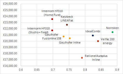

Visti Posted February 24, 2018 Share Posted February 24, 2018 (edited) I've quoted recently for 48m2 worth of windows and the prices range from £356 to £485 per m2. You can see a chart of them below: PM if you want the breakdowns in excel! Edit: X axis is the area averaged U value of the whole window (glass and frame combined) Edited February 24, 2018 by Visti 5 3 Link to comment Share on other sites More sharing options...
Lin Posted February 24, 2018 Share Posted February 24, 2018 33 minutes ago, MikeGrahamT21 said: I'm probably going to go against the grain here, but... Have you considered Eurocell's Modus Range? 75mm profile, and with the correct glass will get you a Uw of 0.81, for a pretty reasonable price. I got a quote for a Window which we had made by another supplier who use Liniar profile, and ended up a 1.1Uw, and Eurocell were cheaper! The Modus Profile is also suitable for passivehouse, but isn't a certified component, its been designed with PH in mind. Pretty sure you'd get a good discount on them too. I have had quotes for upvc including that brand from window/supply fit companies. Not including the slider window which i would get in alu, the modus works out about 350/m2 + VAT. is that what you would expect ? No u value stated I have a quote for grey triple upvc not including slider that works out half the price of the modus with u-value 1.3, but can go down to 1.1 with extra low e glass. Link to comment Share on other sites More sharing options...
Lin Posted February 24, 2018 Share Posted February 24, 2018 49 minutes ago, Visti said: I've quoted recently for 48m2 worth of windows and the prices range from £356 to £485 per m2. You can see a chart of them below: PM if you want the breakdowns in excel! cool chart ! Do you think you get good quotes because you are a regular buyer ? Link to comment Share on other sites More sharing options...
