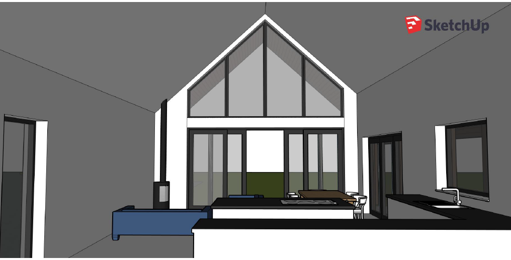

Nige Posted August 12, 2020 Share Posted August 12, 2020 Hi all My small new build will have a vaulted ceiling in the open plan living area. Any ideas on lighting as opposed to just having spotlights all over? Link to comment Share on other sites More sharing options...

Nige Posted August 19, 2020 Author Share Posted August 19, 2020 On 13/08/2020 at 08:01, the_r_sole said: Have is got any rooflights in it or exposed structure etc? Neither. Floor to ceiling glass aplenty. Link to comment Share on other sites More sharing options...

the_r_sole Posted August 20, 2020 Share Posted August 20, 2020 9 hours ago, Nige said: Neither. Floor to ceiling glass aplenty. In that case, could you look at led strips in a wee channel along the spring of the ceiling? The oxter (unofficial term ?) can be quite difficult to get a sweet, straight line on so you could maybe run something along there to hide that join and wash the walls/ceiling with light? 1 Link to comment Share on other sites More sharing options...
