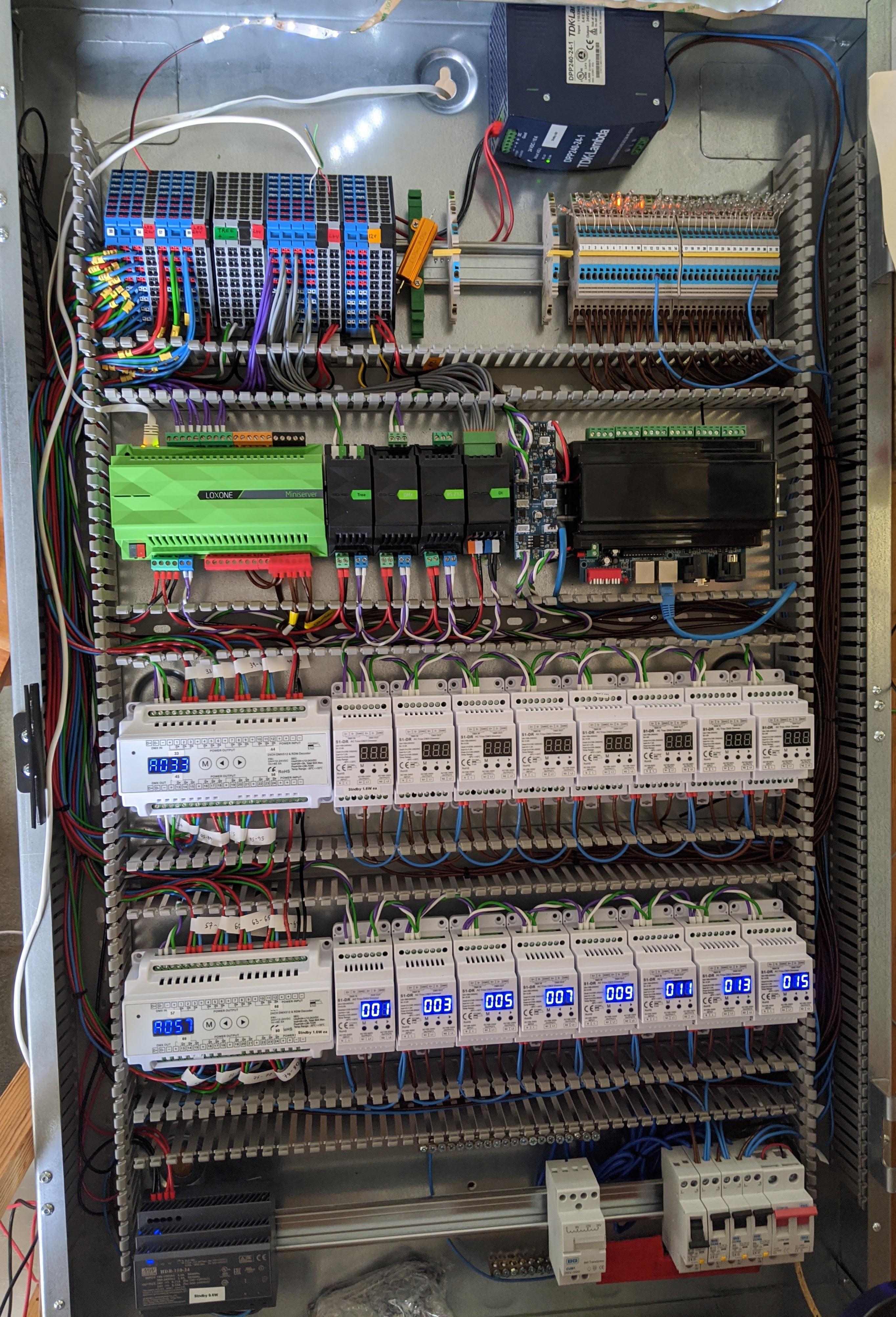

joth Posted July 27, 2020 Posted July 27, 2020 (edited) I'm about 95% done for the "benchtop" build of my Loxone LXN5 cabinet. Couple more tweaks to the doorbell transformer and bring out the connections for the DMX Relay board, before I pack it away until 2nd fix. (The plan is i'll get it put in place in 2nd fix, then the part P sparky will populate the RCBOs as he or she wishes them, and terminate the lighting circuits into the top of the board, and sign it all off. From top to bottom I have: [TDK PSU for LED strips] Low voltage LED and sensor connections | 25 ohm resistor for doorbell | Mains dimmed connections for lighting (populated with neon lamps for testing) Loxone server | Tree extension | DMX extension | RS232 extension (for texecom connect) | DI extension | DMX amplifier PCB | DMX 12x relay board (DIY case) DMX 24 ch LED strip controller | 8x 2ch DMX Mains dimmer ("upstairs LX") DMX 24 ch LED strip controller | 8x 2ch DMX Mains dimmer ("downstairs LX") Mean well HDR-150 24V psu | Doorbell chime transformer | RCBOs (for testing) Edited July 27, 2020 by joth 4

MrMagic Posted July 27, 2020 Posted July 27, 2020 (edited) Work of art there! Whats the proper name for the cable management 'finger strip' type stuff? Been looking for that for a while but not sure what to google! My only comment would be 'earths'/CPCs!.. although most of that kit is low voltage, looks like the TDK transformer in the top has an earth terminal. I guess you'll probably want another large set of connectors to common up all the earths on your lighting feeds out, not sure that metal block in the bottom would take them all. Normally only one conductor per RCBO/MCB unless it's a ring final circuit... but thats more a nice to have. Edited July 27, 2020 by MrMagic 1

Onoff Posted July 27, 2020 Posted July 27, 2020 17 minutes ago, MrMagic said: Whats the proper name for the cable management 'finger strip' type stuff? Slotted panel trunking. For example: https://www.google.com/amp/s/uk.rs-online.com/mobile/amp/p/cable-trunkings/1446409/ I just happen to need a bit of this 20x20 right now but I'm buggered if I'm buying 32 lengths! Smallest I have here is 25w x 37.5h. Got a whole bloody carton of it! 2
joth Posted July 27, 2020 Author Posted July 27, 2020 (edited) 4 hours ago, pocster said: I’m not familiar with dmx - but I know it’s expensive! . Funny enough I settled on DMX it's the cheapest option (for wired primary lighting). Dali is at least £30 per channel, plus more expensive cabling and (much) more expensive light fixtures. I never really priced up KNX or Tree lighting. Loxone proprietary mains dimmers are like £90 per channel (!!), but those S1-DR DMX dimmers I'm using are a steal at £12 per channel and easy for anyone to wire to standard (dimmable) GU10 bulbs. (The LED strip dimmer is one £1.50 per channel, but it's 5 channels for RGBWW lighting, and adding a beefy PSU for it starts to add up.) I also have the Loxone directly controlling a number of Teckin B22 bulbs over Wifi, which at £11 per fixture with RGBWW (tunable-white) is by far the best value of all, but I really don't want to rely on Wifi for my primary lighting! (Now I have that working so well, I question if I needed quite so many channels of DMX dimming...) 4 hours ago, pocster said: What are you doing about house wide audio , Cctv , sensors for automation? Whatever makes you think I'm having those? Oh, OK... - Audio: putting speaker wires in, plus some speakers in key rooms now. Initially I'll use my Sonos Amp but I'm not a major fan of their ecosystem so probably move to $something_else someday. The Loxone light switches can send volume / play commands to it, and I'll slowly get better control of it with Home Assistant - CCTV: Blue Iris and a bunch of Dahua cameras on cat6 (from unifi PoE switch). Might go Synology some point, or mess around with coral.ai person detection - Motion: Integration with the alarm system PIRs, door contact sensors, etc. - Motion: 24V motion sensors in key living areas and bathrooms (these, but butchered by my not so fair soldering hand to remove the damn noisy relays. "silent" my arse) Some other integrations in the works - Internorm automated shading - MVHR boost (based on CO2 or humidity ...) - Heating boost & eco mode control (UHF, fan coil, towel rads..) - Catflap! - Garage roller door. 3 hours ago, MrMagic said: My only comment would be 'earths'/CPCs!. Good spot! Everything (that needs earth) gets it through the chassis of the LXN5 cabinet. The mains terminal blocks have pickups in their DIN rail clamp, and the TDK PSU likewise does. That said, I'll probably hard wire it in anyway as it looks better doesn't it. 3 hours ago, Onoff said: Slotted panel trunking. For example: https://www.google.com/amp/s/uk.rs-online.com/mobile/amp/p/cable-trunkings/1446409/ Mine came pre-installed in the LXN5 cabinet as bought from Future Automation, but it is exactly that stuff 3 hours ago, Mr Punter said: I would have this somewhere fairly focal with a glass door. Alternatively you could set it into the floor in a corridor under some beautiful walk-on glass. Thanks (all!) for the positive feedback! My wife has very severe restriction on putting this anywhere visible -- I was hoping after 5 late nights helping out with wiring it all ("working the loom" as we called it -- getting the lengths in and terminating both ends much easier & faster with 2 on it) I was hoping she'd feel proud of it too and relent, but not dice (yet). We will have it in a central cupboard on the landing, but not overlooking the hallway balcony as I was hoping! Edited July 27, 2020 by joth
joth Posted July 27, 2020 Author Posted July 27, 2020 3 hours ago, MrMagic said: Normally only one conductor per RCBO/MCB unless it's a ring final circuit... but thats more a nice to have. Just saw this one - good tip! Yes I intentionally haven't done anything 'neat' with the connections into those as I'd like the certified electrician to have their input on that. Hence no bootlace crimps there (yet). For cases like this where multiple things come off one RCBO and terminate inside the cabinet, what is the alternative? Using something like wago blocks to split them out after the RCBO? Or daisy-chain the things?

MrMagic Posted July 28, 2020 Posted July 28, 2020 12 hours ago, joth said: For cases like this where multiple things come off one RCBO and terminate inside the cabinet, what is the alternative? Using something like wago blocks to split them out after the RCBO? Or daisy-chain the things? Thats certainly what I've done in the past... same as your LV distribution up the top, have a set at the bottom perhaps for the mains distribution. Splitting hairs here really, two conductors in an RCBO isn't the end of the world, no more tho! Talk to your sparky as well, they will have an opinion even if thier demarc is going to be the main isolator.
