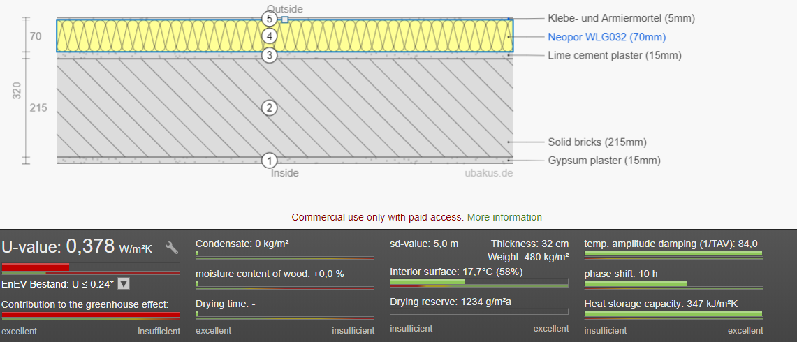

tanneja Posted July 22, 2020 Share Posted July 22, 2020 (edited) Hi all, Major renovation of our 1930s semi-home but will have lots of original external wall retained. Currently have 15mm internal plaster / 215 solid brick / 20mm external render for U-value around 1.8. Builder concerned by prospect of EWI any chunkier than 70mm, (probably to sync with adjoined neighbour / not take up all the soffits overhang / not have windows set undesirably far back) but hopeful I can push him on that. I see that 120mm of PIR would get us down to 0.18, but obviously PIR is phenomenally expensive. 70mm PIR (seems to be max thickness of a single sheet) seems to get us to 0.29. Can anyone steer our thoughts to how to make insulation more affordable, and perhaps what U-value to from a comfort perspective? If PIR is the only option given our thickness restrictions, and we are looking in the territory of 140m2, where will we get access to the best deals? Many thanks Edited July 22, 2020 by tanneja Link to comment Share on other sites More sharing options...

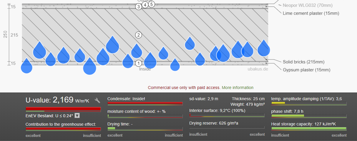

MikeGrahamT21 Posted July 23, 2020 Share Posted July 23, 2020 Majority of people use Graphite EPS, for cost vs performance. 70mm will get you to 0.38U, however bear in mind that at the minute you are probably around 2.2U, rather than 1.8U you suggested, thats still a massive improvement. You can go over the amount you have available in your soffits, but in my opinion this is when it starts looking horrible. Before After with 70mm EPS After with 100mm Kingspan K5 Phenolic Hope it helps in making your decision. Regards Mike 1 1 Link to comment Share on other sites More sharing options...

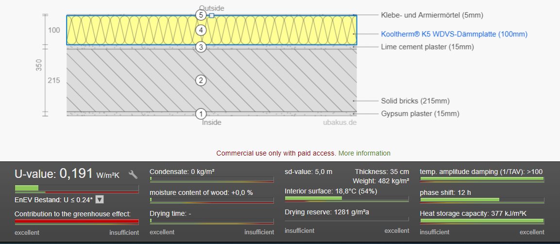

tanneja Posted July 24, 2020 Author Share Posted July 24, 2020 @MikeGrahamT21 you are so right, 2.2 currently, my mistake. I am struggling to guage the difference in comfort that 0.38 (EPS) and something around 0.2-0.3 (Kingspan K5) would mean in real world terms, and whether the extra cost would be justified if we plan to stay here for 20 years. @Russell griffiths that is reassuring to say not get hung up with U values. It is such a prominent subject when reading the glazing board here, in reality I ave no sense for what will be the better insolator from low / high outdoor temperatures. I guessed that building regs set the levels as low as they have for a reason and so was looking to get close to extension or even new build regs. Any further sense you can talk into me is appreciated. @Mr Punter you would be my builder's best mate to agree 70mm would be sufficient. Our budget is blown to pieces through a very wet start of the year and the virus, is EPS is still a responsible choice for the long term given it's U value, my builder would be enthusiastic take a two day course on it and then try. @Onoff thank you for the post link, I had read it but when i saw the thickness I would need with EPS to get to a U value approaching regs (not that regs are necessary for me as this isn't on the extended part of the house, but still seemed sensible to shoot for that). Maybe falling short, at around 0.38, will still be fine and compliment the plans for 3G and "relative" air tightness around the house. @joth I have no idea. Our roof is being entirely taken off and starting over due to previous poor workmanship. I will be speaking to my builder and read what I can on here about how EMI is managed at the intersetion with roofs. Will also need to see how it is managed with respect to the DPC and around window and doorway returns, I assume it means bringing the frames of these to the edge of the existing blockwork meaning the EWI forms the entirety of returns . @Ferdinand thank you for those remarks. We are going for underfloor insulation and loft, but IWI is less favourable given we have a minimal footprint already. I will look at what thickness of internal insulation would be necessary to get to the equivalent insulation of 70mm EPS or PIR. To all, sincerely appreciate this input, will continue to read other posts, but any more advice would be graciously received. Link to comment Share on other sites More sharing options...
A_L Posted July 24, 2020 Share Posted July 24, 2020 2 hours ago, tanneja said: I am struggling to guage the difference in comfort that 0.38 (EPS) and something around 0.2-0.3 (Kingspan K5) would mean in real world terms, and whether the extra cost would be justified if we plan to stay here for 20 years. Starting with U=2.2, going down to U=0.38 saves about 45kWh/yr per m2 and going down to U=0.2 saves about 50kWh/yr per m2 in central England. (Full SAP model) 1 Link to comment Share on other sites More sharing options...

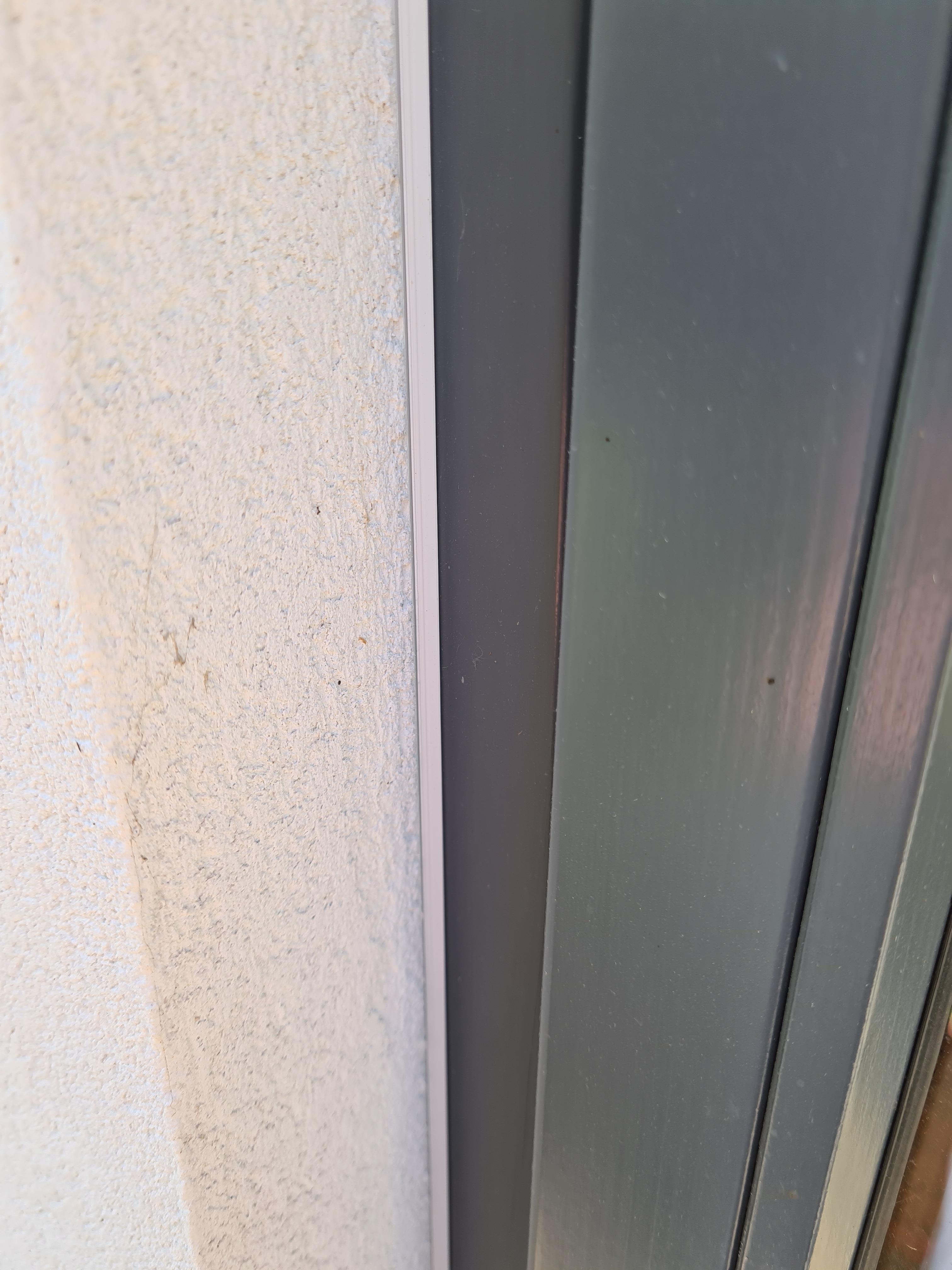

tanneja Posted July 30, 2020 Author Share Posted July 30, 2020 First EWI firm have suggested that the windows are left fixed flus on the front of the blockwork, and that the EWI (Graphite EPS) would be extended over the frame of the window 30mm around all edges. Part of me thinks could be ok as plan to be Tilt and turn windows, although its losing sight of some of the beautiful frame I plan to pay for with Internorm, and would that get complex with the cill at the bottom? Is their strategy the most viable / secure relative to bringing the windows (to some degree) into the EWI layer? Link to comment Share on other sites More sharing options...

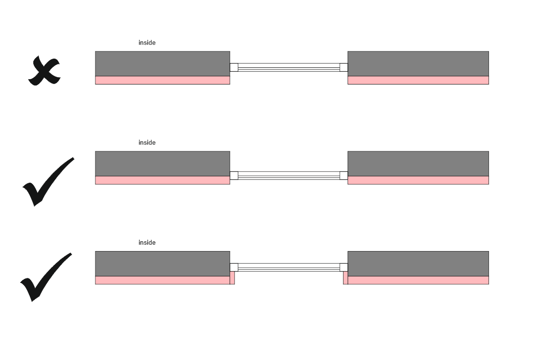

Mr Punter Posted July 30, 2020 Share Posted July 30, 2020 You need to avoid having ANY uninsulated window reveal exposed to cold outside, as the cold will track through to the inside and cause damp and mould issues. You can get around this either by moving the window outward to the frame overlaps the insulation or adding some insulation around the outside reveal - which is often not practical as it reduces the effective opening size. 1 Link to comment Share on other sites More sharing options...
Ferdinand Posted July 30, 2020 Share Posted July 30, 2020 2 hours ago, MikeGrahamT21 said: Hanging the window out into the EWI layer in its entirety. There are some posts on here about it using steel angle irons to hold the weight of the window, with brackets to support it in place, a very robust solution. You are doing a good job asking questions about all the details. Keep on keeping on. Your window supplier should be able to talk about extended sills. The last one I did I fitted extended sills to windows and thresholds to doors just in case I want to do EWI later. On 25/07/2020 at 12:19, ADLIan said: The renovation/upgrade of existing floors, walls and roofs is covered by the thermal requirements in Approved Doc L1B (assuming England) which details U-values to be achieved. Building Control do have a degree of flexibility however and exceptions are listed. This type of work however is very badly policed by BCOs, perhaps partly because they're not informed. Lack of proof of Bldg Reg compliance here may affect any future sale of house. Our local BCO take the view that they seek to encourage any improvement and have people talk to them rather than jumping on people for not doing the EXACT regs. Ferdinand 1 Link to comment Share on other sites More sharing options...
Russell griffiths Posted July 30, 2020 Share Posted July 30, 2020 When I was window shopping I mentioned to some suppliers at a show that I was going to do the third version in that drawing above. They all seamed very glad and gave me a big thumbs up as that really is the best way to mitigate cold spots. 1 Link to comment Share on other sites More sharing options...
