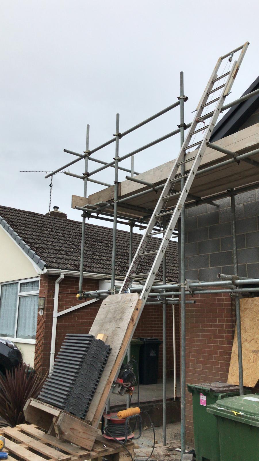

Onoff Posted July 26, 2020 Share Posted July 26, 2020 This has merit: Check out Geda ladder lifts too. Link to comment Share on other sites More sharing options...

Onoff Posted July 26, 2020 Share Posted July 26, 2020 That ladder hoist I linked to just now is dead easy. Low component count too. Decent industrial ladder bolted to the wall. Cheapo engine hoist. Some Unistrut supporting a 1m x 1m lifting deck. What's the worst that can happen? ? 1 Link to comment Share on other sites More sharing options...

JFDIY Posted July 26, 2020 Share Posted July 26, 2020 I'm a bit late to the party on this; I made a ladder hoist some years ago when tiling my roof I used a 7m ladder to get to the height I needed. A friend borrowed it recently for his own place, assembled onto a 4m ladder this time. I'd happily out 100kg on it. Wouldn't need much extra work to take more weight. Hoist was a 125kg jobbie for sub-£50 at the time. 2 1 Link to comment Share on other sites More sharing options...
Pocster Posted July 27, 2020 Author Share Posted July 27, 2020 22 hours ago, joe90 said: I like that, simple, flexible but not sure I would want to put a washing machine on it ? (didn’t @pocster say that was one of his items?). Yes. Think also big american fridge freezer. So it's not just about getting materials up/down otherwise I would just use a simple winch and gantry. I reckon - I can build something than I can dismantle and then ( as others have said and indeed I have already thought of ) with the freezer etc. breaks down and needs to be replaced I have a easy setup lift to utilise. Waining on @Onoff 's contact to get back to me. 1 Link to comment Share on other sites More sharing options...
