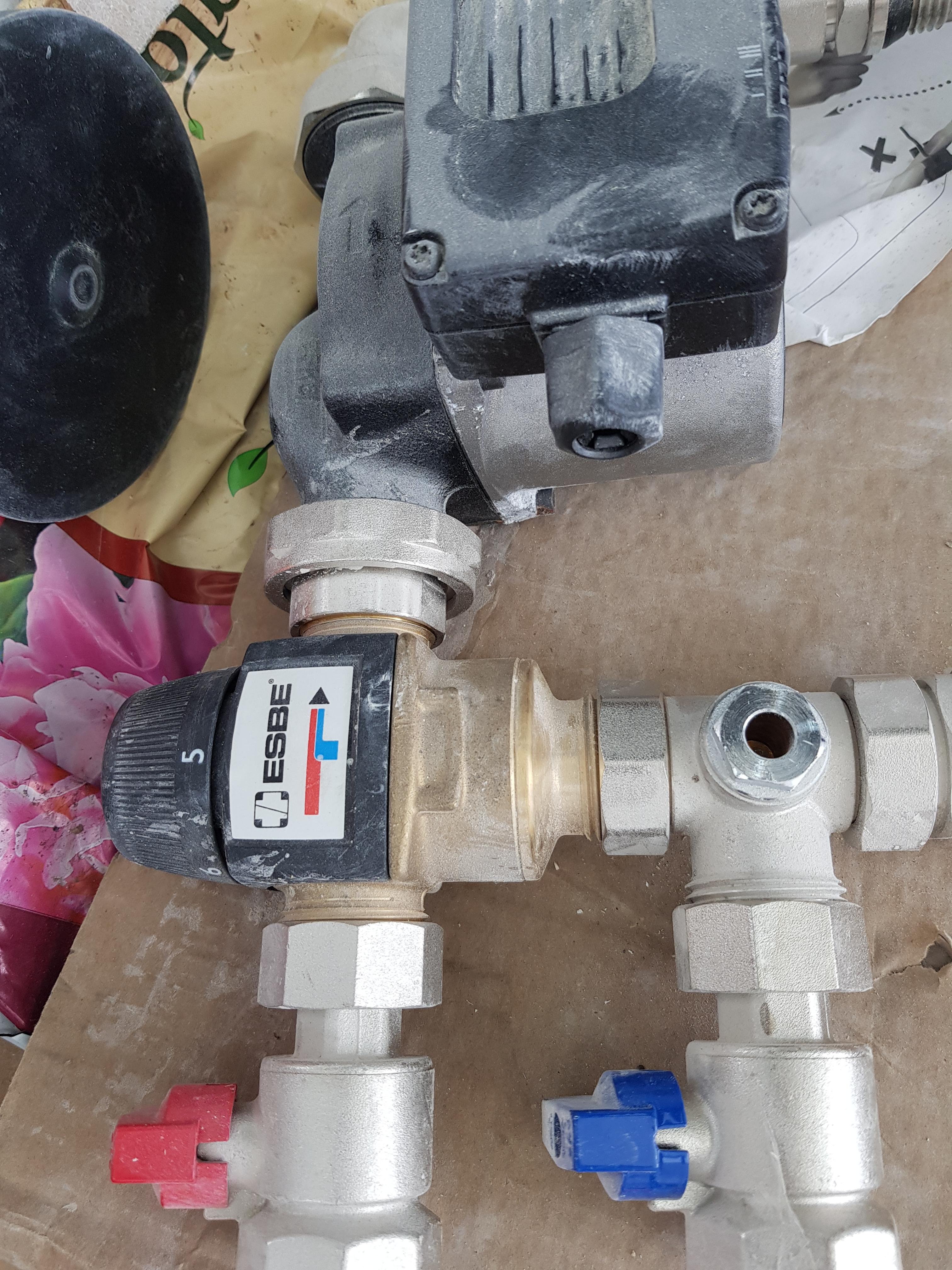

Pete Posted October 6, 2020 Author Posted October 6, 2020 On 21/07/2020 at 10:27, PeterW said: Lets start at 9KW ASHP and a 400 litre UVC HP spec from Telford, 75 litre buffer tank and also get the blending set for the manifold (just hope it set up to allow the pipe centres to line up...) Personally, I don't like the pre-plumbed cylinders as they are expensive for what they are. There are circa £250 of bits on the tank and they add over £600 to fit them onto the tank. They assume too that it is wired as S-Plan, which may not be ideal in all instances. With a heat pump setup you are better off using a diverter valve rather than zone valves as there is always an open circuit so you don't get over pressure issues with closed valves. Heat load for the heating will be low, hence the need for the buffer tank as the ASHP will short cycle otherwise. Expand With regards to the buffer tank and preventing short cycling, my UFH pipes are 5 zones but no zone valves so really one large zone. The house is mainly all ground floor so there is a large amount of water already in the pipes (house area 8m x 25m for the pipe area on 200mm centres, PH) so I would think I would be ok to omit the buffer tank as others have stated they have not fitted a buffer tank and their system works ok? TIA
PeterW Posted October 6, 2020 Posted October 6, 2020 Zone valves aren’t your problem - it’s the mixer valve. As the water warms in the pipes it needs less “hot” water from the ASHP so the blending valve starts to close. Without either a low loss header or a buffer, the blending valve will restrict the flow, potentially causing you flow issues on the ASHP. 1
Pete Posted October 6, 2020 Author Posted October 6, 2020 On 06/10/2020 at 12:46, PeterW said: Zone valves aren’t your problem - it’s the mixer valve. As the water warms in the pipes it needs less “hot” water from the ASHP so the blending valve starts to close. Without either a low loss header or a buffer, the blending valve will restrict the flow, potentially causing you flow issues on the ASHP. Expand Just dug my UFH box out and I think I may have a mixing/blending valve after all? The temp range on it is 30 to 70, will this be ok for my PH build? TIA
