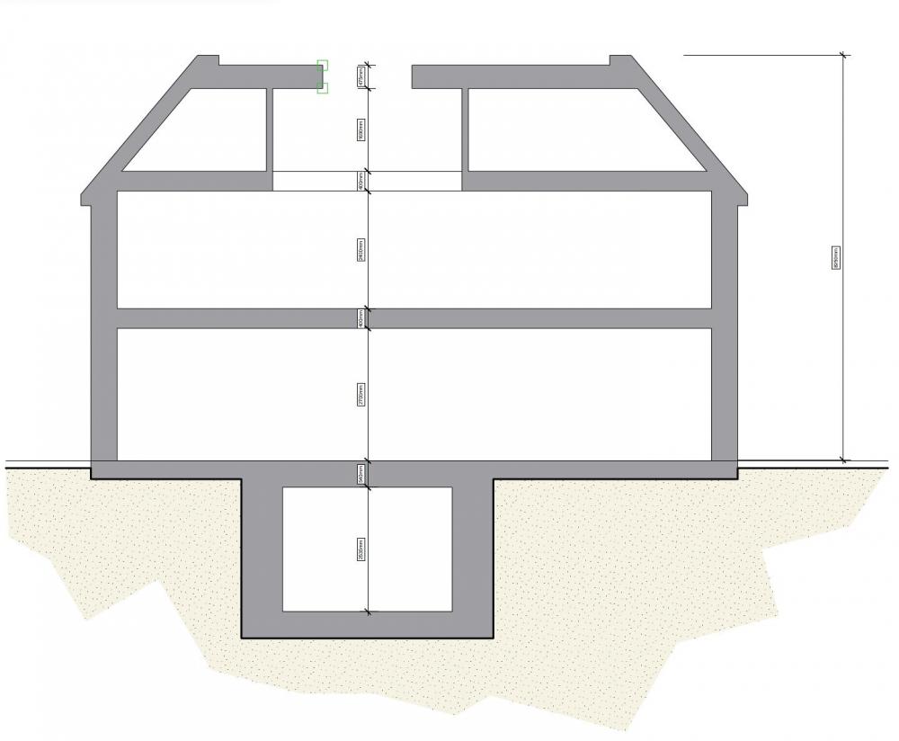

My architect feels the maximum height of our upcoming house (given the roofline of neighbouring are 8060 and 7940mm ridge height respectively) can be 8250mm from Damp Proof Course(DPC), which is already pushing it. We are hoping for a "convertible" loft. My architect designed 1800mm for loft head height (flat, see pic) which of course is 'meh' but he also recommends not hitting the required (?) 2200mm just to get through planning and not effectively proposing a 3-floor house rather than 2:
My questions:
1/ Do you agree that it's better to stick to 2 floors, and then later do a non-material amendment, to "rejigger the internal sandwich to hit 2200 loft"? Risky?
2/ With 8250mm, how to get a proper (2200mm) loft head height yet retain a high ceiling ground floor and good structure width for high U-value insulation
Is the below feasible: (numbers are "starts at")
8250 Roofline
7850 Roof Structure (350mm)
5700 Loft Space (2200mm)
5350 Floor 2 Ceiling (350mm)
3000 Floor 2 Space (2350mm)
2650 Floor 1(G) Ceiling (350mm)
0 Floor 1(G) Space (2650mm)
0 DPC / Floor
-350 Basement Ceiling
-2800 Basement Space
-3200 Basement Foundation
As you can see I just managed 2650mm ground, 2350 first, and 2200mm loft. Works? Or is 350mm too optimistic or missing important house layers?
What we would submit to planning would be something like:
8250 Roofline
7900 Roof Structure (350mm)
6100 Loft Space (1800mm)
5750 Floor 2 Ceiling (350mm)
3050 Floor 2 Space (2700mm)
2700 Floor 1(G) Ceiling (350mm)
0 Floor 1(G) Space (2700mm)
0 DPC / Floor

With a 220 joist you can have 300 floor zones.  Depends on spans and structure.
So with 300 floor width, I could cut down the house by 100mm

If you're right about 300 floor, then I would have 100 spare - is 450 sufficient?
It is down to the design.  All the best practice says warm roof, everything above the rafters.  The reality is there is often a height restriction so it is insulation between joists / rafters and a bit underneath, but this detail is only suggested for conversion of existing roofs.
450 should be OK.
Don't forget you also need a 1:50 fall which can add a little.

You can get to 265mm floor heights at a push, but you need max 4.8m spans on the joists. No issue with them running opposite directions though.
Angle of the roof will affect its relative depth - from DPC you could get 2650 / 280 / 2250 / 280 / 2250 / 540 which allows for a 350mm warm roof build up but would need to be PIR. The issue you would have is the way those windows are drawn, you would need to have skeilings in the first floor rooms and that would need very strong attic trusses as the tails would be holding the weight of the attic room.

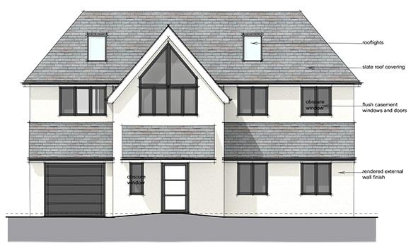

Not sure why your ‘architect’ has specified a floor to ceiling height of 1.8m for a future convertible loft as that wouldn’t even meet the headroom requirement for the new stair.
No, their point was to not specify a convertible loft because they worry that we're too optimistic with PP, trying to "get away" with too much, and if we put in for what is basically a 3-floor house, we will get rejected. Happy to hear opposing opinions, but the 2-floor version of our house is already larger than the neighbours.
Instead, they are specifying a "very roomy" (2700 ground, 2700 first, 1800 loft) house where after PP, we could theoretically compromise into 2650 + 2350 + 2200 by my math.
Of course one question is when to do that rearrangement, and do I need to tell my council or can I just reshuffle the internals to my liking without any hassle?
