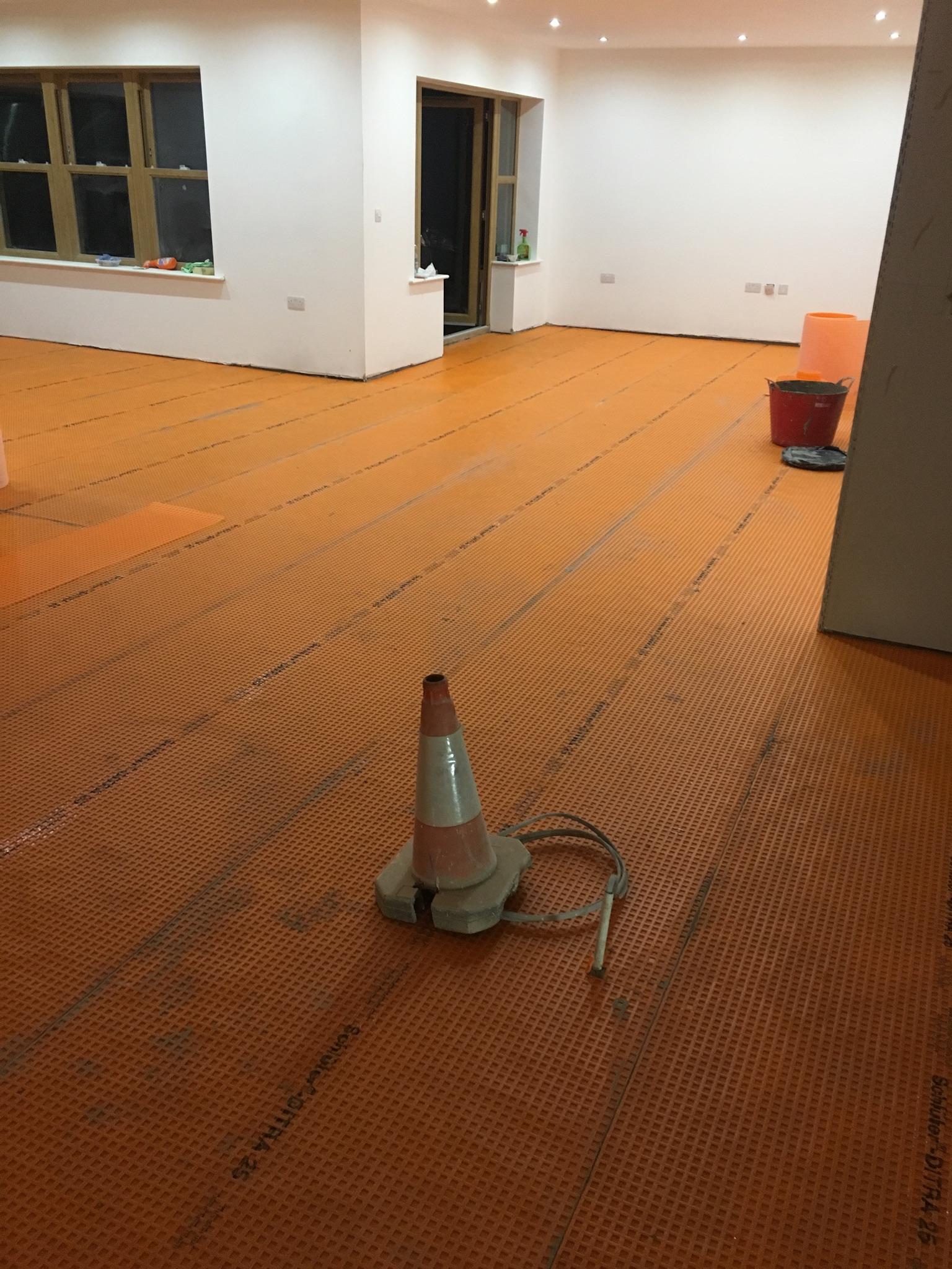

nod Posted July 14, 2020 Posted July 14, 2020 10 minutes ago, dpmiller said: Been wondering about this myself, it seems counter-intuitive to me to have a thin layer flexibly isolated from the base. I’ve tile onto screed that not properly dried UFH with mat and got away with it We had two jobs where the tiles lifted without matting onto UFH Both cost over 10 k to put right As a contractor it’s not worth the risk It’s a big job to put right once all the kitchen and furniture is in The matting is belts and braces
nod Posted July 14, 2020 Posted July 14, 2020 6 minutes ago, Russell griffiths said: Isn’t that the whole idea, to isolate the tiles from the base, if your screed grows and shrinks with the underfloor heating but your tiles don’t grow to the same amount then they need de-coupling from each other. @nod what is the standard spec now in commercial builds, matting or no matting. Your spot on Russ Always matting where there is any likely to be any kind of movement It’s already in the spec before we quote Make no mistake If a tiled floor lifts the whole lot has to come up
joe90 Posted July 14, 2020 Posted July 14, 2020 56 minutes ago, nod said: What do I know I’ve only been running a tiling business for 30 years ? sorry mate, I am not a tiler and only did what was recommended here by another “professional”, just relating what I did. So, can you explain how to use matting, is it stuck to the floor?, how does it work? I would love to understand how it works.
Pete Posted July 14, 2020 Posted July 14, 2020 3 minutes ago, joe90 said: sorry mate, I am not a tiler and only did what was recommended here by another “professional”, just relating what I did. So, can you explain how to use matting, is it stuck to the floor?, how does it work? I would love to understand how it works. I used the schluter matting which has a fleece backing. You put down a sloppy tile adhesive mix on a 4mm bed and lay matting down onto this. The top is like Lego so when you spread tile adhesive it is squashed down and creates a surface for the adhesive to bind to. The overall effect is if there is any movement underneath the matting it does not transfer through to the tiles. My neighbour has just used the latest matting that is not even glued down, it just floats made by Bal. The beauty of this is if you need to repair a tile or even tile over say some lovely Victorian hallway you can do without damaging the tiles/surface underneath or just cut the damaged tile out and replace. This product is dearer than my Schluter product but a lot quicker and you do not need to buy adhesive to fix it. YouTube Is good for a visual representation here

Ian Posted July 15, 2020 Posted July 15, 2020 (edited) @Ann I’m an architect with 35 years experience. When it came to building our own house which had approx 65sq.m of ceramic floor tiles with UFH I specified the Schluter Ditra matting mentioned by @nod @Russell griffiths and @Pete We always specify it on our commercial projects and in my opinion it’s not worth the risk of not using it. Edited July 15, 2020 by Ian 2
Pete Posted July 15, 2020 Posted July 15, 2020 23 minutes ago, Ann said: It seems that the way to go is to tile first and then install the kitchen. Thanks for the advice. Interesting to read the posts about the decoupling membrane. I have two quotes for the tiling using flexible adhesive and grout. Only one of the quotes includes an option for Schluter Ditra matting, which adds 50% to the cost! It is very easy to do yourself but the problem is will the tiler accept your workmanship and secondly if there is a problem then you cab bet it would be your fault for not putting the mat down correctly. You just mix tile adhesive a bit runny, like a slurry and lay the mat out and press it down into the slurry. The tile adhesive is not doing anything other than adhering the mat to the slab/screed
nod Posted July 15, 2020 Posted July 15, 2020 15 minutes ago, Ian said: @Ann I’m an architect with 35 years experience. When it came to building our own house which had approx 65sq.m of ceramic floor tiles with UFH I specified the Schluter Ditra matting mentioned by @nod @Russell griffiths and @Pete We always specify it on our commercial projects and in my opinion it’s not worth the risk of not using it. Exactly it really isn’t worth the risk Two Christmases ago we tiled a 200 m2 floor for a Barrister On a screed that had been down a matter of weeks With a bio boiler that was commissioned the day we finished Tiling the floor I pointed out that he would be mad to take a chance on a green screed He just said they needed to be in for. Christmas and would take full responsibly We used Ditra and got away with it As above All commercial have matting on most floors regardless of UFH It really is marvelous stuff cost £4m2 Ditra Adhesive (flex) £1m2 Labour £3.50 m2 My wife laid the 80 m2 in the kitchen area while I was Fitting one of the bathrooms Rollered to an inch of its life 2
